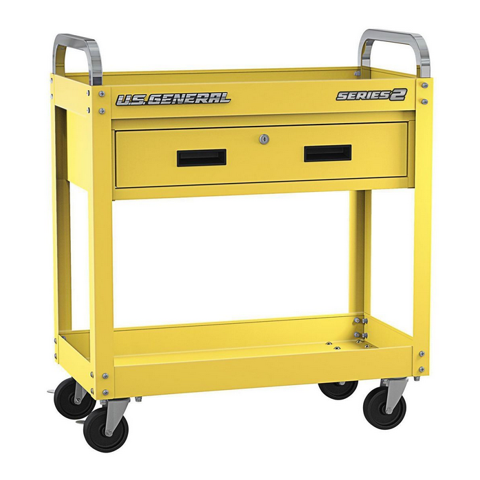

I'm thinking about using this cart. Has 4" wheels and taller plus one large drawer. Would need to add a tank holder and cable hooks. Leave one handle off or try rotating it so its horizontal.. At HR for $140
/ welding carts #27
Could definitely work. I'd personally opt for full drawers, no shelf, but different people have differing needs. I like that two of the casters lock. Would probably swap two of the swivels (whichever side bottle goes on) to fixed, so it steers more easily, and place the new fixed casters aft of the bottle for better stability. Also, fixed casters will have larger wheels for same mounting height, which is better for moving around a shop with any debris on the floor.

I'd put my welder on the bottom of that yellow cart. I want the weight down low, and I want my tools up on top where I can reach them.

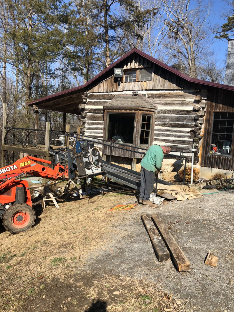

/ welding carts #30
Stainless steel tool cabinet attached to custom base has places to keep all wire, consumables stored and clean. Mig welder and plasma cutter bolted to top.
Base has two bottle rack, 6” locking casters, fork pockets. SS dog food bowls repurposed to wrap cables around. Torch holders and clamps built in.
That's a very nice looking porch railing you have going there! (y) (y)
I have used carts just like the one pictured. It would make a lousy welding cart. The screws will loosen over time and will need constant re-tightening. The cart itself is not very stiff so it will be wobbly as it flexes during use. With the welder on top the setup would be dangerously top heavy. With the welder below the welder will be hard to access. A mig welder in the bottom would also suffer the problem of not being able to open the welder to change wire spools. It is nice when the welder is tilted up some if it is not mounted fairly high. Tilting it up helps to see and access the controls. So you would need to tilt the welder up somehow. The casters are too small except for smooth floors. Just my 2 cents.

I was to the store and liked its looks. The 30lb welder will be on its top and I certainly can have it angled like most mig carts have them. Its also wider than many migs carts and I liked the thought it will hold the welder higher off the ground. I checked Surplus center for caster pricing and they are cheap for 4 or 5" ones. Yes it needs to have the rear ones rigid in direction.
/ welding carts #33
If you locktite the threads when you assemble the cart, the screws may hold better. But it seems like a lot to pay for a cart if you have to turn around and buy casters, too. The kind of casters that are good in a shop with a concrete floor might not be that great if you have to roll it outside in a gravel driveway.
