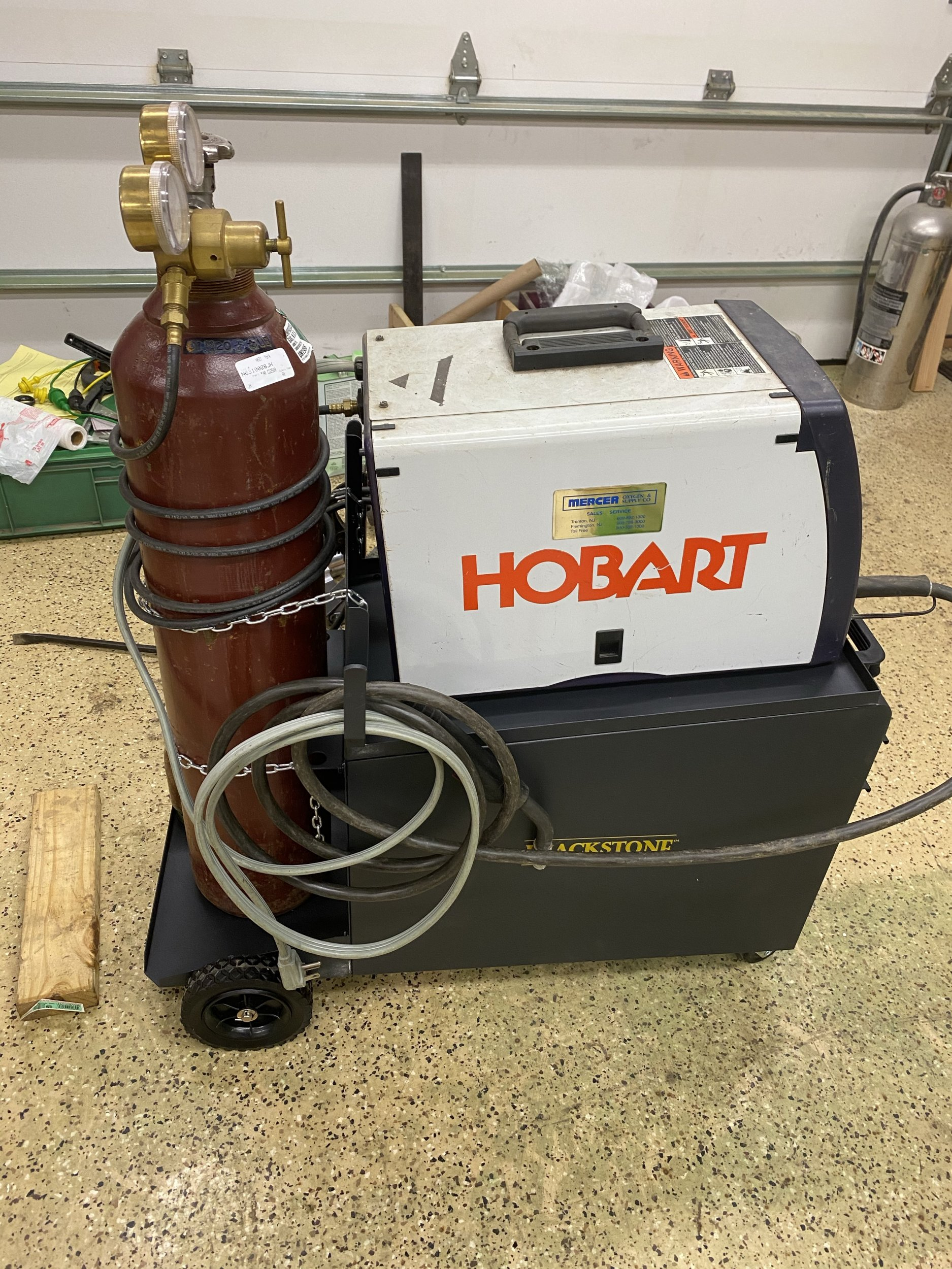

Both of my bottles are "D" size, 7" diameter x 43" tall x 125 cubic feet of gas each bottle.
I use 75% Argon/25% Carbon Dioxide for MIG and 100% Argon for TIG.
My gas supplier is 60 miles away and always has this size in stock for a quick exchange for a full bottle.
They seem to fit good for the cheap HF welding carts.

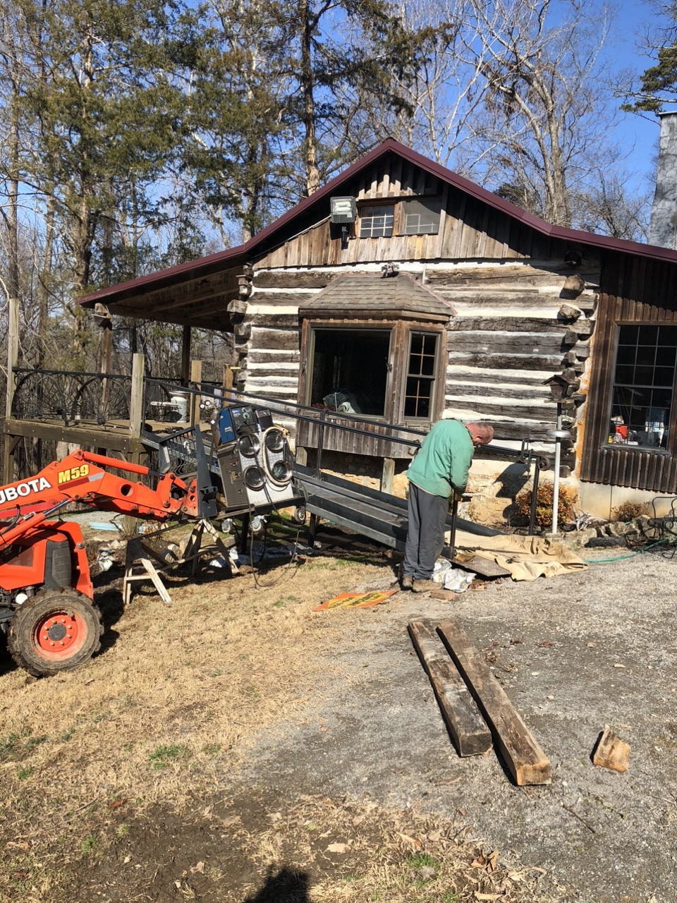

"I don't own a tractor."
I own three tractors, but I added the lift eye so I could lift the welder (with a crane) and drive a pickup or trailer under it. If your comment refers to bigger bottles, I use a hand truck to move those.
If you're in a hurry to get using the new welder, by all means you should find a bolt-together solution (at least for short term) - if you later decide you wanna build a cart, by then you'll have a longer list of "wanna's" that'll work for YOU - the mm211 I have isn't my first welder, it's the LAST one I bought. Started with acetylene in about 1970, then 250 amp ac/dc stick in '76, transformer mm211 in '08, sold that when I found a nearly new MM252 in 2010 for half price, Hypertherm plasma in 2012, then the newer inverter version of the mm211 (wanted a more portable mig)
I still have everything I listed, EXCEPT the transformer MM211.
By the time I got the newer mm211, my "bucket list" of things to do had reached the above list :rolleyes: Works for me, if ANY of my "brain farts" help somebody that's what we're here for... Steve
