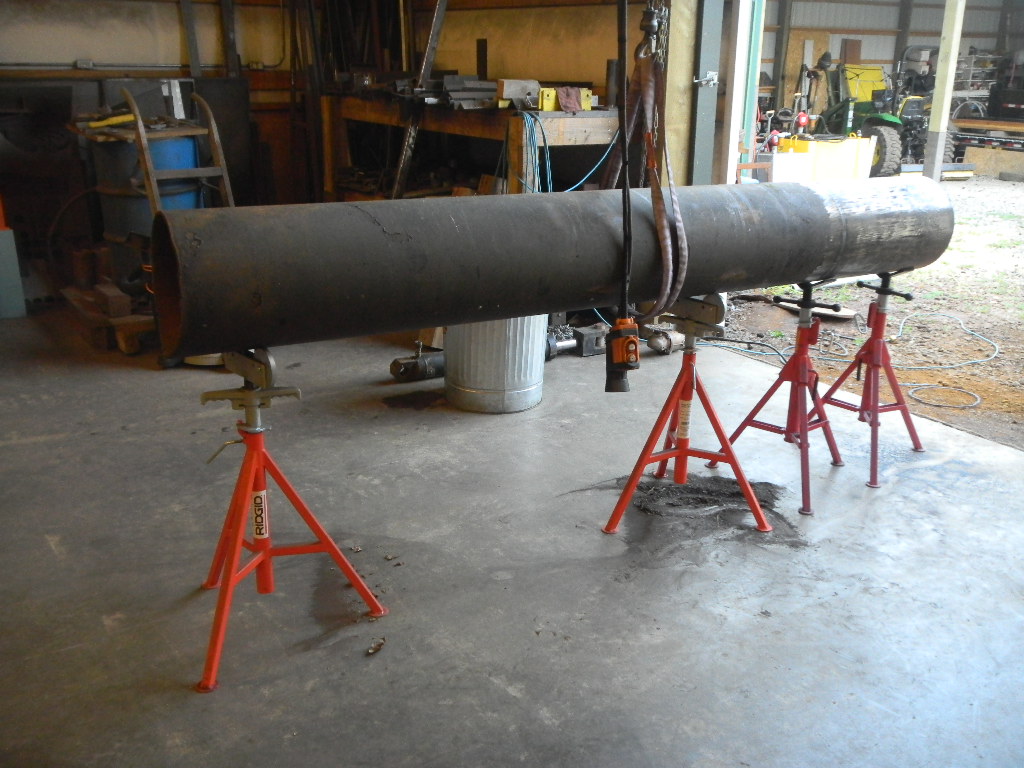

When I built that log splitter for my brother-n-law, I also built him a counterweight something like you have planned. I took a piece of 16-inch diameter fender pile that came out of the local Navy shipyard. Welded the ears on it. I had planed for him to stand it up on one end on some visqueen and fill it with concrete. I understand he hasn't done that yet.:rolleyes:
Mike for what you have planned I wouldn't think twice about doing it. :thumbsup:
