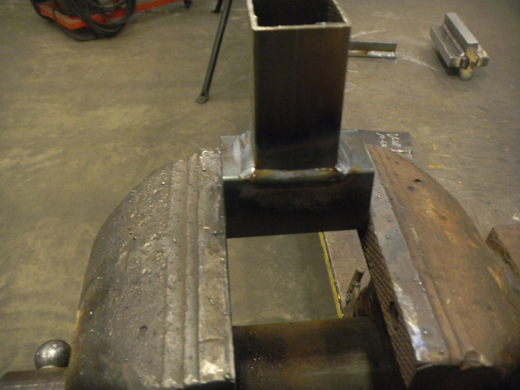

Here is a Mig weld I did with dragoneggs welder on 1/16" thick square tube.
Looks like 12ga 1 1/2" tube. Nice weld. I can make one just as pretty (after I clean off the slag) with my old 230A stick machine. In fact I made a 30'x7' rolling driveway gate for a guy in Mesquite out of that same steel last summer.
Yep I made a couple tables for my wife's greenhouse using that for a frame and 5/4 eased edge cedar decking for the top. Haven't yet got welds spread like jiffy peanut butter on that gauge as SA did on his first try... Dang it.
