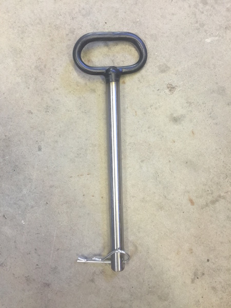

Don't know how this is relevant and not trying to hijack... but this I am sure doesn't deserve its own thread. That said, I just finished making a couple of 8in long QA pins for a project I am working on. I had to make my own because I couldn't find anything long enough off the shelf and I needed a close fit. I used drill rod for the pin and bent some simple 1/4in rod for the loop handle and coated with plastic dip. I think they came out pretty well MIGing it. Curious if anyone knows the material for 'drill rod'?

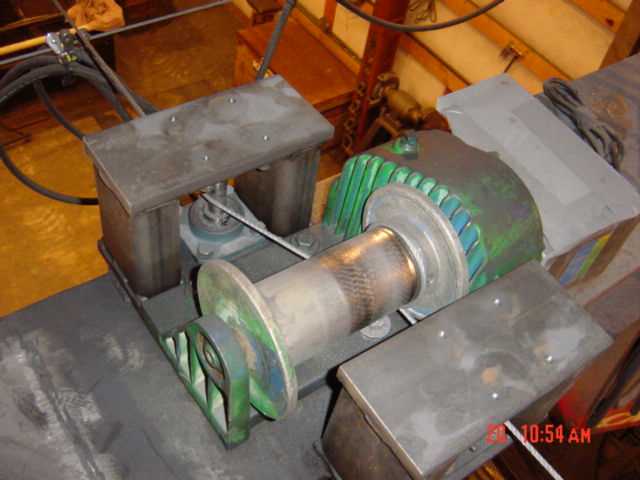

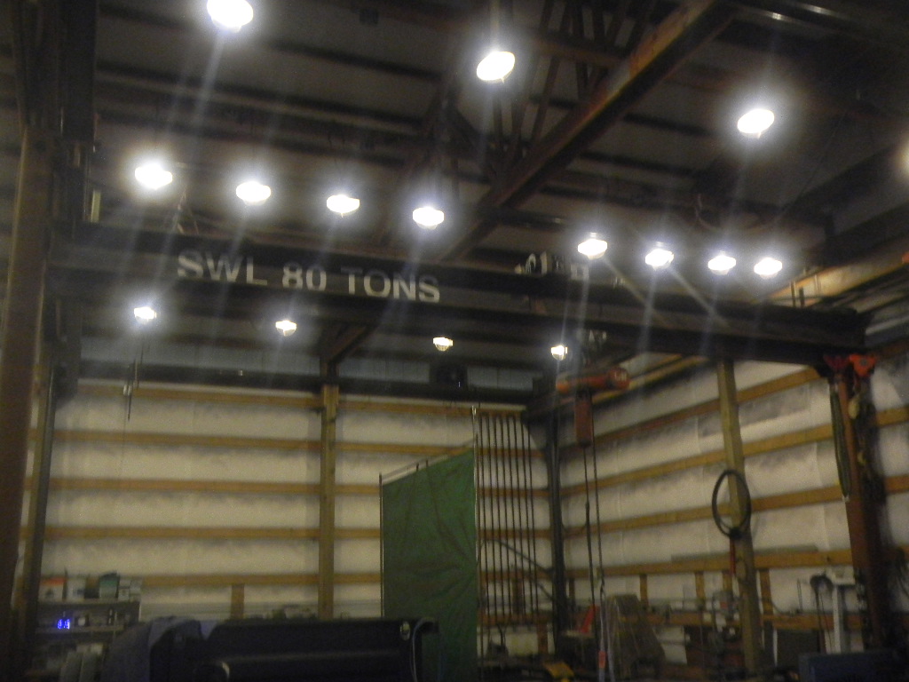

Drill rod is harder than the hubs of he!!. Even harder if you heat treat it.
I used drill rod in the fair leads for the power travel on my bridge crane. They have been in use for 12-years with 3/8" wire rope running on them. And they were not heat treated. ;)
