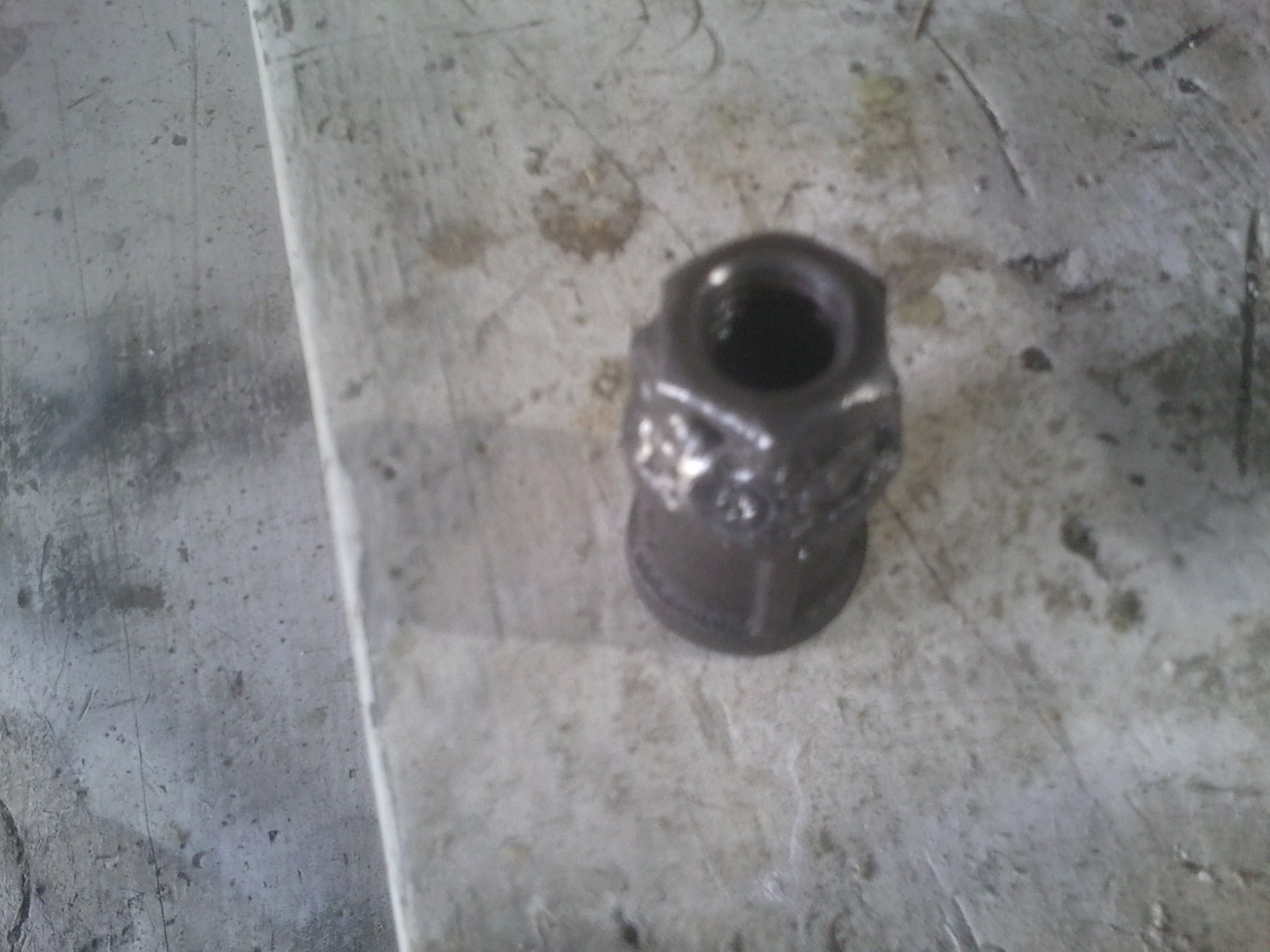

Stick weld:
#5 (used) nut to cast iron gas pipe connector (all I could scrounge)
AHP in stick DC mode
68 seconds

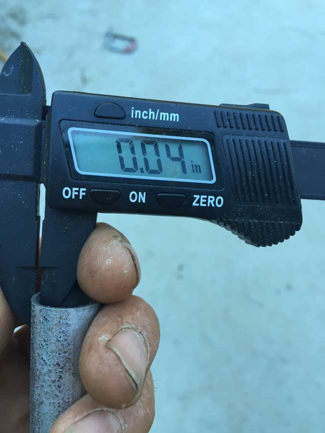

Heres another using EMT (1/2" conduit), and the 3/8-16 nut.
MIG setting still the same, 14ga (which is .10" thick) &.030 wire. This works pretty good.
428903d1433826243-welding-small-part-weld789-jpg
EMT is less than 1/16" thick
428902d1433826243-welding-small-part-half_emt-jpg
