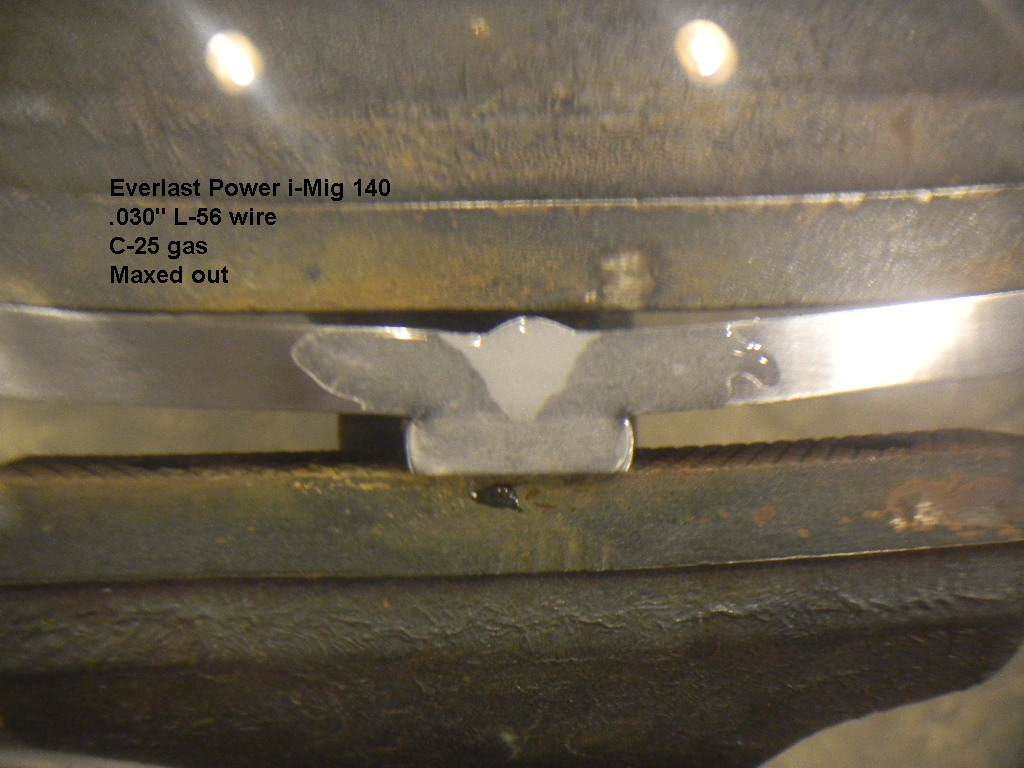

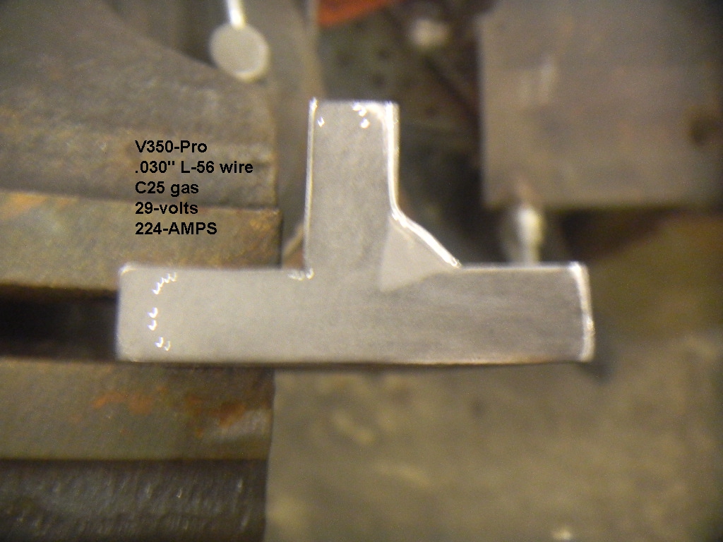

I've said it before, and I'll say it again! When it comes to Mig welding there is no substitute for power.
Here you guys be the judge.
