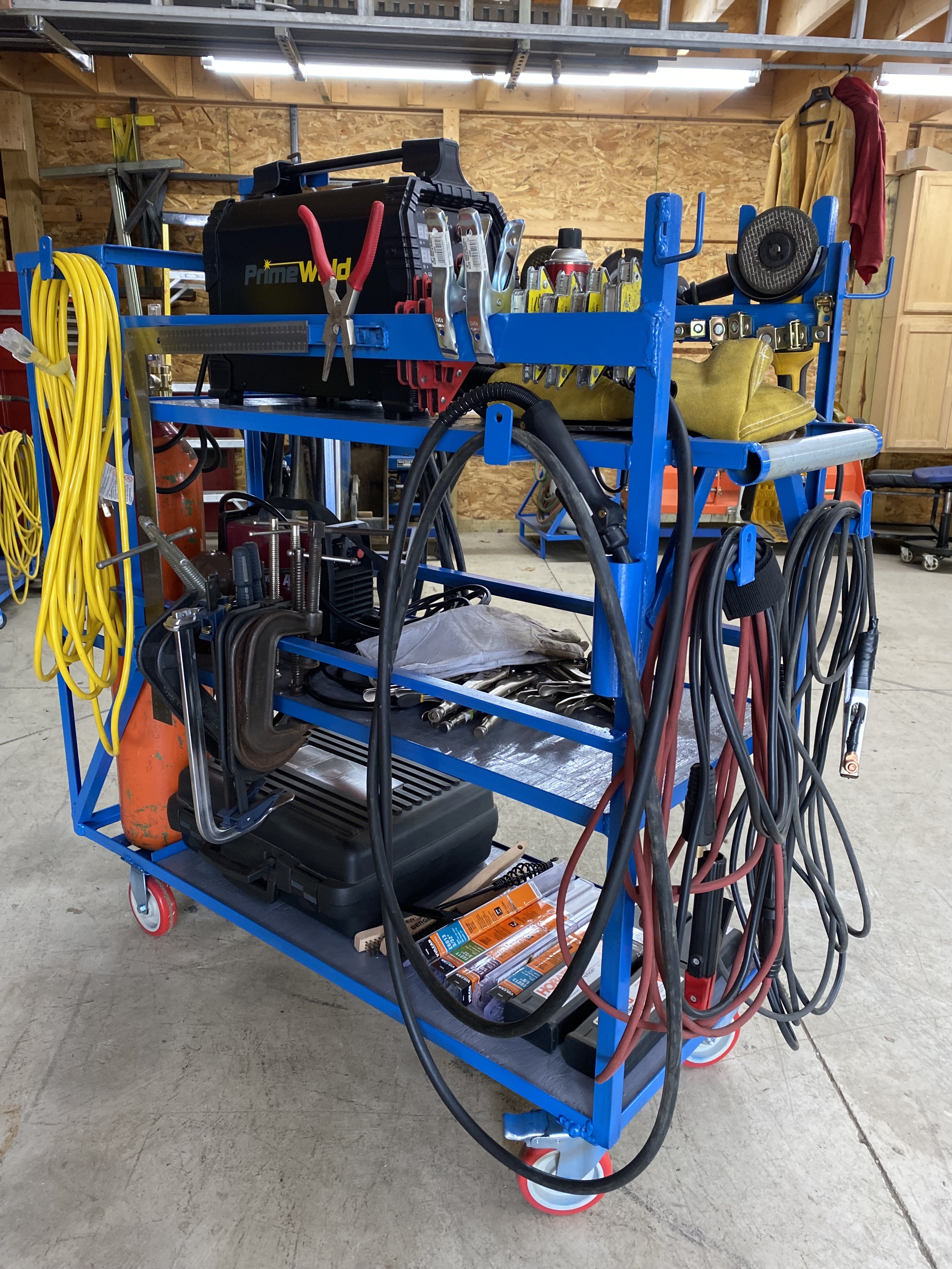

Anyone have a PrimeWeld welder, esp the PrimeWeld 180? How do you like it and how long have you had it?
I have a PrimeWeld MIG 180 and its the best welder I’ve had. Comes with a no B.S. warranty for three years. This machine will make you look like a pro welder. Primeweld is in New Jersey with a full staff. When you call they answer and help you right away. Best $550 bucks I’ve ever spent. I went the 15 foot Lead and not sorry I did.

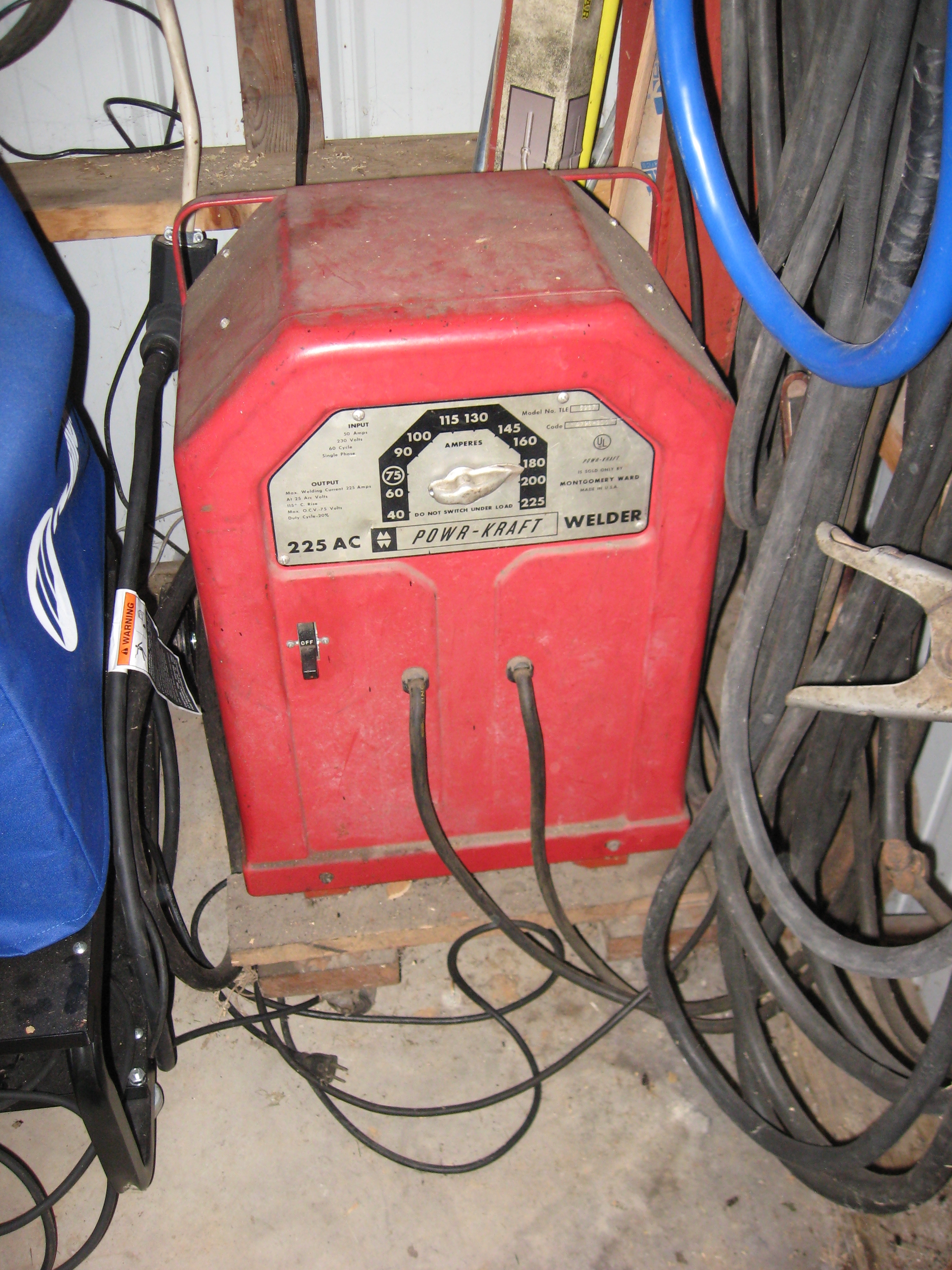

My buzz box is the Monkey Wards version.View attachment 3631750
Built by Lincoln Electric and rebadged Monkey Wards....:D There is absolutely nothing to fail insude of them other than the contactors getting dirty and that is an easy fix as well. Little sandpaper to remove the oxidadtion on the contacts and that is it. Even my ac/dc is stone simple, just another set of contacts on a physical switch.
Compared to a modern solid state IGBT machine, it's a reliable rock. Being a transformer machine however, they are power hungry.
The old Monkey Wards 225 served in my Dad's shop from the mid 60's to 1991 when he passed, and has been working for me ever since.

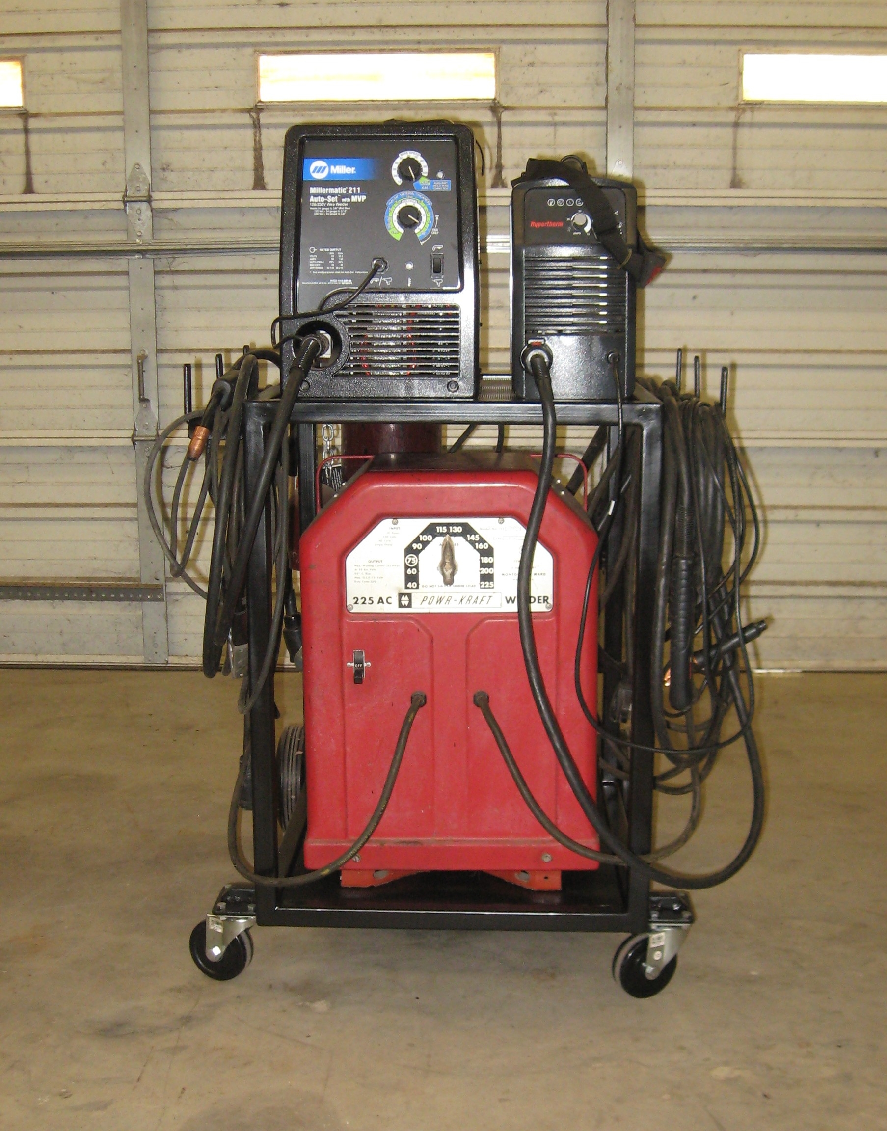

I wouldn't recommend a heavy tombstone welder when the inverter ones are so much lighter to store and to move around. My Lincoln tombstone is sitting on a wheeled cart just to be able to move it.
