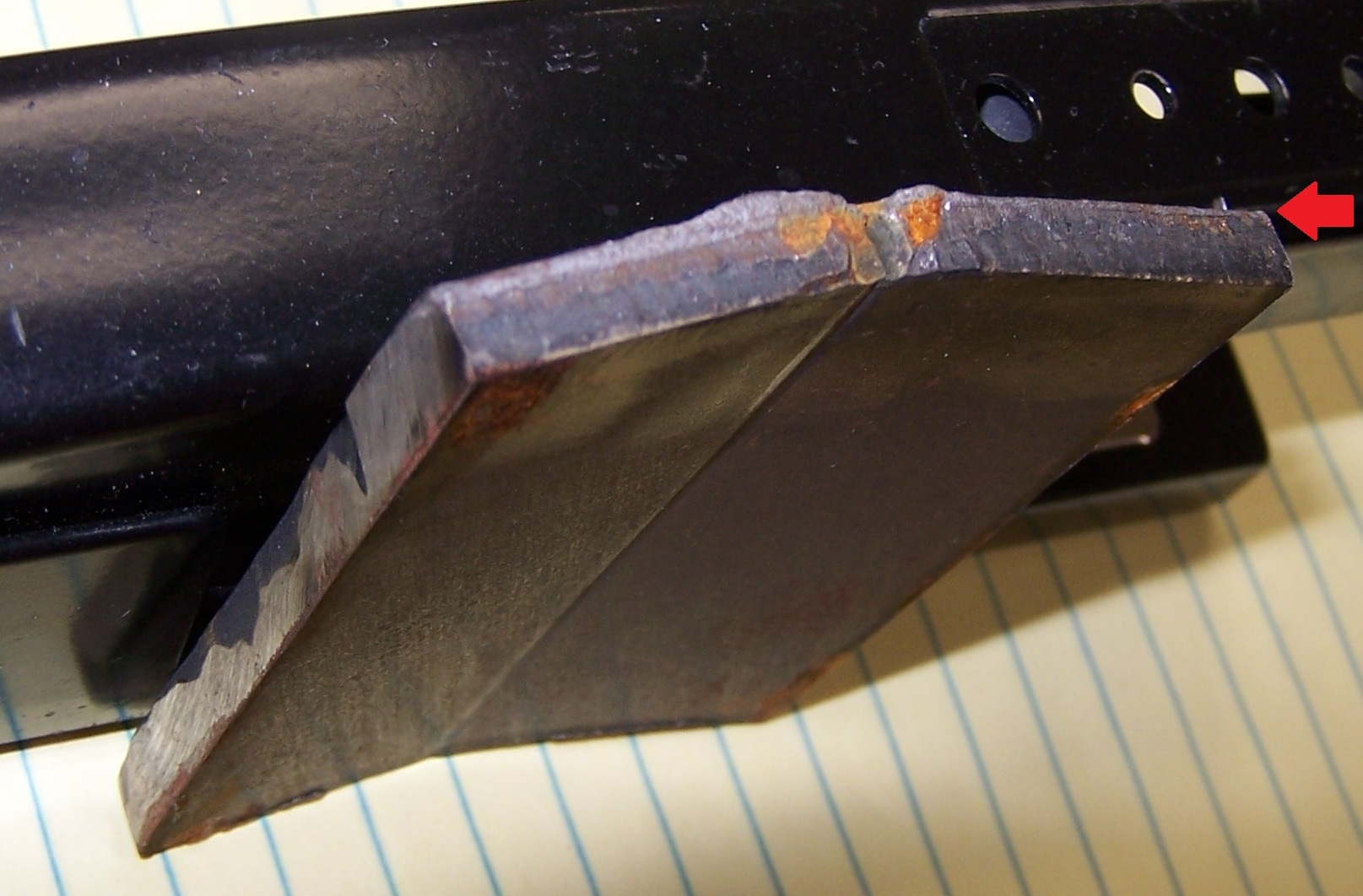

A weld is a weld and that the jack got loaded the wrong way is irrelevant. Not sure why you keep excusing the poor workmanship. That Mig weld had a lack of fusion which is seen time and time again with Mig. Here is a picture of a section of a pressure vessel that failed. The entire v notch was filled with weld, but as you can see there is only a paper thin amount of fusion (red arrow) on the outside edge, which is what one would see inspecting the weld from the outside. The vessel passed the pressure check only to fail in the field from pressure spikes it would have easily handled if the weld was good.
Bottom line is Mig makes it easy to make a decent looking weld that isn't worth a $hit. Rookie welders need to get good at Mig before doing structural projects where life and limb are at risk. Welding is fun and rewarding. Like anything, know your limitations and use sound judgment when considering the failure modes of what you are working on.

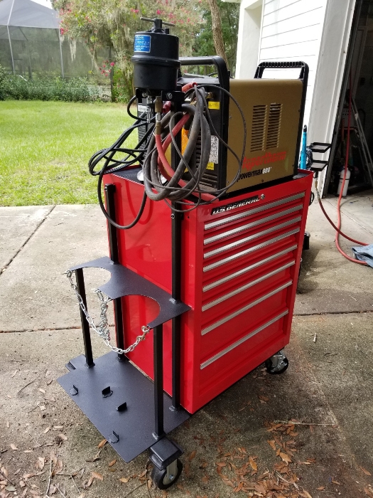

Some advice about carts: don't buy one. They're all pretty bad compared to what you can make for yourself. I took US General tool carts and made rolling frames for them. Most carts are cheap and flimsy, and they put all your stuff out there in the open, in the way, with the grinding dust. A tool cart will keep everything clean and handy. I put something like $325 into each of my carts, and they're way better than anything I can buy. These days, call it $425.
I used the existing bolt holes in the carts, so they aren't modified at all. The frames screw right on.
The Lincoln and Miller carts I've seen are especially pathetic, and the prices are silly.

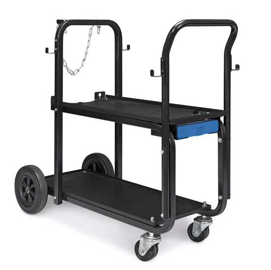

Here is a great example of a stupid, overpriced welding cart you should not buy. This is a Miller, and I found it online for $360+. I had something very similar from Vulcan, and it was very sturdy, but it was also stupid. I paid $100 and sold it for $50 just to make it go away.
Note how everything is out in the open. Note the tiny hooks for holding cables. Those hooks don't really work. Cables are stiff, and they don't like to coil nicely. If you use hooks like that, your cables will stick out and get in your way. Whatever you put on this cart will end up covered in abrasive grit and metal dust, and you will have no place at all for things like clamps, consumables, and pliers. And where do you put your tanks? Add in the obscene cost, and it's a recipe for regret.

Have to disagree about the Vulcan cart, I have one I use for my XMT 304 with a 24a feeder. My only complaint is the tank holder is too small for my 300cuft tank, but that's a pretty easy mod.
The hangers for the cables are decent, no problem wrapping the 15ft 400a gun up.
I bought it open box so was on $85, I was going to build one, but it was another project on the long list I already have.
Now I am going to one day finish my cart for the TIG, that one is already started (started it only about 8yrs ago!)

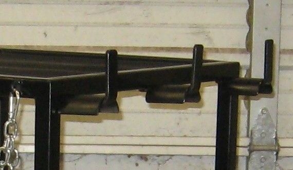

I like to cut a piece of pipe in half and weld to the top side of my cable hangers to make a little smoother surface for them to hang on.
Have seen people use all kinds of things for this purpose, such as small wheels cut in half, garden hose racks, etc.

Interesting and false comment about the Vulcan wheeled welder cabinet. Not the cheap Chinese one in your picture either. I have 2 actually, they both carry 3 120 cubic foot bottles and numerois machines and are very well built. One has my Pro-Tig on it plus an everlast water cooler and one plasma cutter, the other has a pair of Hobart MIGS in it and a second plasma cutter. Drawers all lock, operate smoothly and have plenty of room inside even enough room for 2 hoods. I really don't believe you know what you are talking about as the Vulcan cabs are top shelf. My employees are very happy with them as well.
