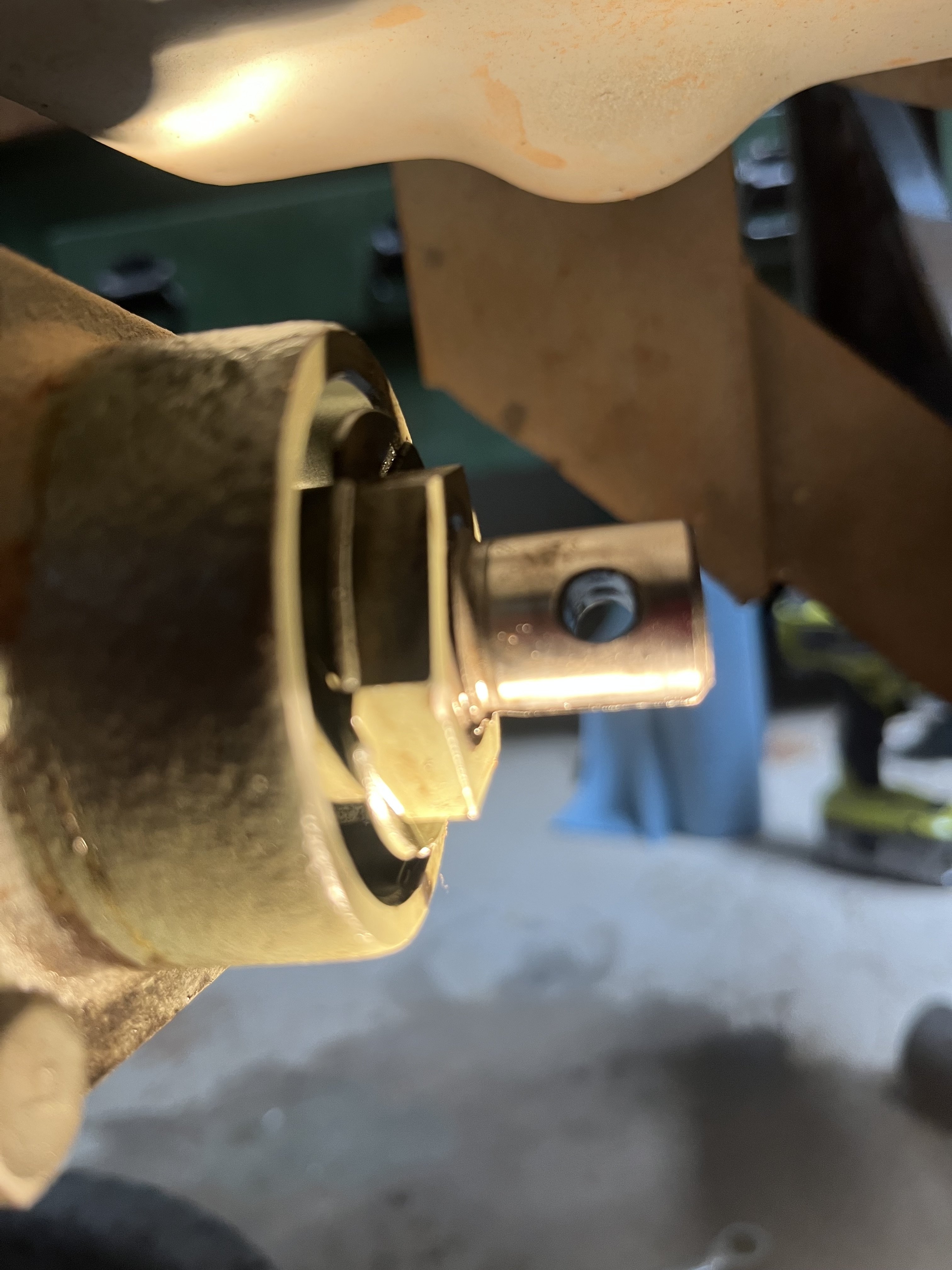

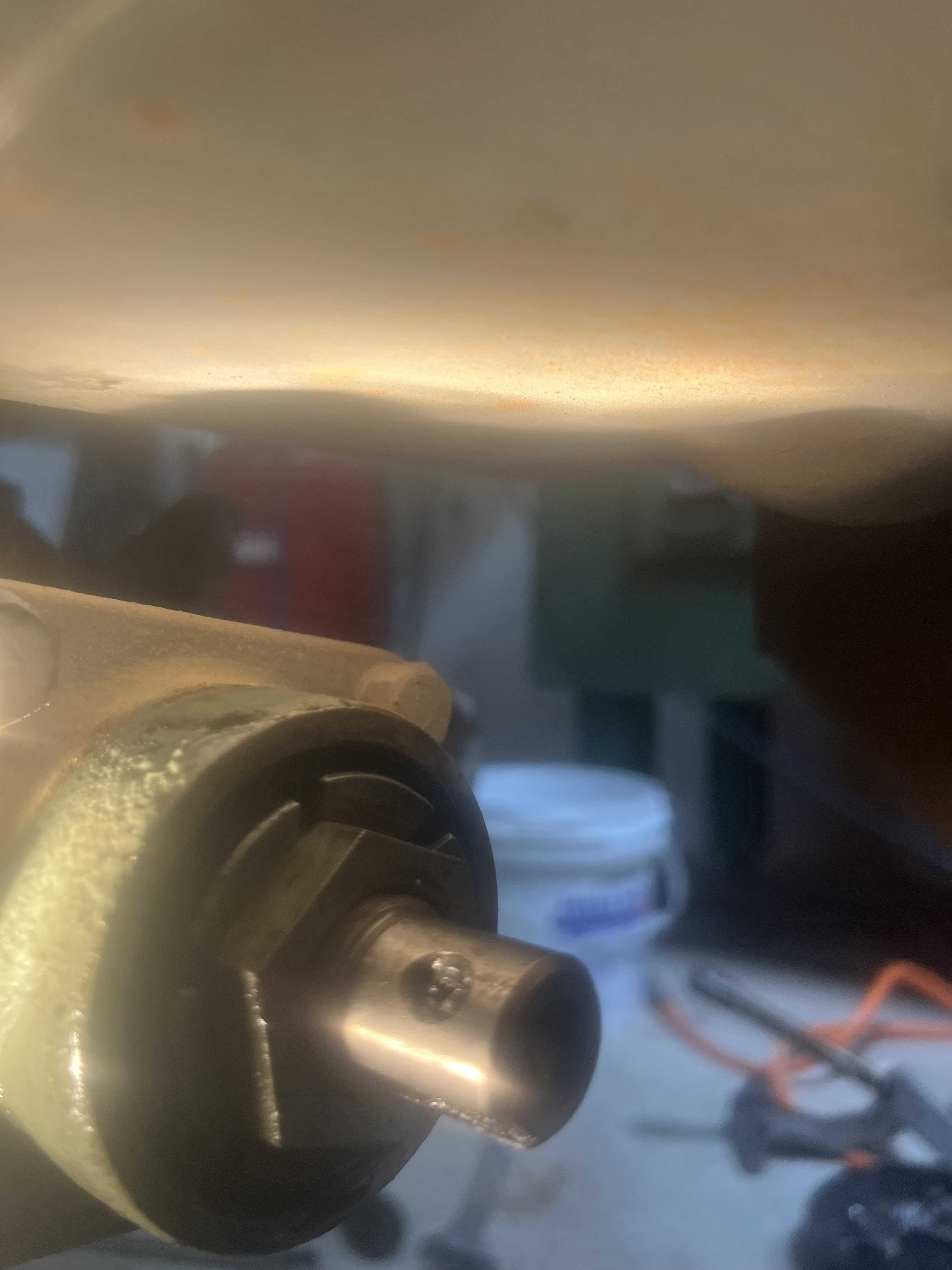

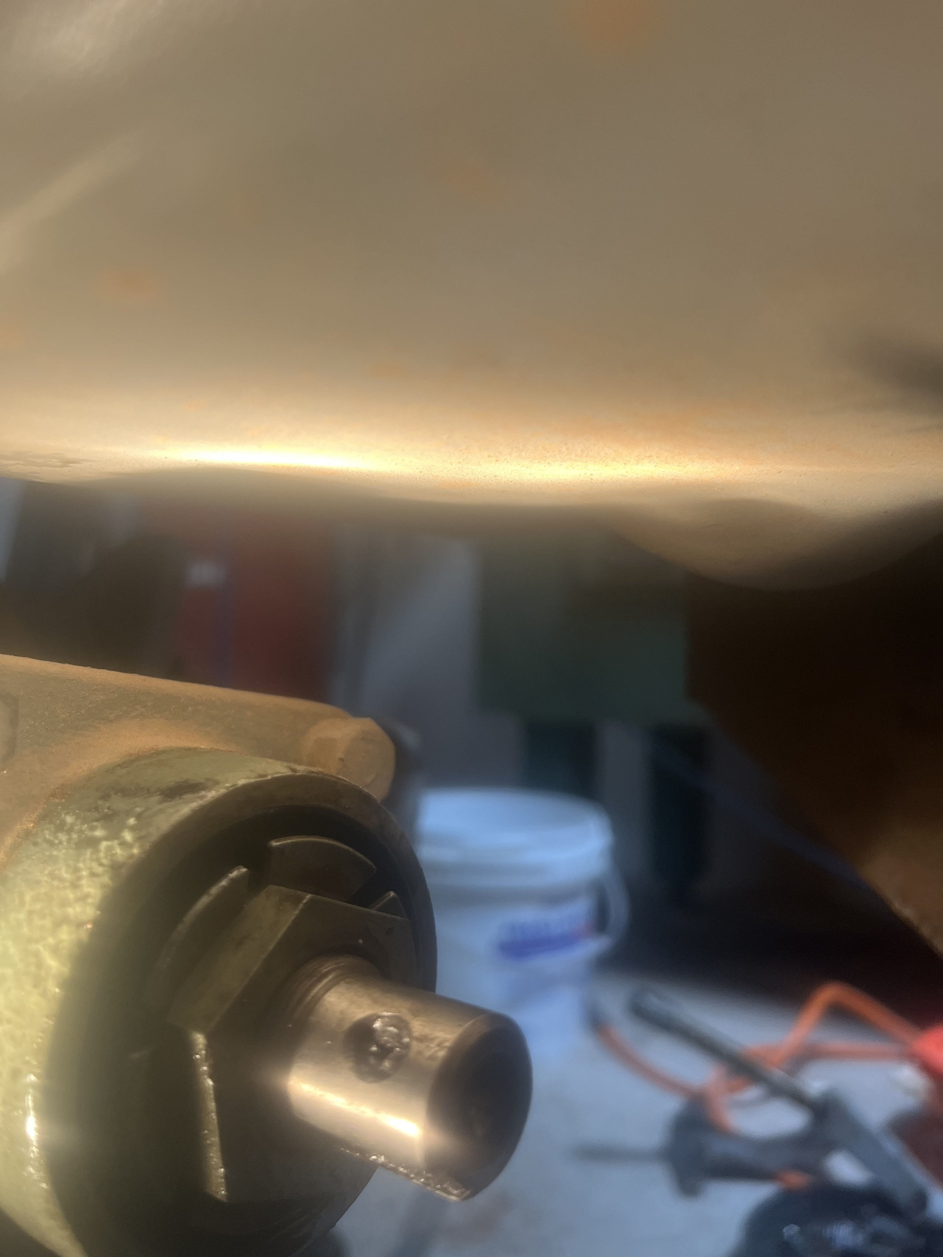

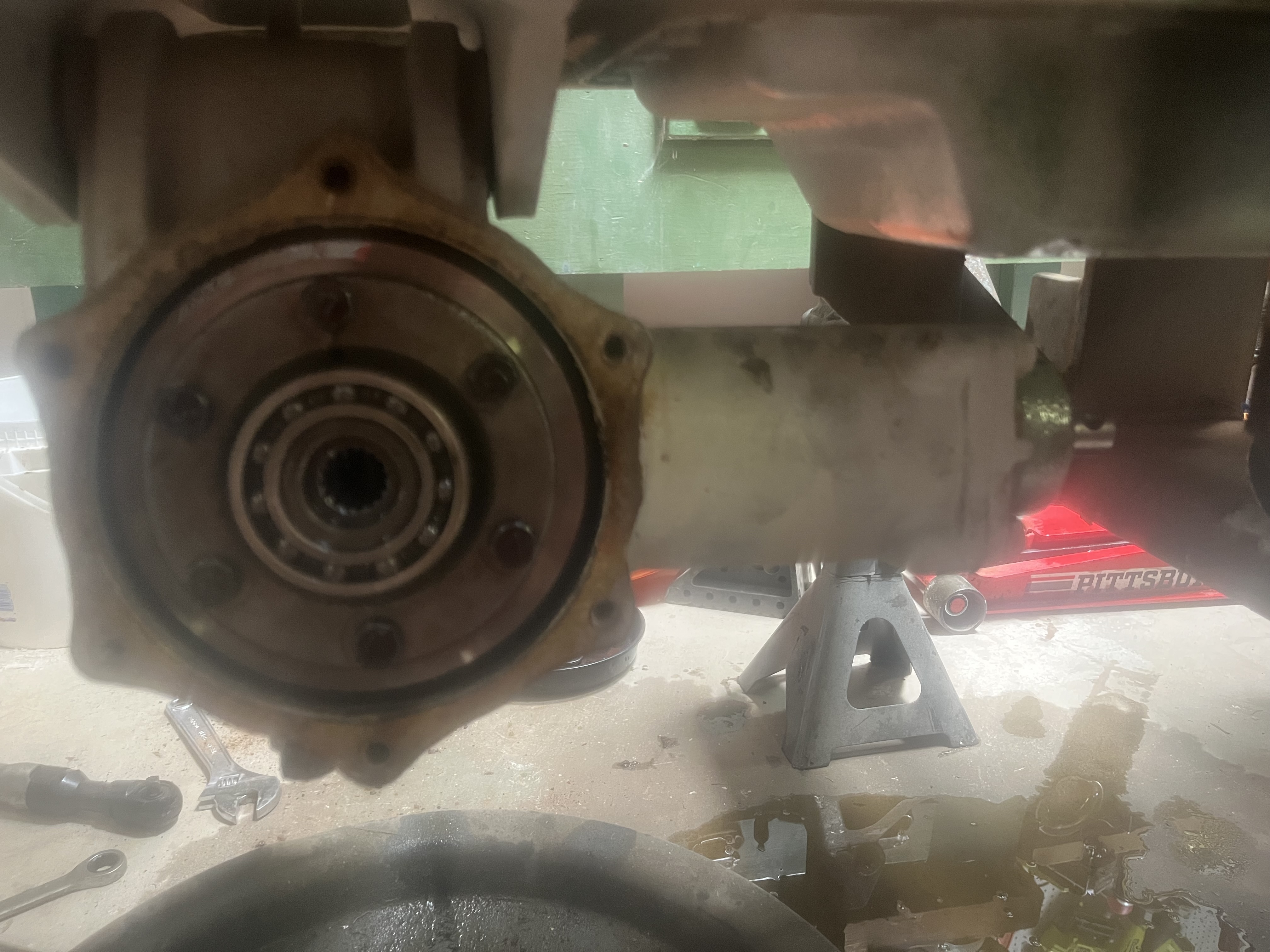

I was working on my tractor again today and wanted to share what I’ve found:
  • I removed the left axle cover to check for stripped gears—so far, nothing looks destroyed in there.

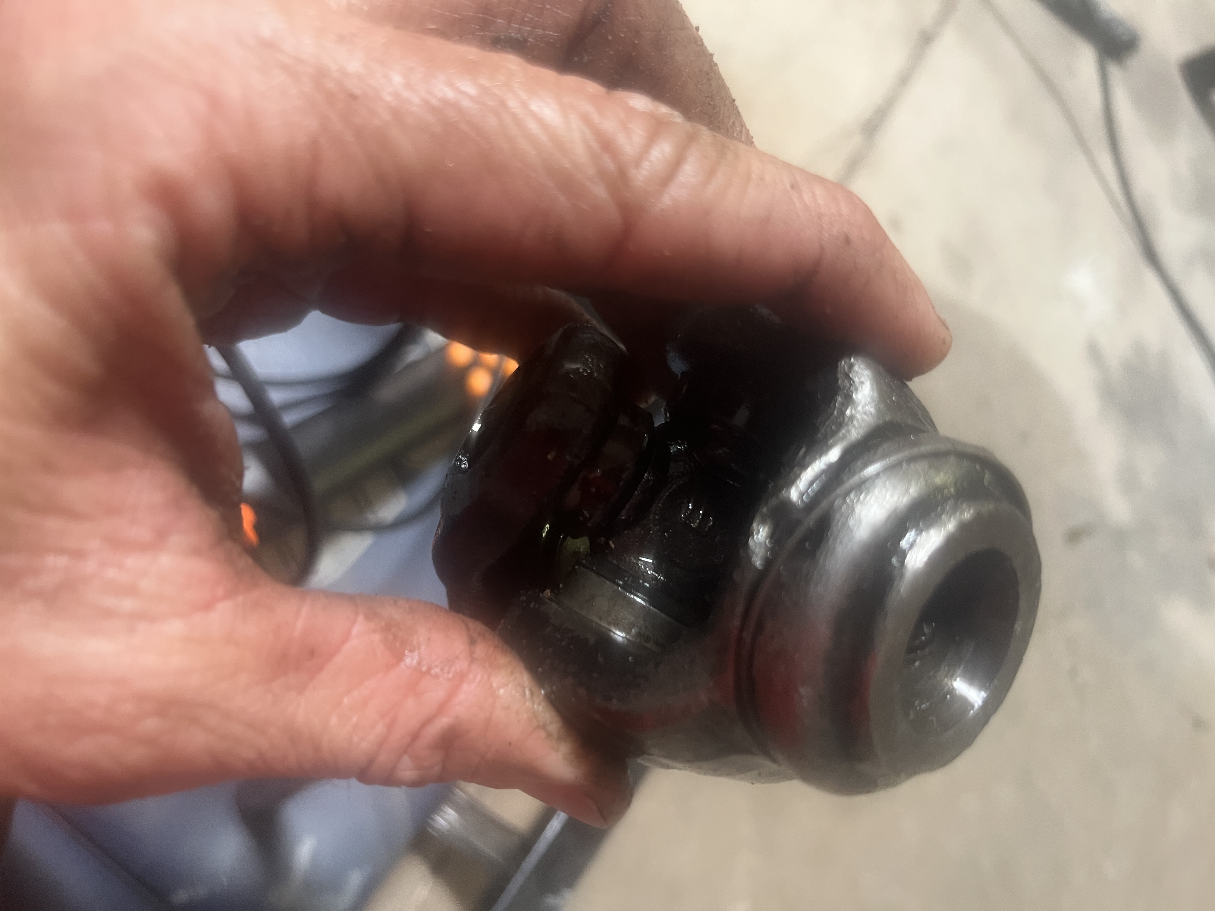

  • I pulled the driveshaft, and the lower U-joint looks a bit scuffed up. It’s not completely broken, but I think I’ll go ahead and replace it.
  • One thing I’m still debating: On the front differential, where the driveshaft connects—if I spin that input gear, I would expect the axle spindles to turn. However, they’re not.
  • Looking behind the left plate, I can see a gear spinning, so something is moving internally.

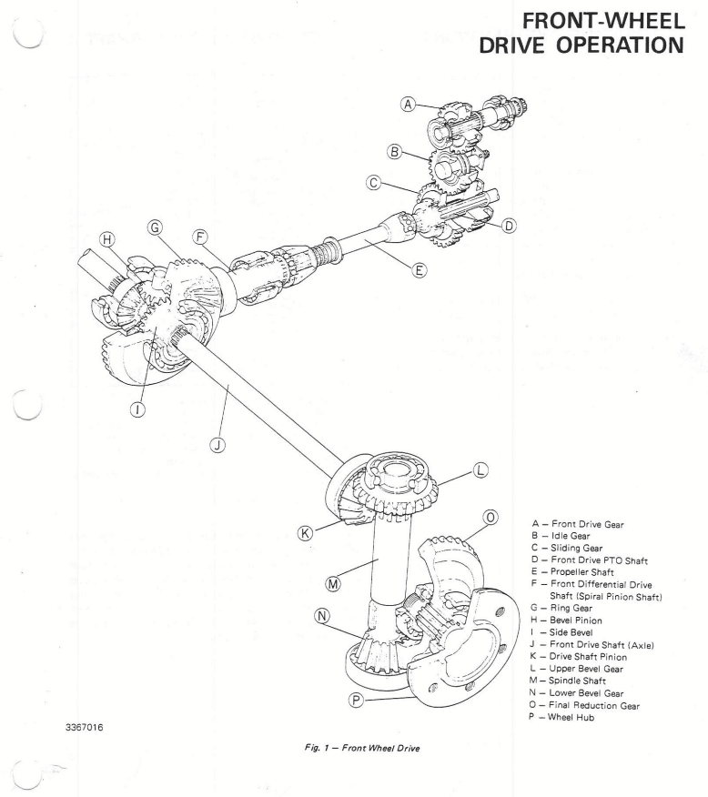

My main question now: Is there some sort of clutch or mechanism in the front differential that engages the wheels? If so, I’d like to understand how it’s supposed to work so I can troubleshoot more effectively.
So far, I’m encouraged not to have found any completely destroyed gears—just the chippedView attachment 3884820View attachment 3884821View attachment 3884822 gear I posted about earlier and the U-joint that needs replacing. If anyone can help me identify how this front differential functions, I’d really appreciate it.

I originally thought I could buy the U joint replacements from brand M parts, but it looks like it’s just some of the components. The part that looks worn on mine is the part that attaches to the input drive for the front differential. I don’t know if replacing those roll pins would help. On that input drive it looked like it was a slotted for a key however the U joint didn’t seem to match that key. I don’t know if the key portion would’ve got worn off, either way the input drive is not spinning the axle drives as I would have expected.

Long video but might be worth your time.
Winston, amazing video, thanks for posting. This goes into all kinds of details for the 4WD system. I learned a bunch from this, even though I have 2WD.
Yanmar made the system rather easy, not difficult. (y)

Thanks again for all the help so far—it’s been a huge benefit having this forum to turn to.

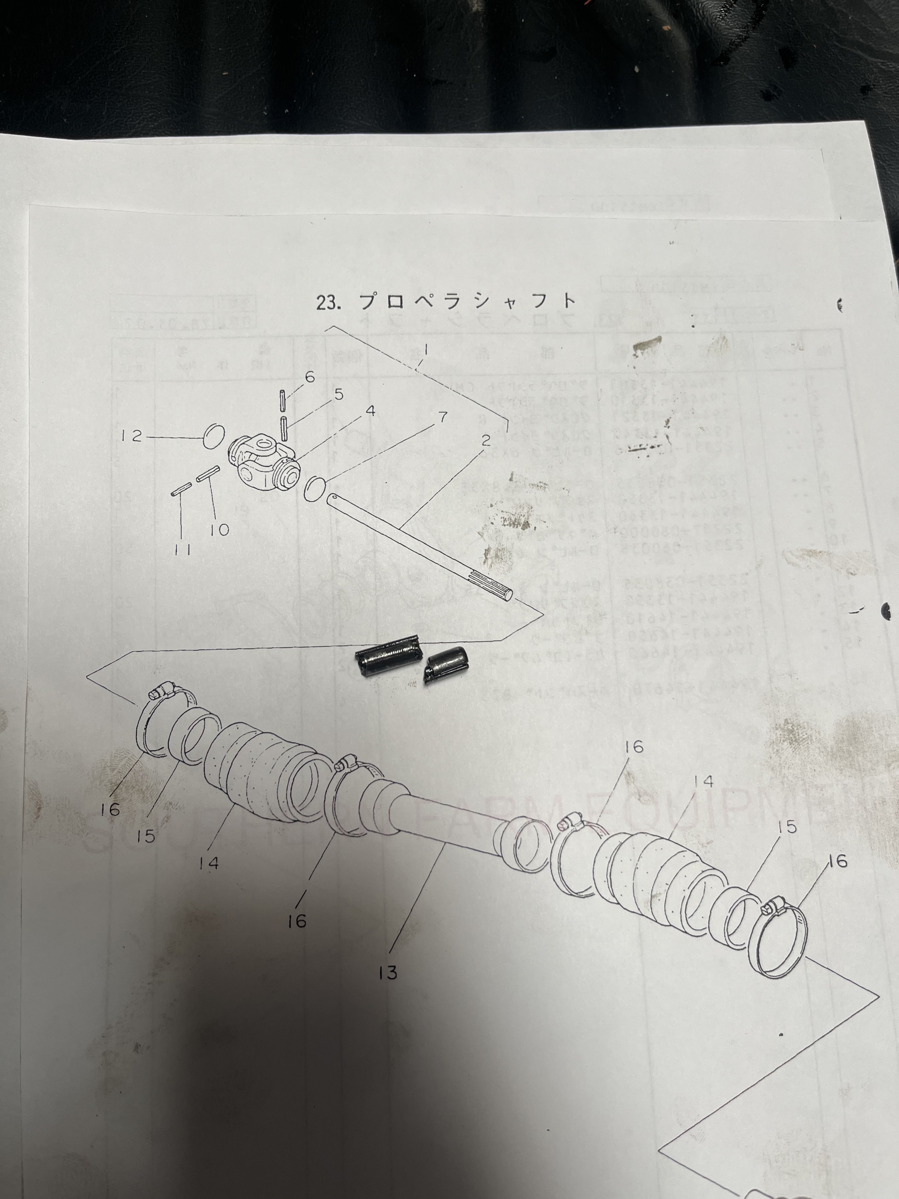

We spent more time on the tractor and ended up tearing into the front differential. The good news: we found no damage at all to the gears inside. That’s encouraging.
What seems to be the underlying issue is that the roll pin (shear pin) on the lower U-joint may have been the problem all along. I’ll be replacing that. You can see the sheared pin and before and after.
I was surprised that the roll pin is carrying all that torque to those front wheels, but I suppose an engineer was thinking let’s make the fail point be a cheap piece to replace and easy to access (little did that engineer know I’d still rip apart the entire tractor!! 😂)

Also, in the previous post, I mentioned that the input drive for the gearbox would spin but the axle wouldn’t spin. Turns out the reason for that is because I had the left axle hub off, which presses the differential gear into the helix gear. Just thought you guys would get a good laugh out of that bit of user error.
View attachment 3885664View attachment 3885665View attachment 3885666
