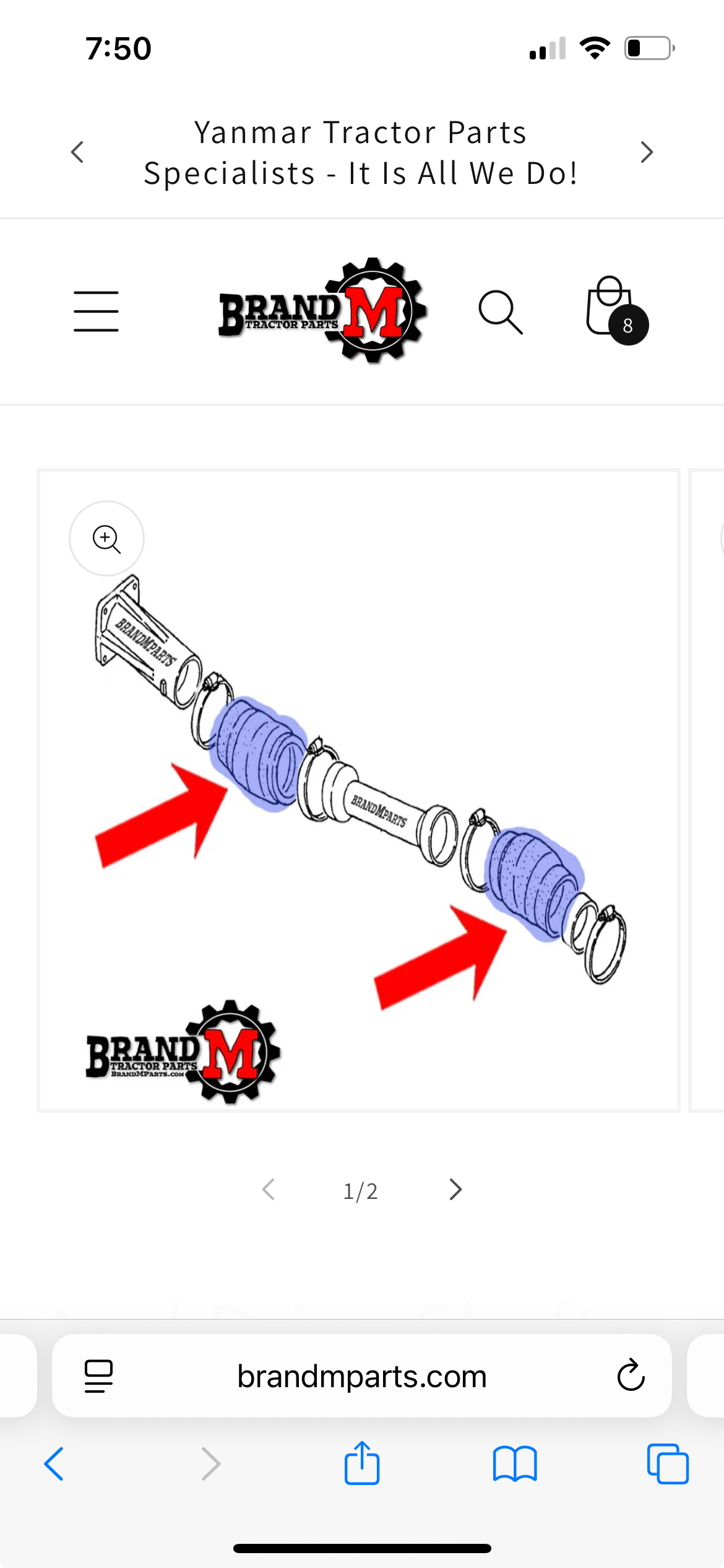

Any idea what to do for gaskets?
Also, for the u joints. Do I put gear oil in there or grease? When I took it apart oil came out.
If grease I assume I just pack it around the u joint and slide the housing over. If oil, how do you get the oil in there?

If grease I assume I just pack it around the u joint and slide the housing over. If oil, how do you get the oil in there?View attachment 3886066
There should not be oil in there. Either differential input shaft seal is leaking or drop box on 4 wheel drive seal leaking. That setup is not made to be lubricated other than possibly putting a little grease on the drive shaft spline.
