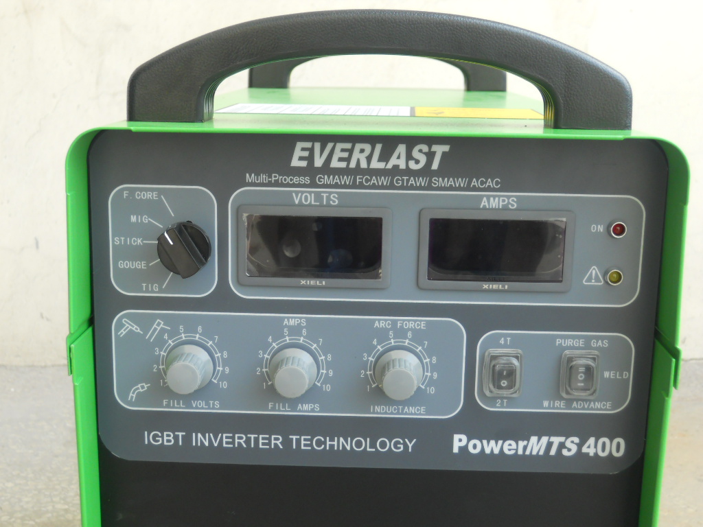

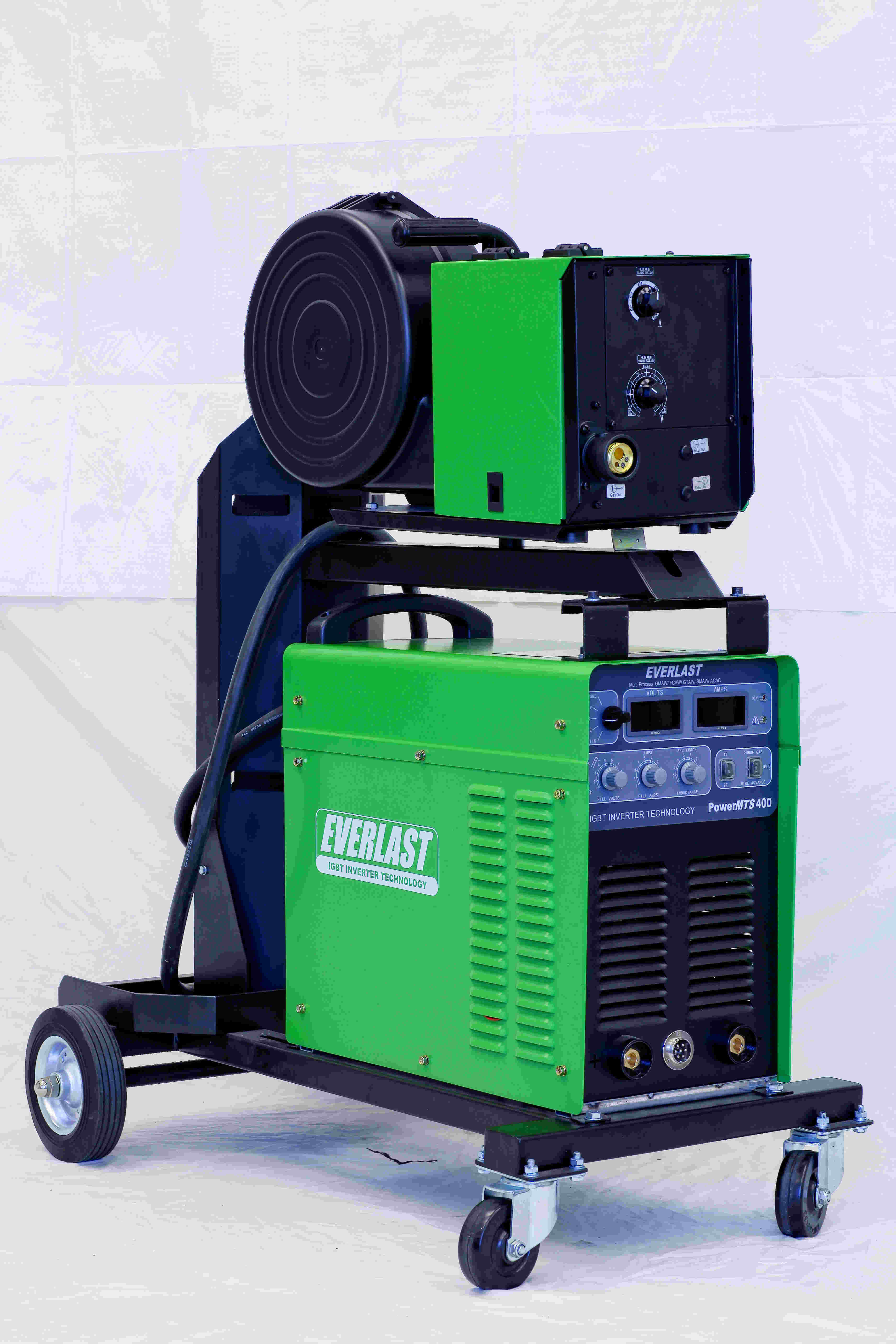

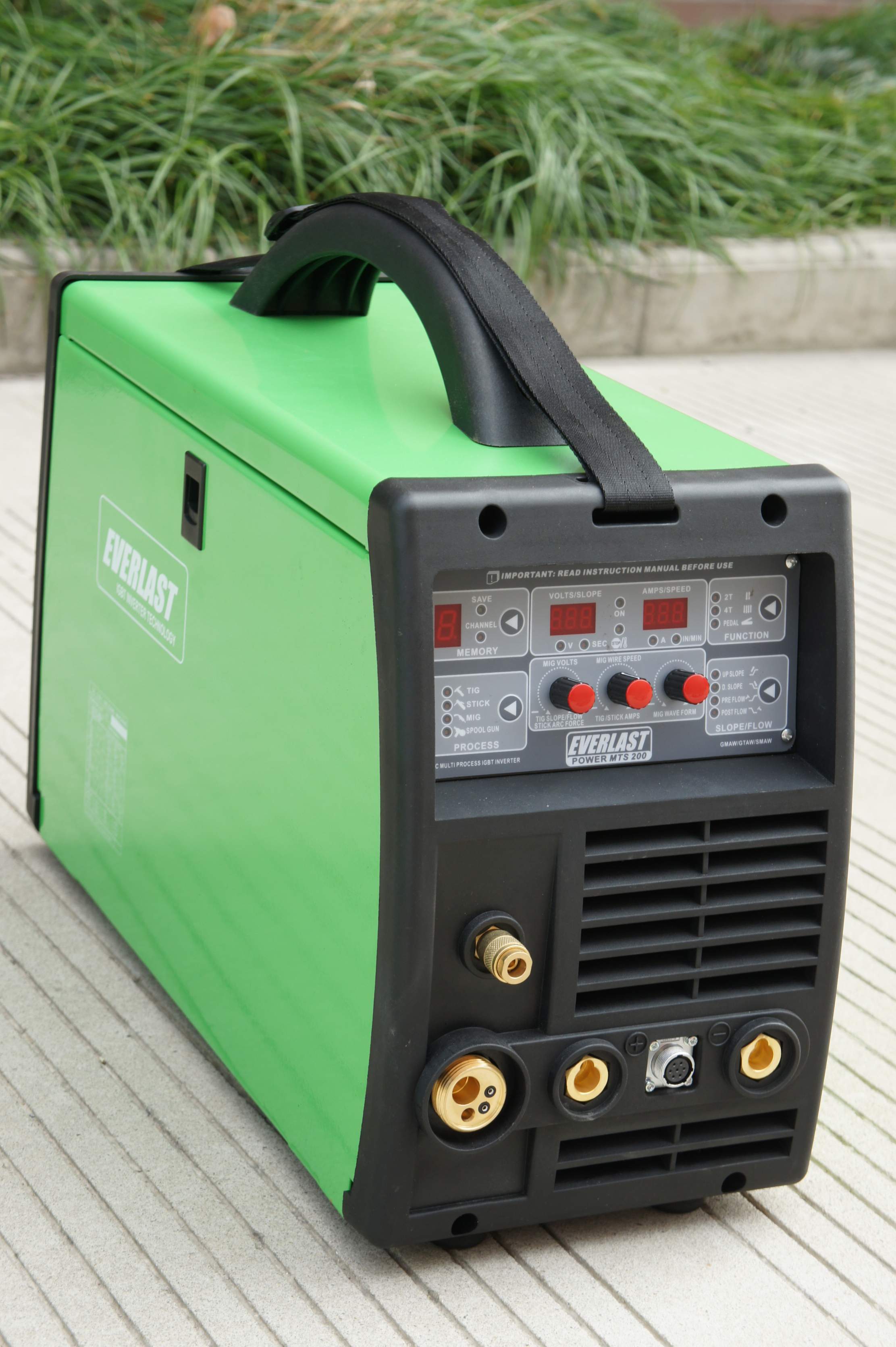

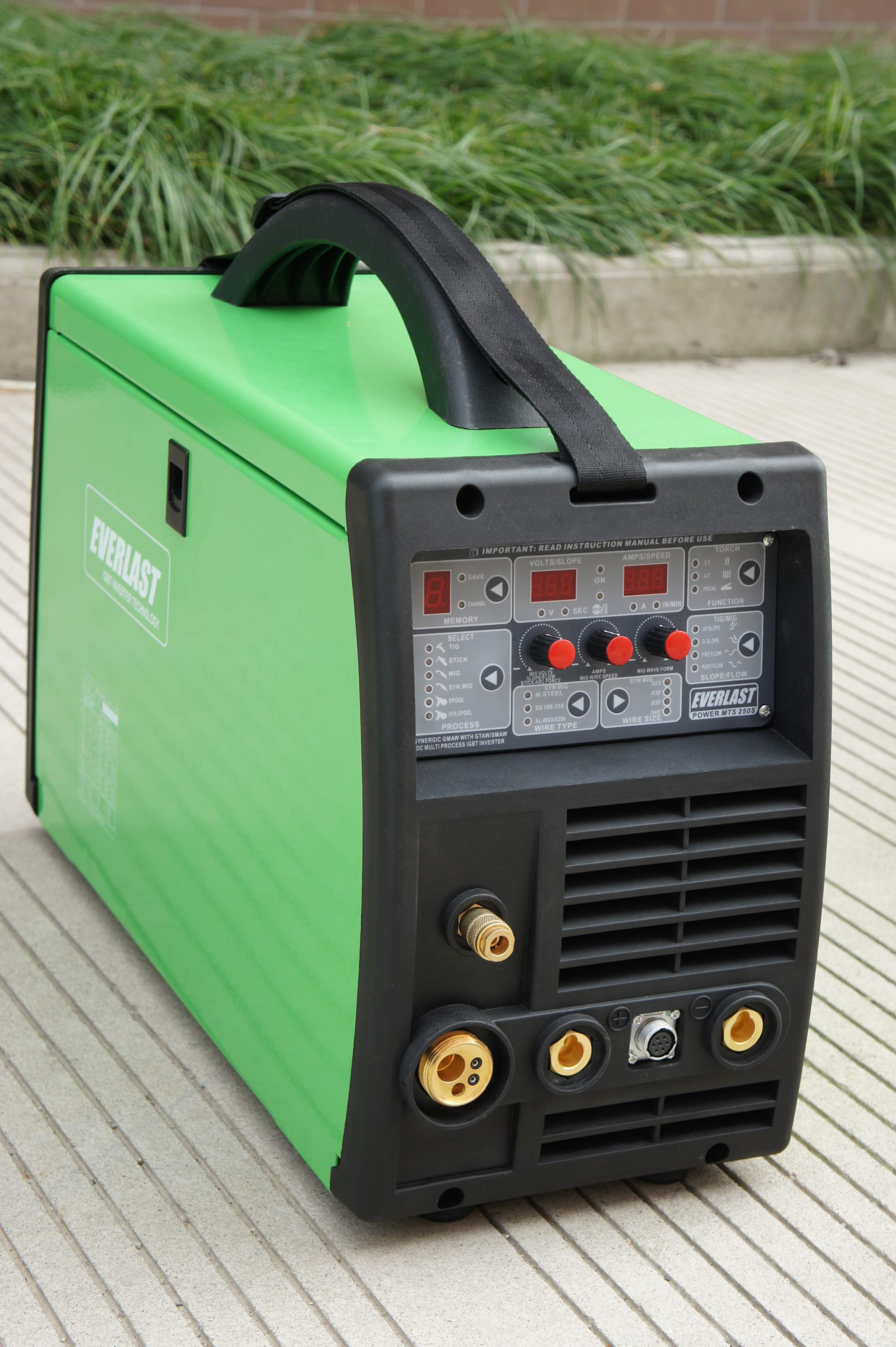

We have a portable synergic model MTS 250 that welds really nice. It's 250 amps. It has up and downslope features for the TIG, and supports a foot pedal, as well as a spool gun. The unit has a built in solenoid for the TIG so you don't use a gas valve torch. It also has We've had a MTS unit out since 2010...before any of the other companies were willing to get their feet wet with the units here in the US. We also have a MTS 400 which is similar to the XMT Miller 304 series and has a power unit with a separate, portable wire feeder. If you have three phase, it will operate on 480 with an output of 400 amps. It will run on single phase 240 as well, but will be limited to 250 amps output. Its a beast. We sell a good many here for shops, but also alot abroad in the oil fields in foreign countries. It comes with its own cart. We of course have a smaller non synergic 200 amp MTS.

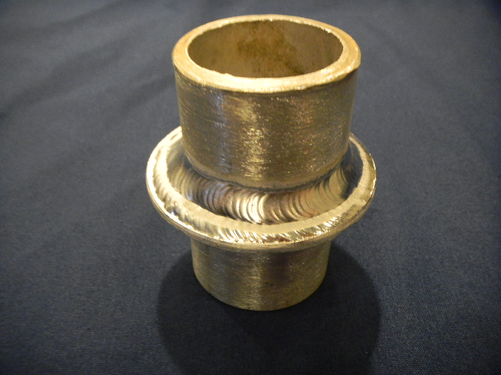

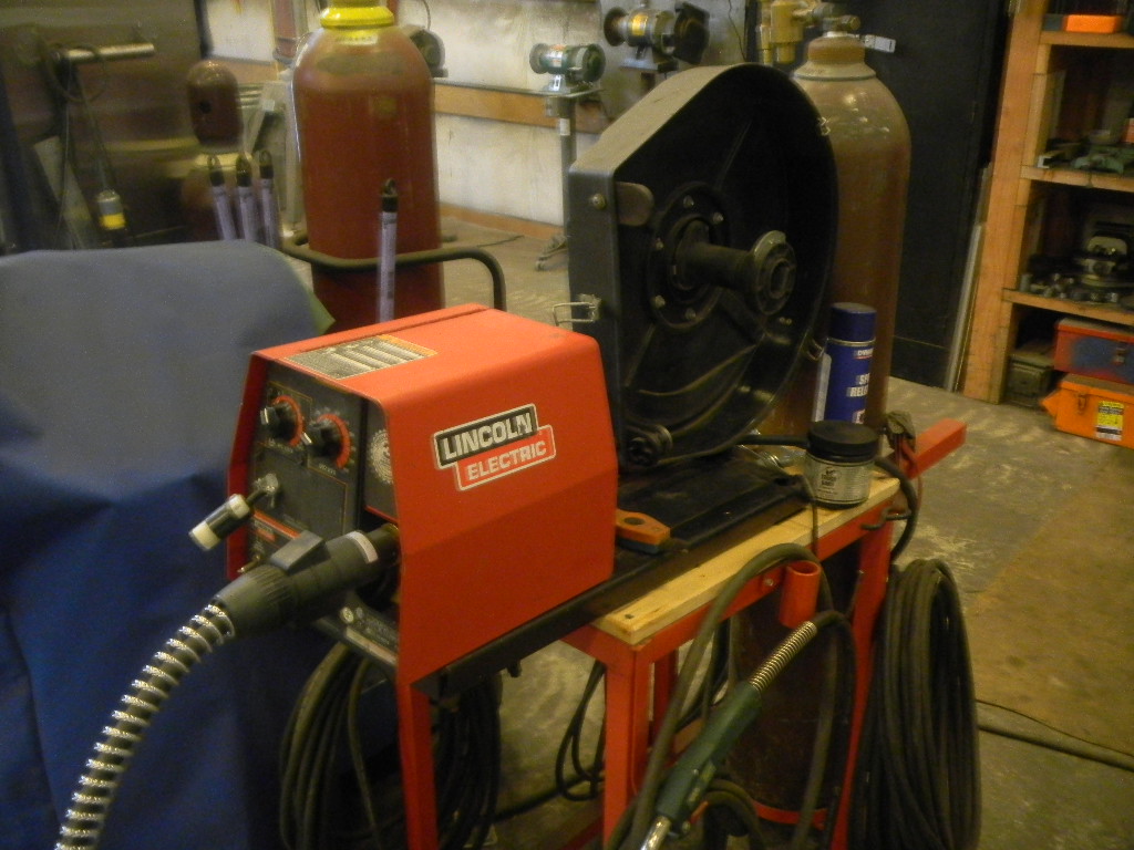

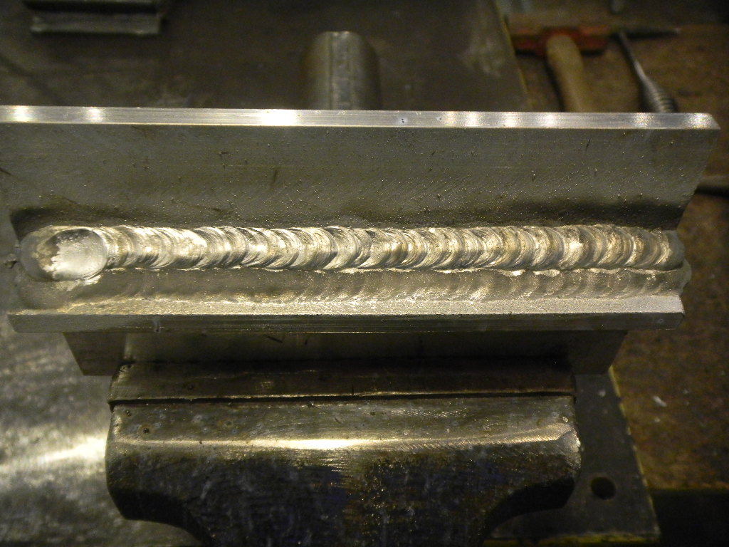

Depends, time is money! First picture is Tig welding aluminum, second picture is with a spool gun.

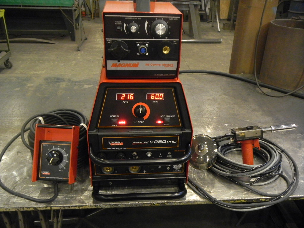

I have one. The Lincoln Invertec V350-Pro. I don't know do they make an all in one unit that has AC Tig?
