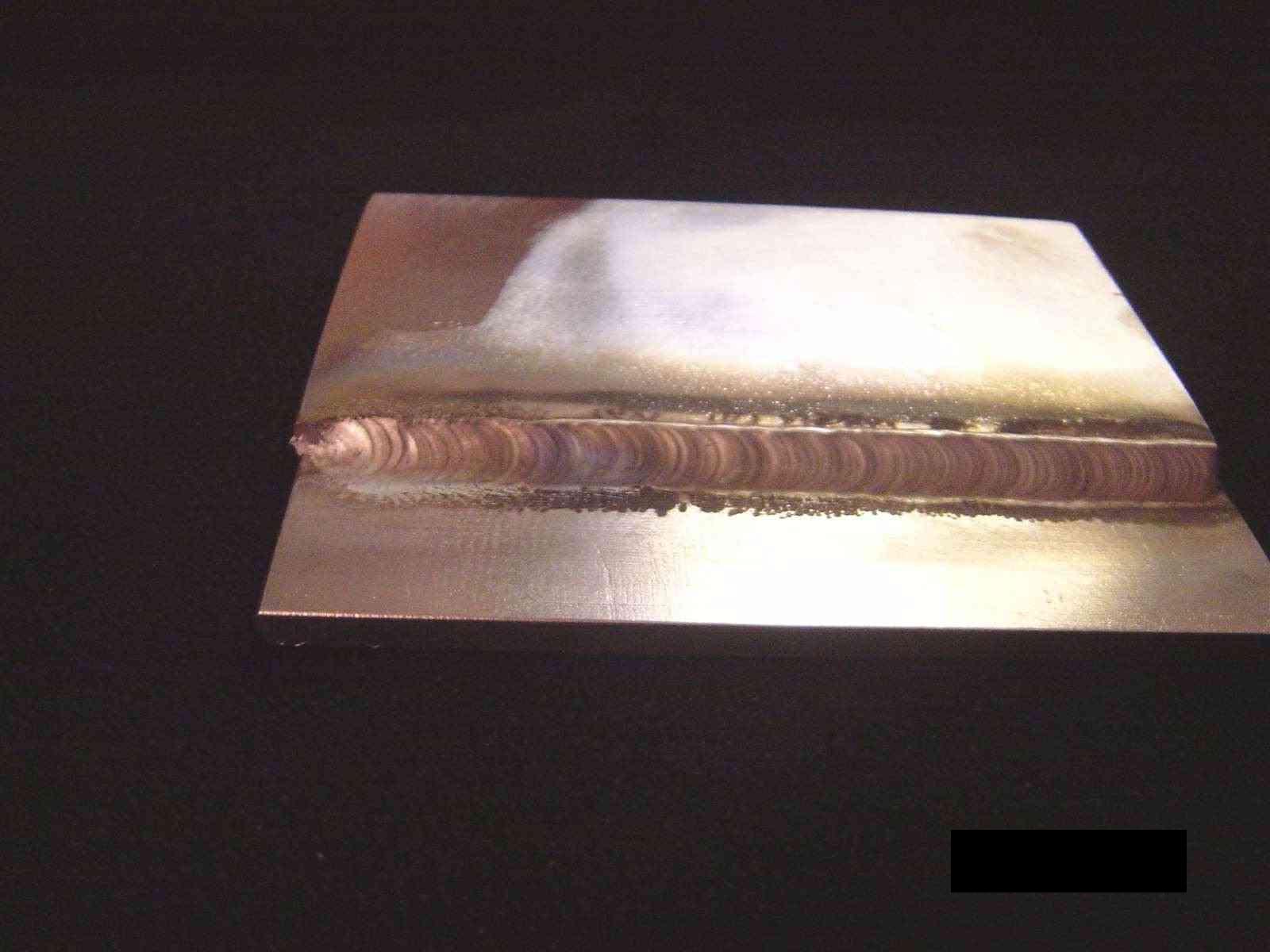

You guys remember just because you have a DC only Tig welder, doesn't mean you can not Tig weld aluminum. But you will need a bottle of at least 75% helium.
Here is a aluminum Tig weld I made using DCEN with 100% helium.
You need everything Shield Arc lists AND his experience to make DC TIG Al welds! There are YouTube videos of people making DC aluminum welds but there is a good reason that all the welding companies specify AC TIG for aluminum.

I didn't really think it was all that hard. Two things that I learned, there is a very, very small window where the arc will start, even with high frequency start. And if you weld 1/8-inch aluminum at say 130-amps on AC, with DC and 100% helium, you can just about cut your amps in half! DC and 100% helium welds hot!
I know you try to be a humble person, SA, but I think we all have to acknowledge that "not that hard" for you is probably not the same as "not that hard" for most of us.
/ weld grinding tips needed #138
You guys give me waaaaaay too much credit:eek:. I'm not all that good, honestly.
But thank you, all the same!;)
