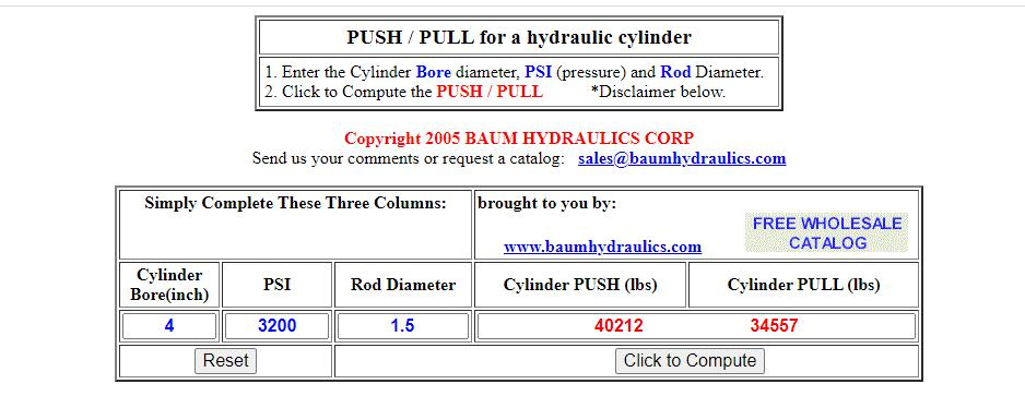

Calculator....
40,212 PUSH PSI divided by 2000 equals 20.121 tons
/ WALLENSTEIN WX310 wood splitter flow question #7
Where'd the 3200 psi come from? 2500 psi or thereabouts is typical for CUTS.
Hydraulic pump on stand alone splitter or pump on tractor (If capable of that pressure)... Only way you are going to get more tonnage with lower pressures is with larger diameter cylinder.... Graphic is for reference only actual values you have to work with will vary as to what is available to you...
And in case you need to know the pressure relief on my MF GC 1715 is set at 13,244 kPa (1920.88 psi)
So if I were to use the 1920 psi of my SCUT and a 4 inch diameter cylinder I could only achieve 24,127 pounds force or about 12 tons...
