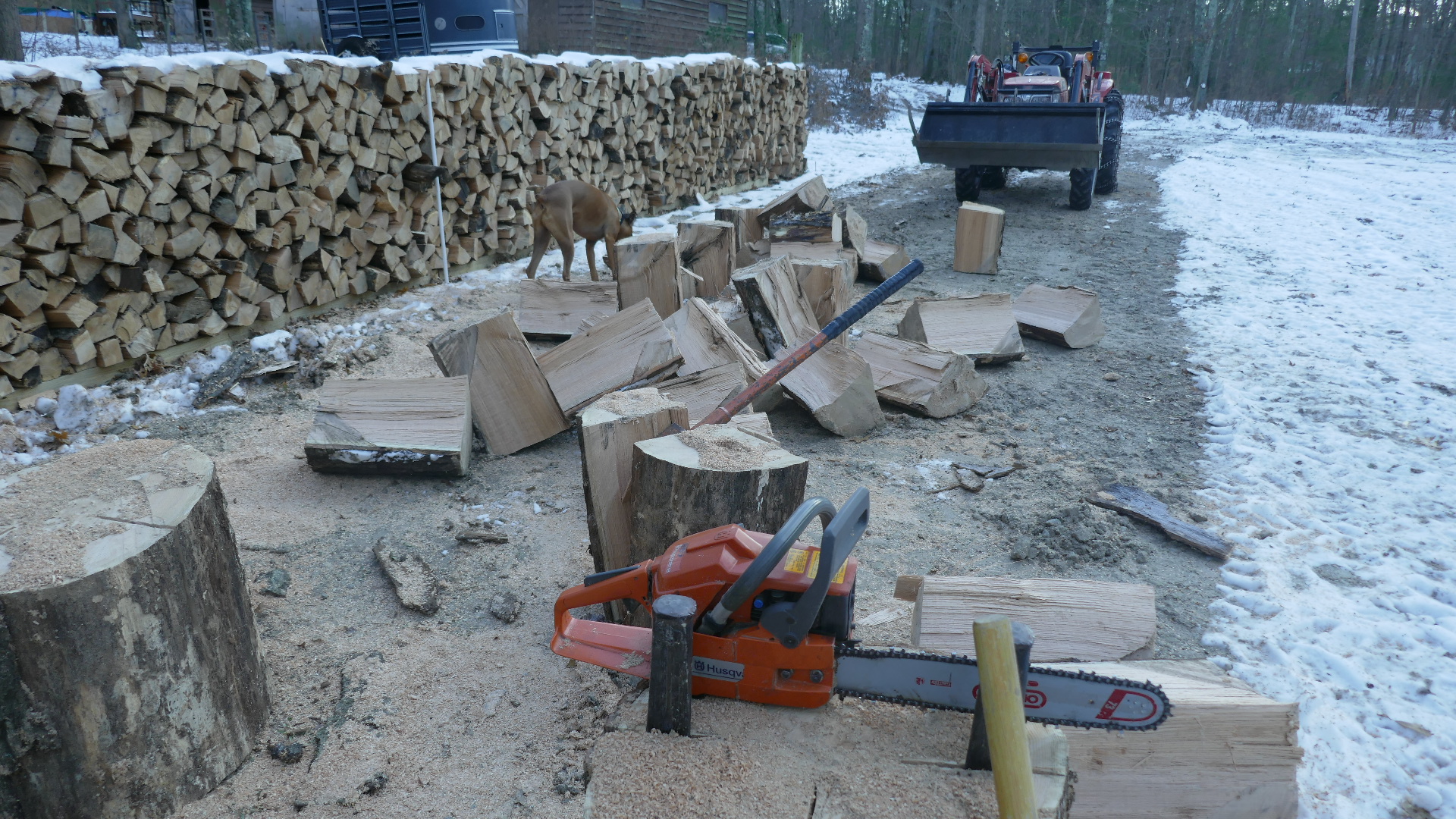

I'm trying something new this year too. In the past, I would take down the tree, or work on one that had fallen over from a storm where it fell. I would cut off the branches and then a bunch of rounds right there, then drag the log splitter to the tree and split it there and toss each piece of firewood into the back of the Mule. I would drive it back to my house and stack it. To cut down on the number of times I'm handling the wood, and make it easier to cut the rounds, split them and get them stacked, I'm cutting the tree into 20 foot lengths, give or take a few feet, and hauling them to the side of my house with the grapple. Then I cut them into rounds there, split them and stack them all in the same place. This seems to be a lot faster way of doing things. There is more mess to clean up, but that goes really fast with a rake and flat shovel into 5 gallon buckets.
A side benefit that my wife thought up while cleaning up, was separating the small chips into buckets for kindling. This makes starting fires even easier and it doesn't take hardly any effort to do.
I've been doing something like that too, though I have to cut into 8' logs in order to get them to my processing and firewood storage area without hitting trees or the barn. It seems like less work than cutting them into rounds where I felled the tree and then hauling the rounds.
I've also been saving the small kindling that falls off when I'm splitting. I keep a feed bucket next to the splitter so I can just toss them in, then store it in the back of the barn to dry. It's hardly any extra work and I have kindling pre made. Some species like madrone make a lot of little slivers when split. I do the same with the noodles when I cut large rounds into pieces small enough to get onto the splitter. I just grab the big piles so it hardly takes any time. A handful of dry noodles with a bit of bar oil on them helps get the fire going.
