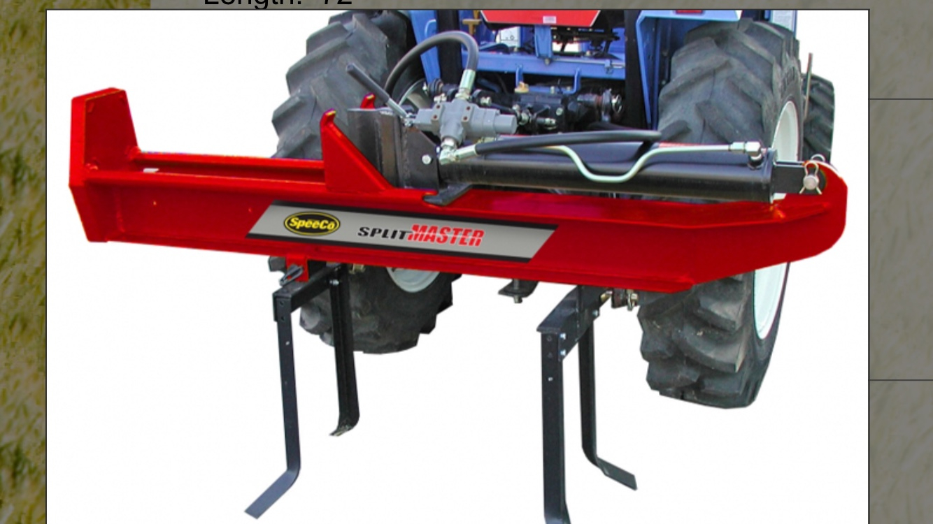

Dont know where your located but a friend of mine has a new Speeco that he wants to sell.
Probably could get it for $1000 from what hes told me. Looks like this one except his is yellow.
Tractor Supply sold the Speeco under their CountyLine branding on it in yellow. I know, I own one. Here is a video of a guy using it with his Kubota

Here is 3PH "Lumber Jack" splitter that is up on a stand and in-plane with the the tractor from Agri Supply instead of crossplane like the Speeco is. The reviews are positive apart from leaving them in the packaging outside and the manual gets destroyed. Looks like a standard going price of $800 without hoses. 3 Point Hitch Log Splitter | Agri Supply 90627

P.S. I just wanted to add to my post that you will have full force in both directions. I am guessing that the engineering calcs on hydraulic cylinders has some what a different force in each direction but I don't know what that difference is. I have not had any problems with that using my Split-Fire. And if that were the case than why do we only have one hydraulic cylinder on our FEL's and BH's and we use them and get the power out of them when using them in both directions.
Force from a cylinder is determined by PSI and the area of the piston. There is less force in the retraction direction because the area of the piston is reduced by the cross section area of the rod.
Most of the time splitters use nowhere near their max force. My stand alone with a two speed pump rarely shifts to the slow more powerful speed. So you can usually get by with the reduced force on the return stroke. But if you have a tough round to split, best to do it in the extension direction.

It looks like speeco is not making the splitter at all any longer.

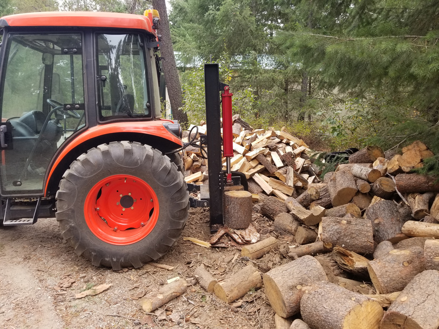

Hi Folks-I am a little late to the party, but I went through the same consideration of issues when I contemplated a 3 point splitter for my 2520. Much of what I read counseled against it. I bought a used Timberwolf TW2 Heavy Duty with log lift. The TW1's are really great from my experience renting them, and they sell for around 2K last I checked locally. By having a stand alone splitter, you can use the bucket loader on the tractor to collect split wood as you go and its one less touch of the wood to stack. Wood goes into the bucket and then to the wood sheds. I tow the splitter to where I want to set up, detach it and then cover when I am done splitting for the day. The tractor is free to do other chores and assist with the wood processing. One other thing to think about if you store your tractor inside--the log splitter hanging off the back would have prevented me from garaging the tractor during wood splitting times. I have the 4-way wedge attachment and hardly ever use it. The hydraulic log lift also serves as a work bench to stage 5 or 6 logs in the cue for splitting.
Good luck with whatever you decide to do.

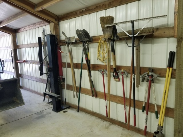

I haul 6’ sections to central splitting and stacking area. Cut lengths into 16-18” sections while sitting on torks at working height to lessen leaning over. Cut, split ant stack in work area so as not to have to haul twice. Works great.

My "Rankin Equipment Company" log splitter which I purchased ten years ago along with my "Power Beyond" equipped JD 3005 is bulletproof. Cost $1125 at the time. Three point splitters are generally cheaper than the equivalent stand-alone since there is no engine or hydraulic pump that you are paying for. No lift, but for big blocks you simply put it into vertical and roll the block in - just right if you're in no big hurry. I usually split about four cords a year. The best part is there is no maintenance necessary.

getting out thru my trees with 8' would be tricky. my path allows 6' without issue. i made my trails wide so i can drive my combined drive carriage with a team of horses thru trails. i had some great pics of us driving the trails....need to find them. all i can find is a photo hanging up downstairs thats been blurred by guy taking photos and printed on canvas. does not photograph well, but looks great on wall.
