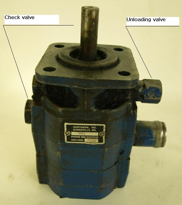

/ New wood splitter hydraulic problem #7
On the MTE pump there is a check valve that isolates the low flow hi pressure from returning to pump inlet and a sequence valve that shifts from low pressure hi flow to low flow hi pressure.
those are the only two components in the shifting of the pump. If you are mechanically inclined I believe both of these components can be removed for inspection without dismantling the pump.

oldnslo....... The guy at surplus center said those parts could be adjusted but he noted that if I removed them it might effect any warranty that might be left. At this point I don't give two ****skies about any warranty so I might just try that and see what I see. He also said that I could remove the cover cap and there was an adjustment screw that can be adjusted one way or the other to see if that helped. He didn't seem like he wanted to tell me much about which way did what he only would say turn the screw a little bit.

/ New wood splitter hydraulic problem #11
MX
The adjustment is for the shift point pressure and turning screw clockwise will increase shift point pressure. Set to high this will stall your engine.
I don’t remember where the check is located but suspect under a different hex cap or plug.

That's kind of what I was thinking so I guess I might try turning it CCW a little to lower the shift point and see what happens. I can't remember now but I don't think there is but one plug cap on the pump. That may be wrong and when I go out I'll look at it again.
