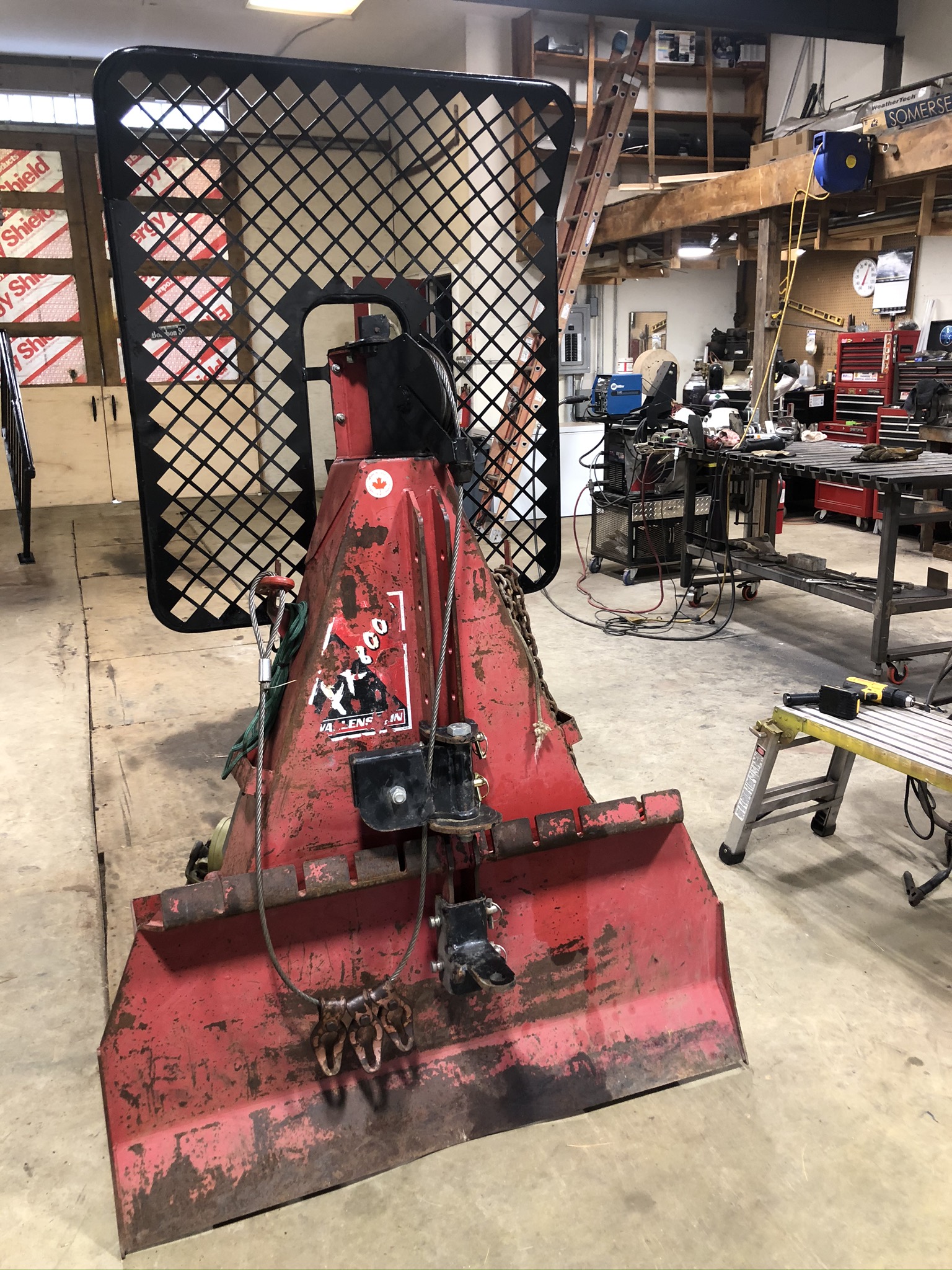

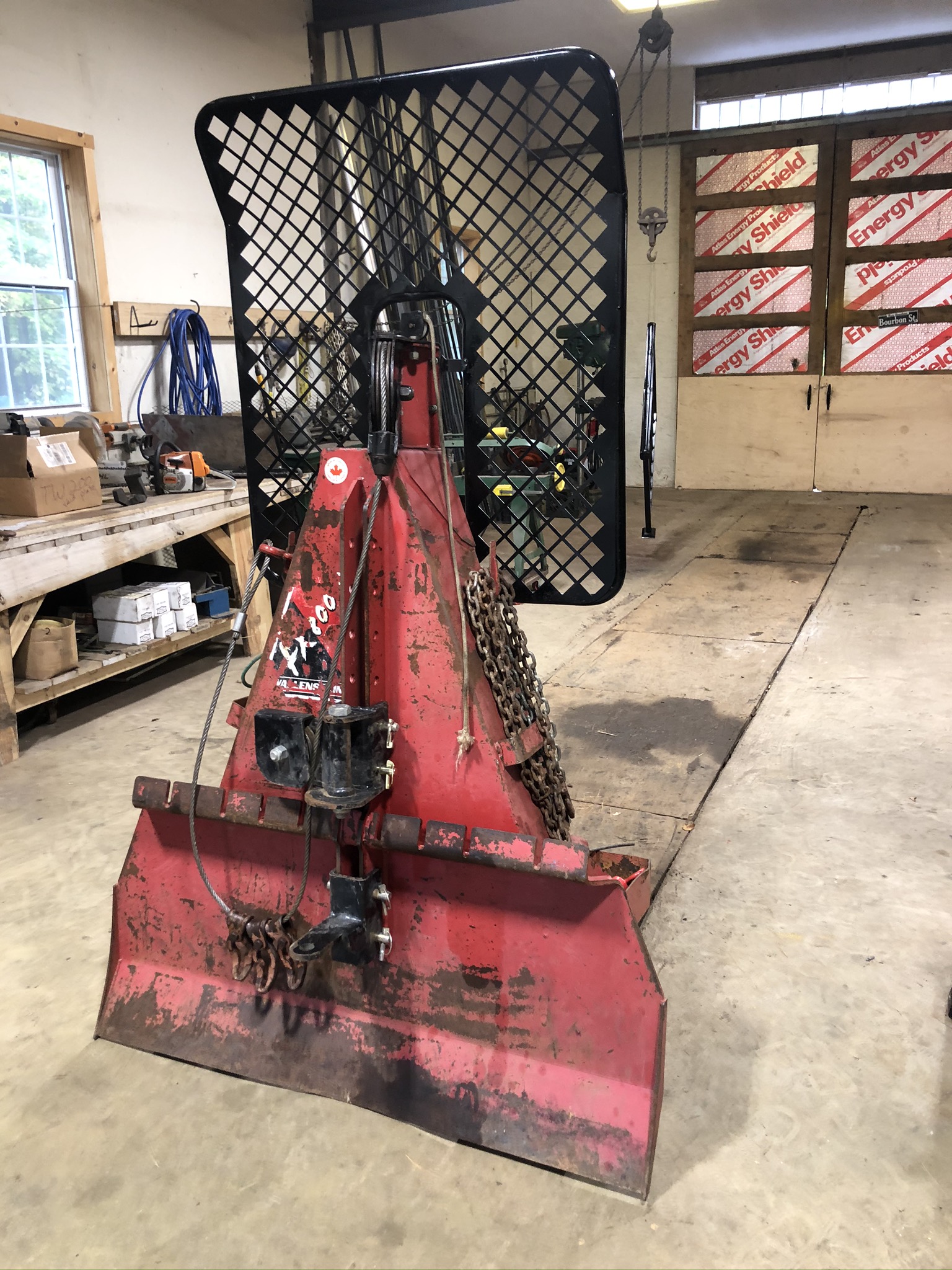

687793EC-EC6A-4033-A107-6C34F869113A.jpeg57509FD8-E217-4187-B4FE-C7F94FA565BC.jpeg687793EC-EC6A-4033-A107-6C34F869113A.jpeg57509FD8-E217-4187-B4FE-C7F94FA565BC.jpegSo I got the bits and pieces all screwed back together where they belong. I had spent a good amount of time straightening the badly damaged protective screen only to find that when nearing the top of the three point travel it was going to hit my canopy. So off it came and I leaned the top 8 away from the operators station. Then I fed the wire through the sheave and onto the drum and laid it out across the field to work the twists out of it and dragged a small log to wind the cable on the spool. Then I picked up a big hompin piece of white pine, 24 in diameter and 16 long and dragged that the full 165 and found that the tractor barely broke a sweat. The rain came in shortly after and put an end to the reindeer games but hopefully I値l be able to get up in the woods and put it to use in the next few days. Im going to put up some pictures because everyone likes pictures.

Looks good :thumbsup: Nice shop too !!
Looking at your pics reminded me of another tip. The dozer blade is bent, very common and not a particularly bad thing. The thing that causes that most often is winching your hitch in to close or tight. If you hang your logs off of the slotted rail on a short choker or you leave them on the cable under the lower pulley in such a way that when you raise the winch to skid them out the log(s) rest against the lower edge of the dozer blade then as you skid out the edge will dig into the logs and hold them. When you go over a little rise the front of the tractor dips down causing the winch to roll forward and up. The hitch can become cantilevered with the butts held against the blade edge and the short chokers trying to pick up the tail end of the hitch off the ground. It puts a tremendous force against the dozer edge. Leave enough slack so that the hitch can swing. You don't want the hitch to act like a stiff straight rudder. It makes steering much easier, especially with a small tractor, and the hitch won't try to cantilever on uneven ground if it can swing.

Glad you got it back in action. Looks like it’s in great shape. Paint does nothing to enhance performance.
I have to watch where I adjust my hydraulic top link because if it’s shortened, I can come real close to hitting my cab with the safety screen when I lift the three point.
