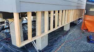

I built a 480 sq foot cabin back in 2008 on some family land. I never had it underpinned, would just winterize it in the winter. Last year my wife and I moved in it and this year we added another 500sq foot room. The insurance company is wanting me to underpin it. I dont have a problem with underpinning but im thinking I may need to but a vapor barrier down. Or could i remove about 25% of underpinning in the spring and close it back up in the winter. I crawl under cabin every year to spray for termites and there is no moisture problems, but it had never been closed up. Thanks Ricky

I have a similar sized cottage on sandy (well drained) ground.
I skirted mine and insulated walls, layed vapour barrier direct on ground to minimize moisture from ground rising up and added a couple of sliding windows from lowes ($100 each) that I can slide open from outside of cottage anytime I want to let air through.
I also covered the vapour barrier with recycled (free) styrofoam pieces and placed a wireless humidity gauge to a cheap weather station and I can monitor the humidty down below.
Never had a problem with this setup in a very cold climate.

Plastic vapor barrier is not hard to install provided the ground is smooth and doesn't puncture the plastic. If you go with a heavier plastic, will be tear resistant and can actually make it more pleasant to work underneath if you need to work on the plumbing or electric lines underneath. I installed some electric outlets and lights on a switch on the last place I owned that had a crawl space. That made it more convenient and pleasant to do any work in it.

If you insulate the floor like it should be skirting is nearly useless.
will the insurance company consider lattice "underpinning"?

I had the whole cabin sprayed with open cell foam. I only have plumbing in one section of cabin. Im thinking of just underpinning that area. It not being underpinned has helped out on widelife staying under there. Located in south west Arkansas so doesnt get single digit cold.

its skirting from the bottom of home to ground. I have seen people use brick, concrete blocks and they will usually have vents built into them. Personally I was going use metal from a old roof tear off. Just keep critters out and knock down wind chill.

Grew up in a house with a crawl space eventually my dad got it tested for radon it didn't pass he put poly over the entire dirt floored crawl space and added a few extra screened vents. It passed. Radon tests are cheap and can be bought at any big box home improvement store. My .02

around these parts when a building is built post on pad, underpinning is the skirting that runs from the floor joists down to the ground to stop the elements or critters from getting under the building. Not for structural support but rather aesthetics, insurance and environmental reasons. Often insulated and when circulation eliminated vapour barrier becomes a concern.
