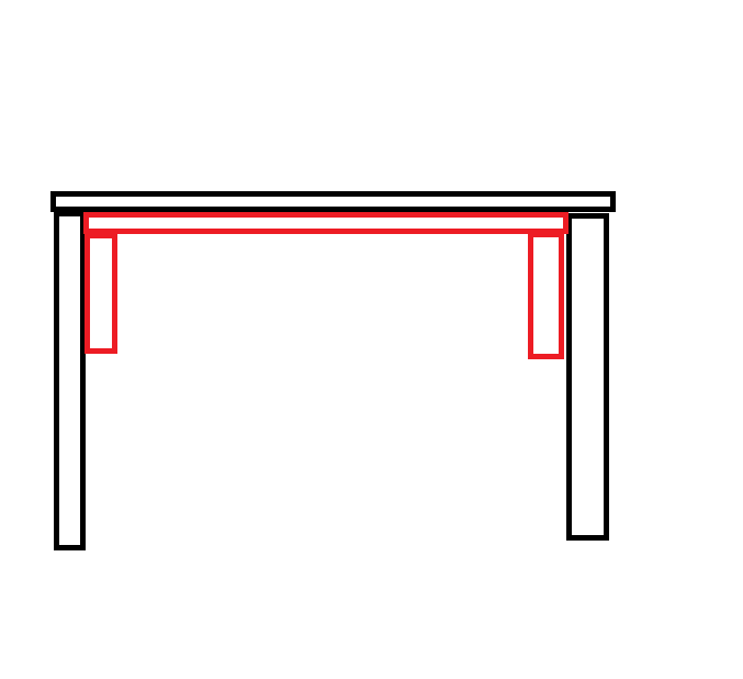

Now my question......is there any way to make a satisfactory repair from below? Given that everything is either tile and grout or laminate, repairing from topside is already gonna be a big project. Then factor in that its a 3-unit rental, displacing 3 tenants, etc.
So a couple of ideas that I have kicked around....given that the OSB is now DRY and we wouldnt be trapping any moisture....what about what about cutting strips of subfloor to fit BETWEEN the floor joists, pressing up tight to the "rotten" subfloor, and sistering the existing joists with some 2x4's See pic: Black is existing joists and subfloor, red would be added.
OR another idea....what about a structural closed cell foam sprayed underneath in the effected areas?

As to "strips".....how would they sag any more than the existing subfloor. If anything, with the sistering of joists it lessens the span.
I was thinking you were going to block it up perpendicular to the joists. I see what you mean now. My bad.
The spots that might sag or feel "weak" over time would be directly over the existing joists. Do you think the floor might feel like a washboard over time?
In your repair option, it seems like you'd have a LOT of framing material involved. Don't know how much that cost would influence the decision.
This is exactly what I was thinking of when I started reading your post. If the insurance company/engineer approves I can't see how it would be a problem. Everything gets fixed someway over time and having to disclose something like that shouldn't concern any reasonable buyer. Just keep the insurance claim documentation and any reports they give you saying it's approved.
