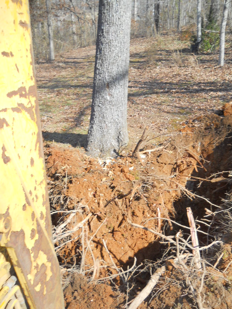

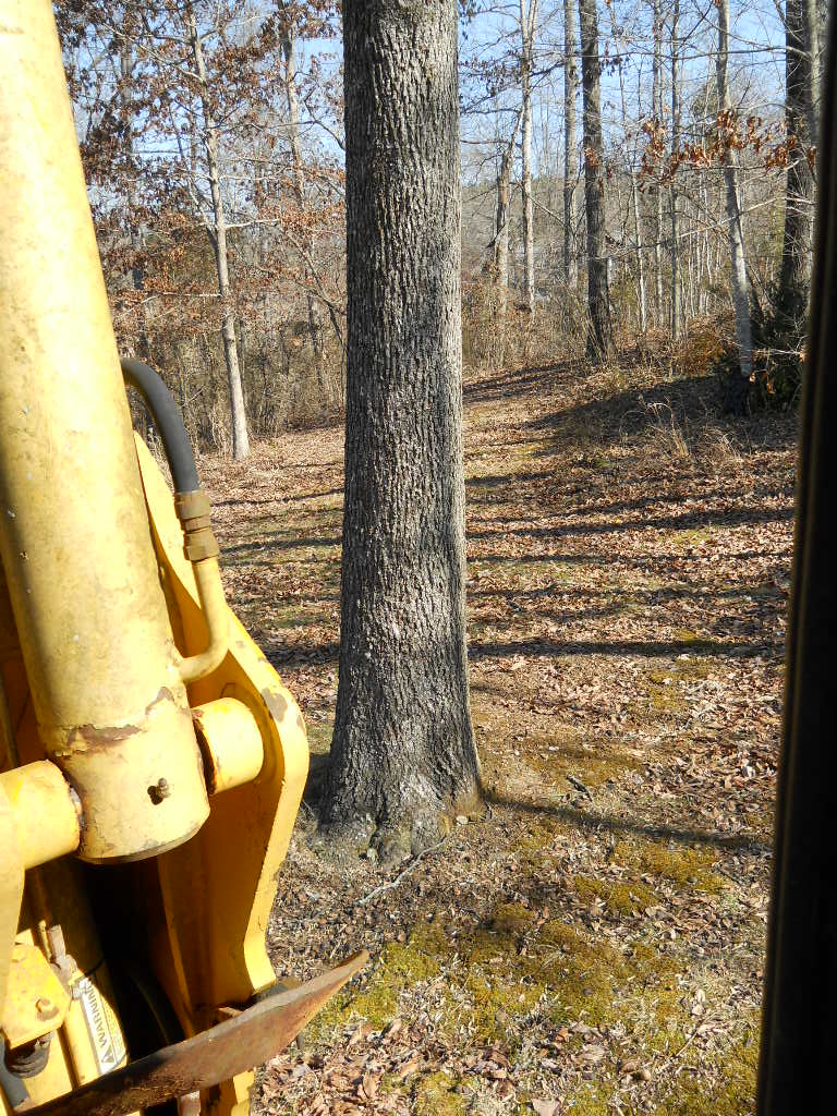

If you have to get the stump out.....I did it this way...dig on three sides....and push
This what works for me most of the time. If room permits I make the three digs to cut the roots then use the FEL end to push over and move out of the way until I pile them, etc.
