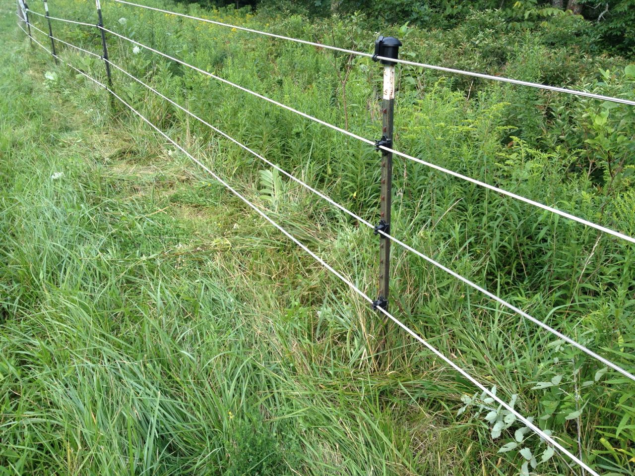

I've found that it uses string really fast. Heavy grass and weeds (3' tall or so) will bog it down, even in L1 creeper gear. I got mine to use not only around our horse pastures fencing (which it does a decent job of), but also around our pond......that's where I'm most disappointed. It's hard to adjust up and down and keep it out of the dirt/mud but cutting the weeds. I'm sure things will get better with more use and the "learning curve", but DR will never get me with their return policy again.......promise!!!
