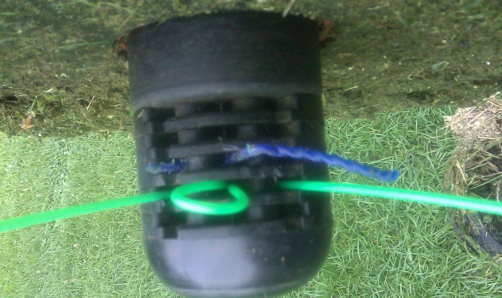

Hmmm, anything special that would need to be done to weld the ends?
Aaron Z
not really. fairly typical way to keep wire cable from unraveling. like taking a match to nylon rope. I think the preferred way is to just heat it with a OA torch. (least thats what i do) IE you dont need filler wire that a mig or stick welder would add.
Mind the mushroom on the end if you have to feed the line through a small hole or something, Its hard to tell what the tolerance on that string holder is.
   / Using DR PTO trimmer on Cat 2 Tractor? #122
So just heat it up with a torch till its cherry red?
Normally, the line has to be fed through, but removing one bolt on the bottom of the spindle will let you just set the line in (ie: the pieces the line goes through are just stacked and come apart if you pull the bolt).
Aaron Z
   / Using DR PTO trimmer on Cat 2 Tractor? #123
So just heat it up with a torch till its cherry red? Aaron Z
Generally it has to be hotter than just red. orange or yellow, so that the metal starts to melt slightly and ball up on the end. (which is why its an OA torch and not propane) Its only 1/8" aircraft cable so it doesnt take much. You can put a slight mushroom on the end so you know the strands are welded together, then before it cools you can beat it back to nominal diam on a vise or something.
Just try a few times before to get a feel for it before you cut off the lenghts. I prefer to use a cut off wheel to cut the cable as opposed to some sort of jaw cutter.

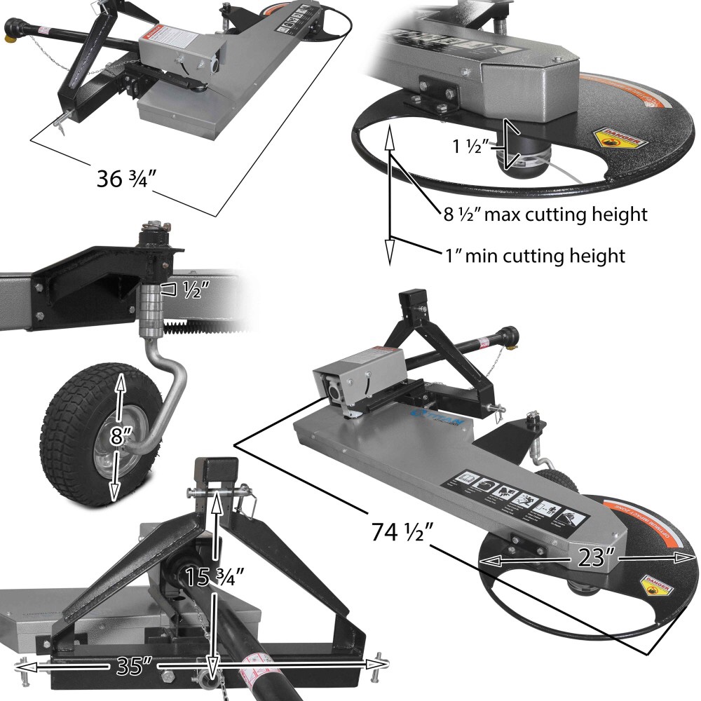

FWIW Titan is now offering a similar cutter and much lower cost than DR.
Titan 3-Point Hitch Attachment Trimmer Lawn Mower Category Cat 1 Tractor
It's always good to have competition. But the cost difference is only about $150 at the moment, so other factors could easily be more important. Also, DR Power is offering free shipping at the moment, so theirs may even be less money overall. Titan doesn't give a "reach" spec, but the diagrams make me think it's no more than the 63 inches of the DR Power unit. Longer reach is the only thing that might make me want one.
   / Using DR PTO trimmer on Cat 2 Tractor? #138
74 1/2" from center line to outside of trimmer guard. DR Claims 63".
So, 11 1/2" wider.
