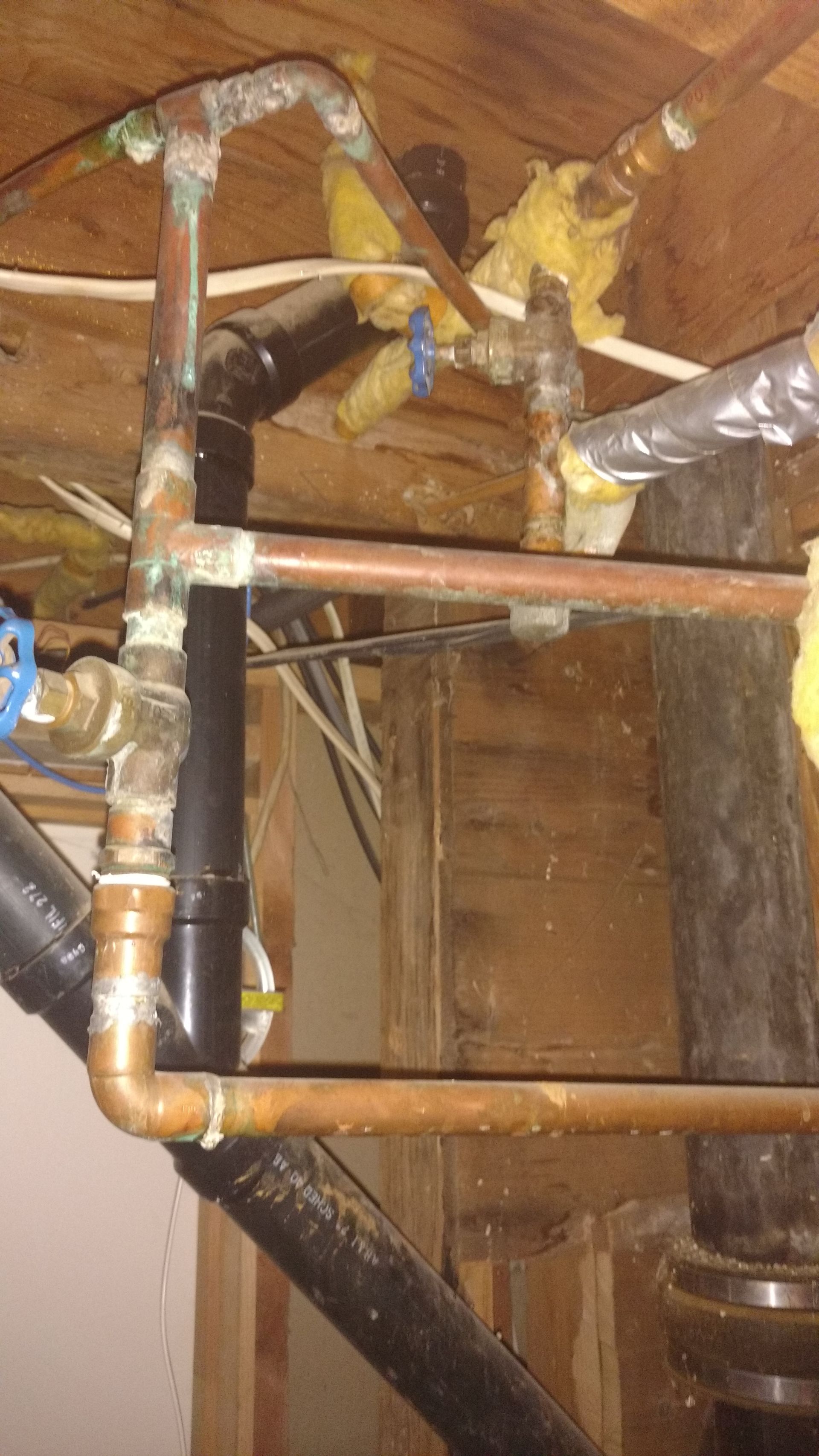

I did not see any vent through the attic above the commode or sink. There is also a shower in the bathroom. I will do some more investigation today to see if I can find a vent. Yes I agree the commode should be vented, and if it is, the others are likely tied in.

Update:
I located TWO vent drains just outside the wall of the bathroom where the sink, commode, and shower are. One vent has a cap on it-- the other does not. I am not sure but presume it had a cap someday that has been lost long ago. It is just a pipe sticking up, and if it rained the drops would go down the pipe. We have lots of leaves, etc, some of which also certainly went down the pipe at some point.
I tried putting a metal fish tape down the pipe but only got about 2 feet until it stopped. I am guessing I hit a 90 degree elbow. I poured several gallons of hot water down the pipe, sometimes on its own and sometimes while the sink was running. Then I plugged the sink overflow and used the push/pull method with the sink plunger. For about 10 minutes this time.
Just like last time, after working it like this it drains faster than the faucet can deliver water. Nice! And I can hear water draining out the top of the vent pipe that has no cap. Last time and this time, it almost seemed as if using hot water was "magic" that caused the drain to open. And last time, by the next morning, it was draining slowly again.
I will test it again in the morning. If there were any leaves in the vent pipe I am hoping I washed them down and out.
