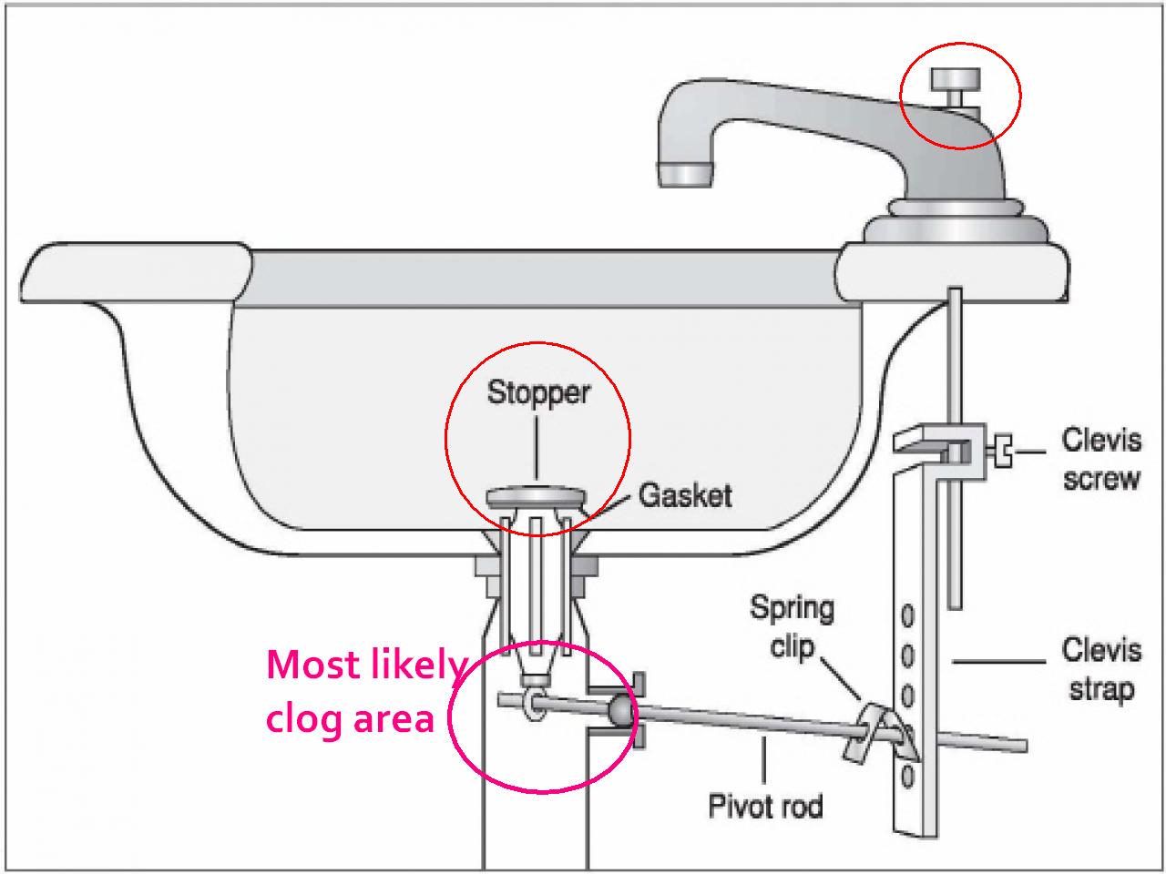

I always start off trying the pull back plunger method Mossroad suggested. If that doesn't work, I usually find the clog in the first few feet of the drain. For some odd reason, I think my shaving cream builds up in the tail pipe of my bathroom sink just before the trap. Maybe the trap slows the velocity of the drain water and allows the shaving cream time to stick to the tail pipe.
My other usual suspect areas are the bend in the trap, the line running into the wall, and the 90 degree transition in the wall. Many of the older houses had 90 degree fittings here instead of sweep transitions that have better water flow.
I doubt that the blockage was in the ABS pipe in your other photo.

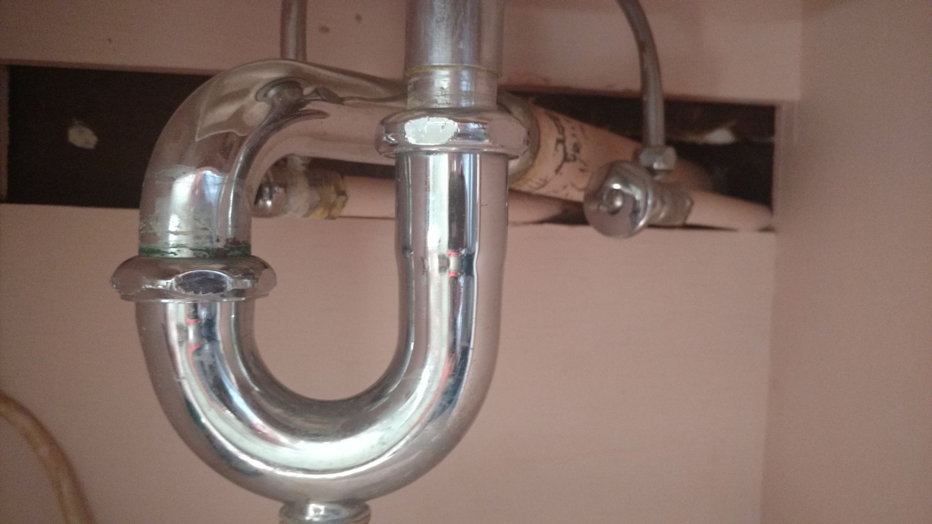

Trouble again!
The sink was backing up again this morning. Not nearly as bad as before, but holding maybe 2" in the bowl while the water was running.
Here is the weird part. I watched it slowly drain after shutting off the faucet. It drained until the water level in the drain was about level with the bottom of the sink. It stopped and held that level for a few seconds with no movement. Then, on its own, whoosh it drained. I did this twice in a row. Once the water is drained down to the P-trap, I then hear glug-glug-glug-glug-glug about 10 times or so. Is this maybe also a venting issue?
Do I need a plumber, or a witch doctor to remove the spell???????????

Glug glug sounds are from the system trying to breathe. The first thing I would check is the flow from the house into the septic tank. There should be an inspection cap on the pipe between the house and tank.
There should be no standing water in that pipe. Flush a toilet and you should see the water flow through.
The tank vents through the house risers and if the tank is overfull meaning it is not draining into the field properly, the house outlet pipe remains full of water.
Then nothing can vent.
No vent, no water flow, leads to clogs and eventually sewage backing up into the house.

It may be that you were able to loosen the obstruction enough to get water to slowly drain when you used the plunger, but it is still inside the pipe. Although a plunger can loosen stuff, I've never been able to remove built up crud in the pipes without taking the trap apart and running something like that plastic zip tool or an electrian's fish tape in the pipe to pull out the crud.
You also mentioned glug, glug, glug in another post and that you have an older home that has been remodeled. Although you don't have to have a vent pipe right at the sink, the drain system does need air to drain. If the drain used to work okay before, my guess is you still have an obstruction in the drain line. All the vent air in the world won't compensate for a lump of crud in the drain line.
My thought for now is to stay off the roof and try to see you can pull out any obstruction in your drain that's not draining.
You can buy a USB snake camera on ebay for about $10 that has a built in light if you want to try to see what's inside the pipe. Occasionally handy for looking inside walls or car repairs, too.
