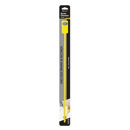

If you put chemicals in the drain and it doesn't clear, you then have the chemicals to deal with.
Those little sawtooth plastic drain tools are only $1.00 at our local dollar store.
Could you shoot a few pictures of roughly the first 3-4 feet of your pipes? My clogs always seem to be in the first few feet of line.

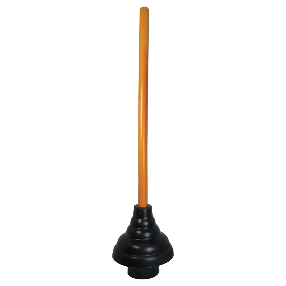

Well, since you can see the water in the trap, and you already pulled the trap, you can be pretty sure the blockage is further down the line from the trap. I'd still try the plunger first, as it's the least expensive, less invasive, less work method. Can't hurt.
Hope it works out for you.

My wife is enroute right now to purchase a sink plunger!

Success !!!!!!!!!!!!!!!!!!!!!!!!!!!!!!!!!!!!!
I now have a drain that is functioning as it should. I used the sink plunger, and with a lot of effort over about 20-30 minutes it first coughed up some black crap, then slowly started to drain, then more, and now whooosh!!! Thank you all so much for contributing. I was dreading having to pull galvanized pipe out of walls. That might happen in the future but it works great now!!!
btw it was very stubborn at first. At least 10 mins of vigorous plunging with only a little black crap to show for it. But once I started to see a little progress, the plunger seemed to get more effective as the drain finally started working. It seemed most effective right at the end-- maybe because of an ability to move a greater quantity of water back and forth?
