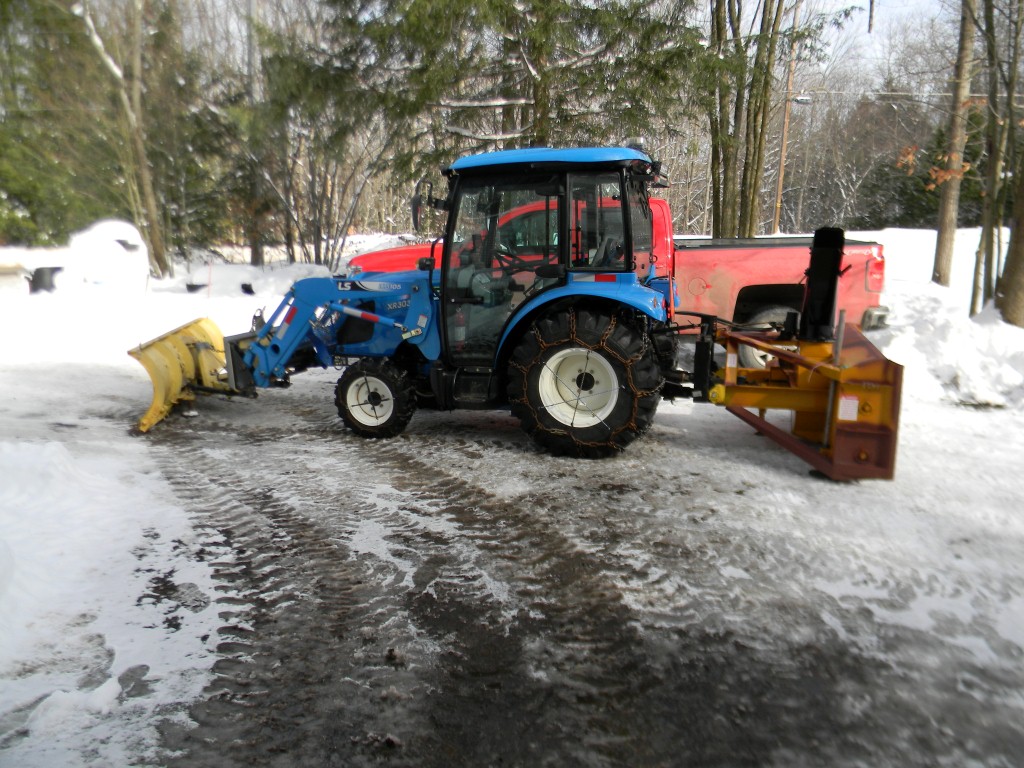

I have a 7 1/2' PA plow on the front and an 84" double auger blower on the rear. I'm in the snow belt S.E. of Lake Ontario and they do a fine job.

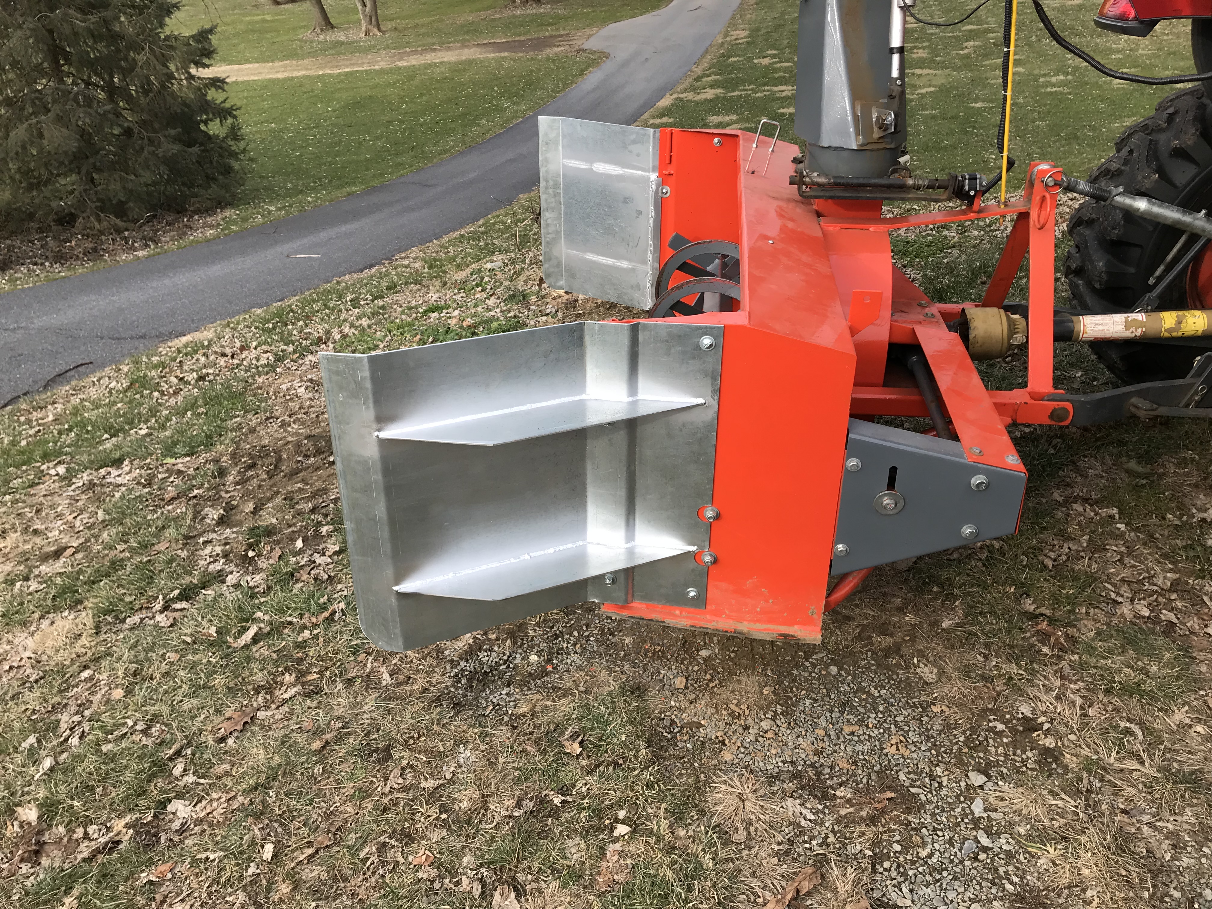

I widened mine to fit the bigger (L4240) tractor and used it last Winter. Although it's fun to throw a big rooster tail of snow, the 8' front blade on it outshines the blower so much that I plan to sell it with the L3200. For the places I clear the blower is a novelty more than a necessity. Not sure what to put on the back of the 4240 in that case. Maybe nothing or a scraper blade.
I upgraded from a L3200 to a L4060hstc, so I can really relate. The 60" blower wasn't super heavy duty so I figured upgrading it with wings might be a bit more force than it would take, especially on a heavier Grand.
The 8' blade has been decent enough. I really need to rebuild the mount with float as it's fixed. I like the compact setup on yours with the back of the frame up closer to the tractor. Palling on doing a similar build at some point.
We do get some big drifting here in Colorado at times so I still would like a blower. Photos include a 5 ton military truck as well as before & after pictures of a lifted F350 from the bomb cyclone this spring. I was able to dig things out with the blade in most cases, but it was super slow & a bucket would have been as effective. A blower would have chewed through things way better.20190314_123839.jpg20190314_133919.jpg20190314_163700.jpg20190314_143905.jpg

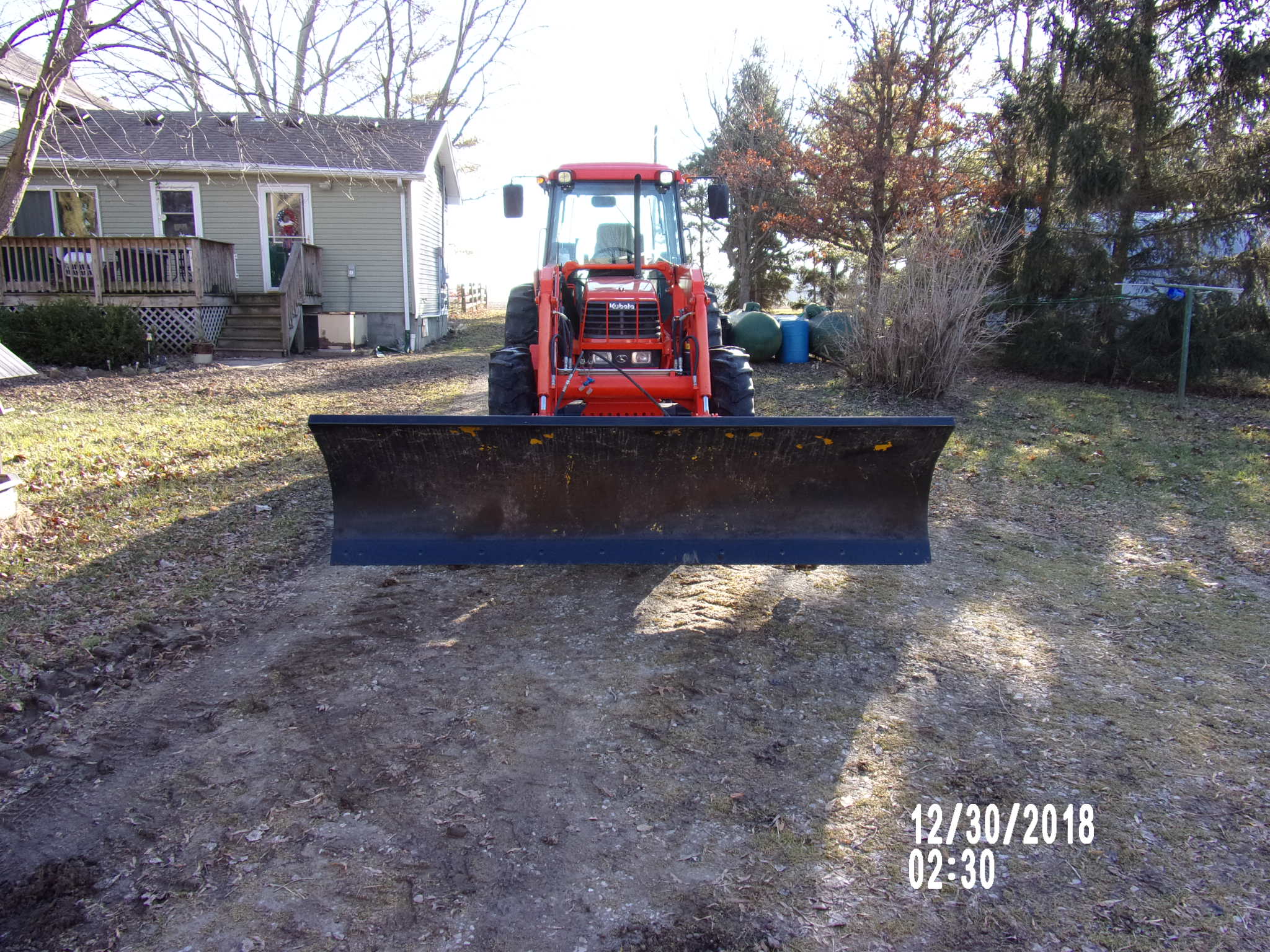

I have a mile long gravel driveway. We do not get gigantic snows( 14" or less ) and it does not drift here. My first tractor was a Ford 1700 4WD. It was not heavy enough to clear the berms that would form with a rear blade only. You don't clear the berms, on both sides of the driveway, with a FEL bucket. At least, not on a mile long driveway. So...I got a 3-point blower. Throwing/casting snow was fun. EXCEPT for the sore neck and shoulders.
In 2009 I upgraded to my current Kubota M6040. I have a uber heavy Rhino rear blade on the 3-point. The combined weight of the tractor - 10,100 pounds - plus the Rhino rear blade - I can now keep the driveway clear and full width.
Once again I enjoy blading snow on a cold, crisp winter morning. My Kubota is open station. So you will see me all decked out in Eddie Bauer down.
