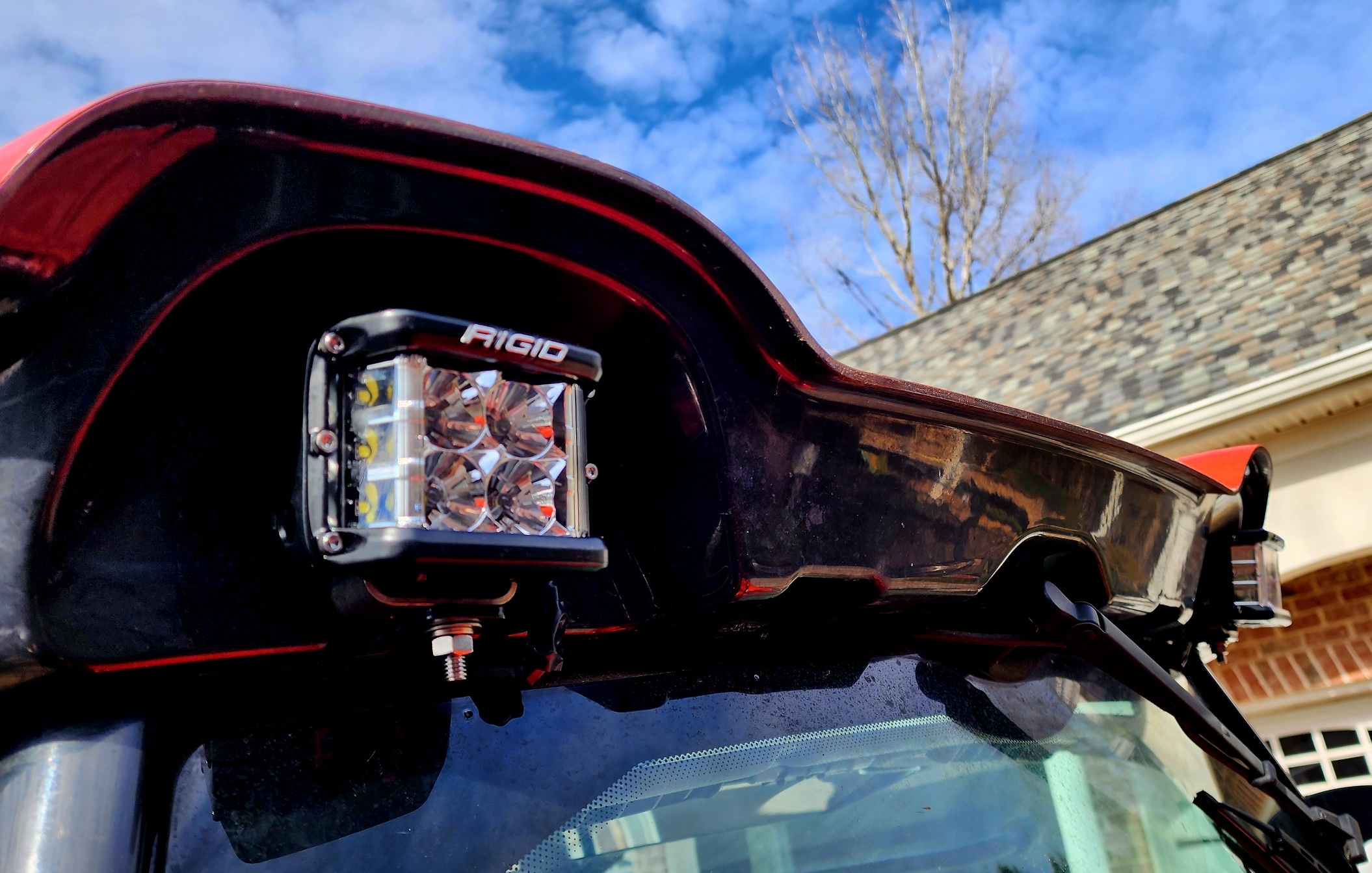

Going to blame @D&D for getting me thinking about the lack of light from the stock Kioti work lights and finally doing a few upgrades.
I originally upgraded the DK5310SE's headlights and work lights by swapping out the halogen bulbs for LED bulbs, it helped a bit, but the stock work lights were still too much of a spot light pattern rather than flood.

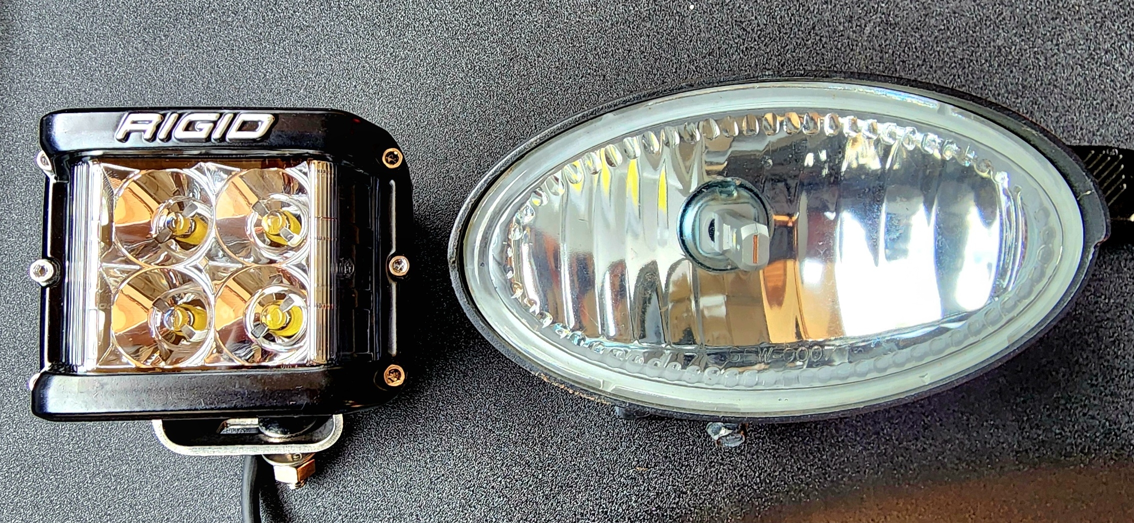

For the front, I went with Rigid D series SS 3" pods that have side shooter lights built in (Have some on my UTV and they've been great).

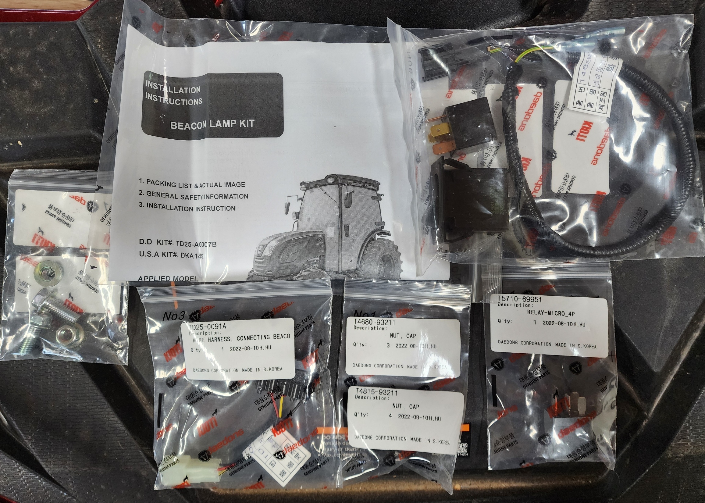

Then to add the side mounted pods, I ordered the Kioti beacon wiring kit (minus the beacon and post) and used the existing wiring to add the side-facing pods at the back of the cab.
I haven't decided if I'm going to replace the stock rear work lights yet, so this thread is just covering the new front and side pods.

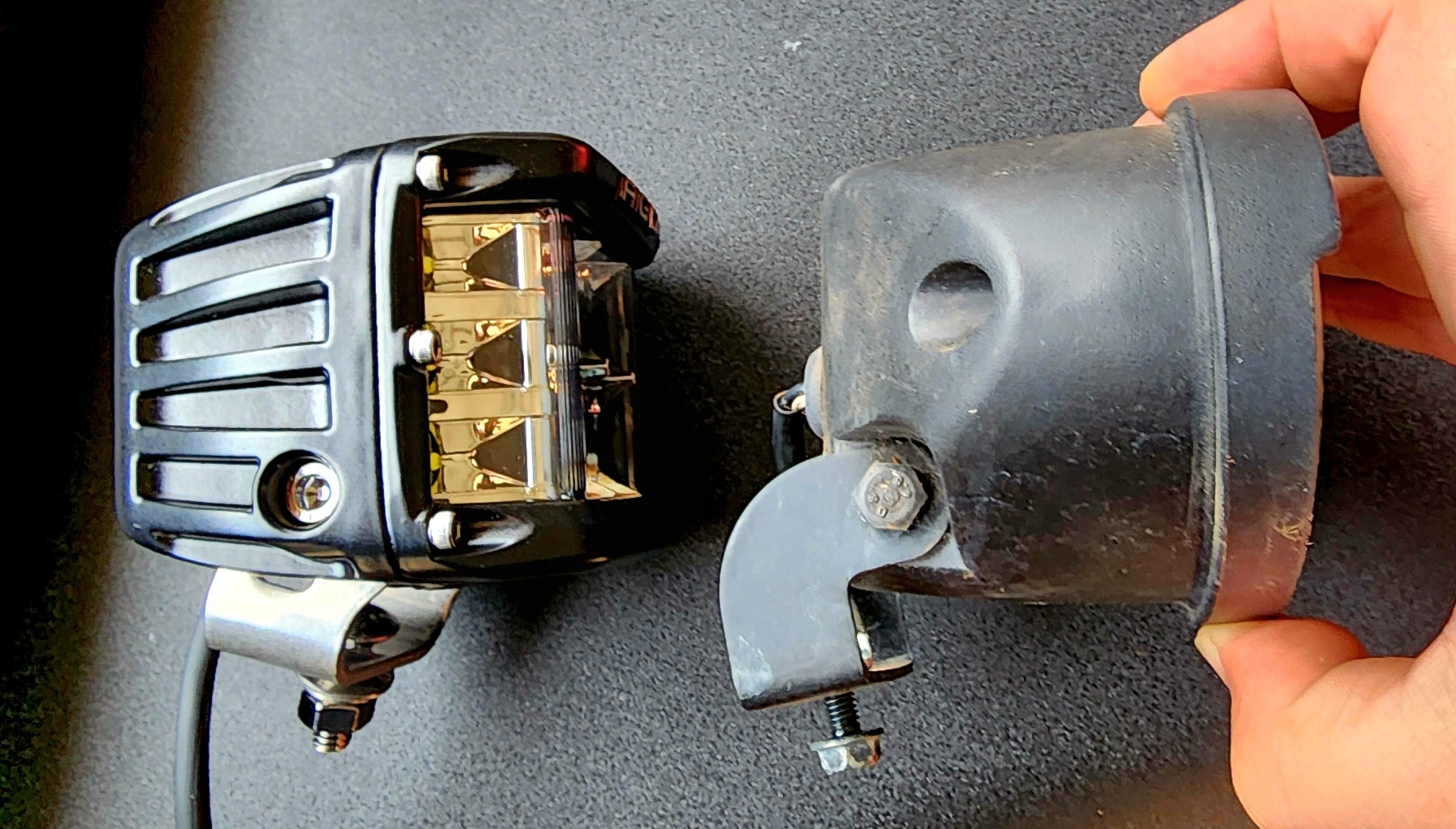

Front work lights, New Vs Stock:
Installed using stock mounting tab, no modifications required to fit:
The "side-shooter" LEDs facing the left and right sides provide light 120°, acting like a ditch light:

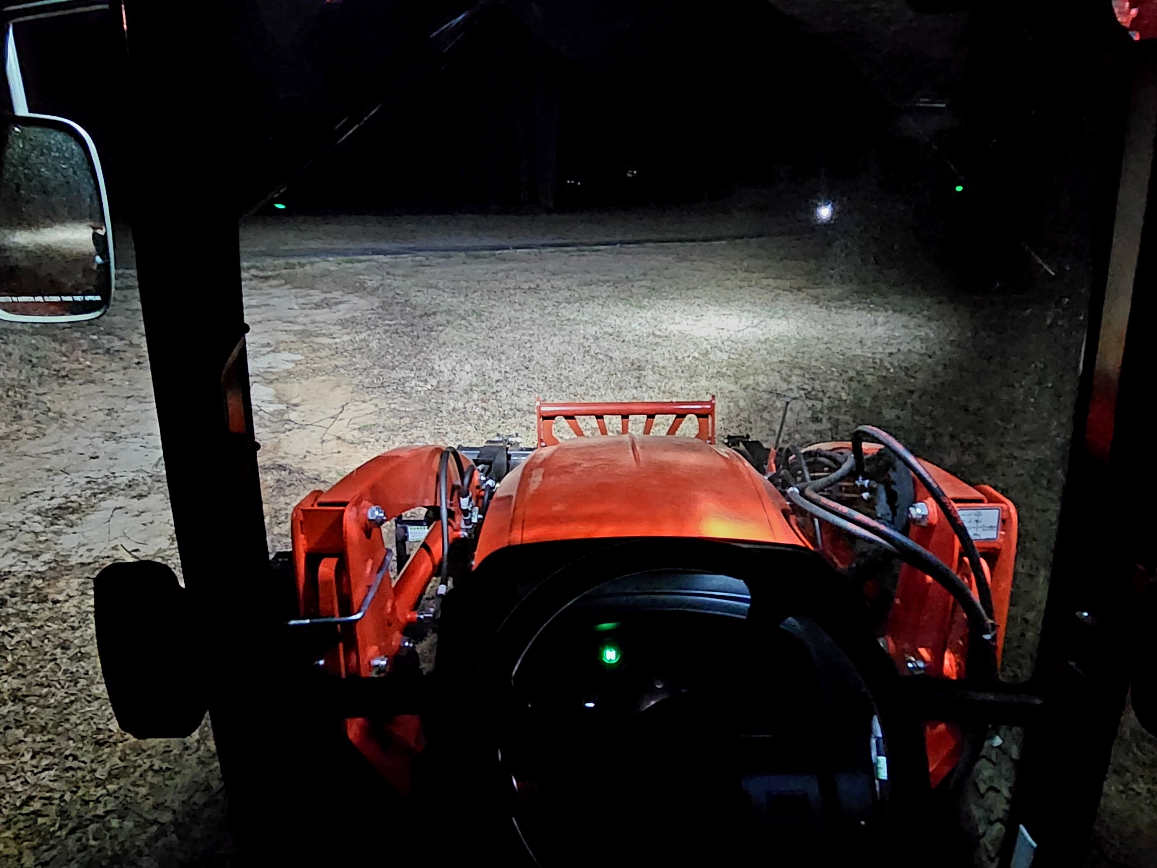

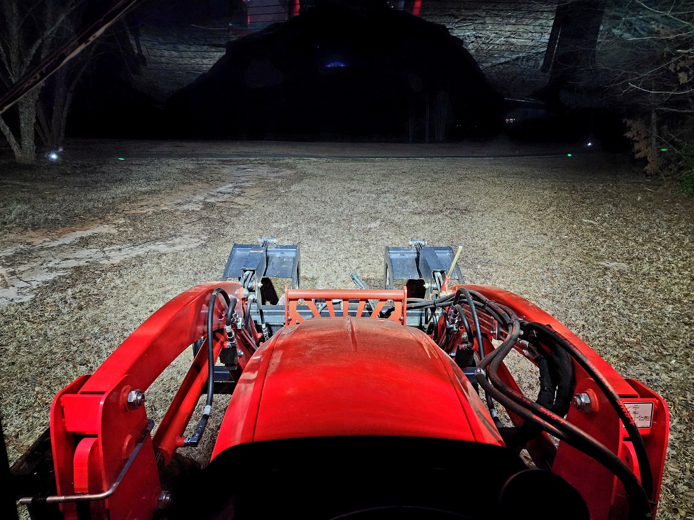

Light comparison using 1 new light on left and stock on right, huge difference:

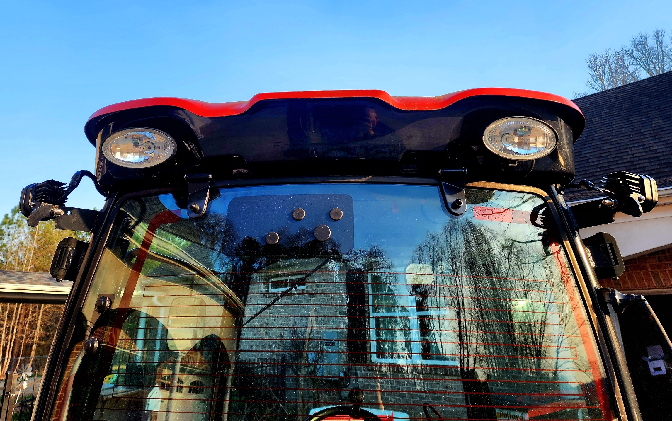

Both new front work lights installed, don't need the headlights anymore:

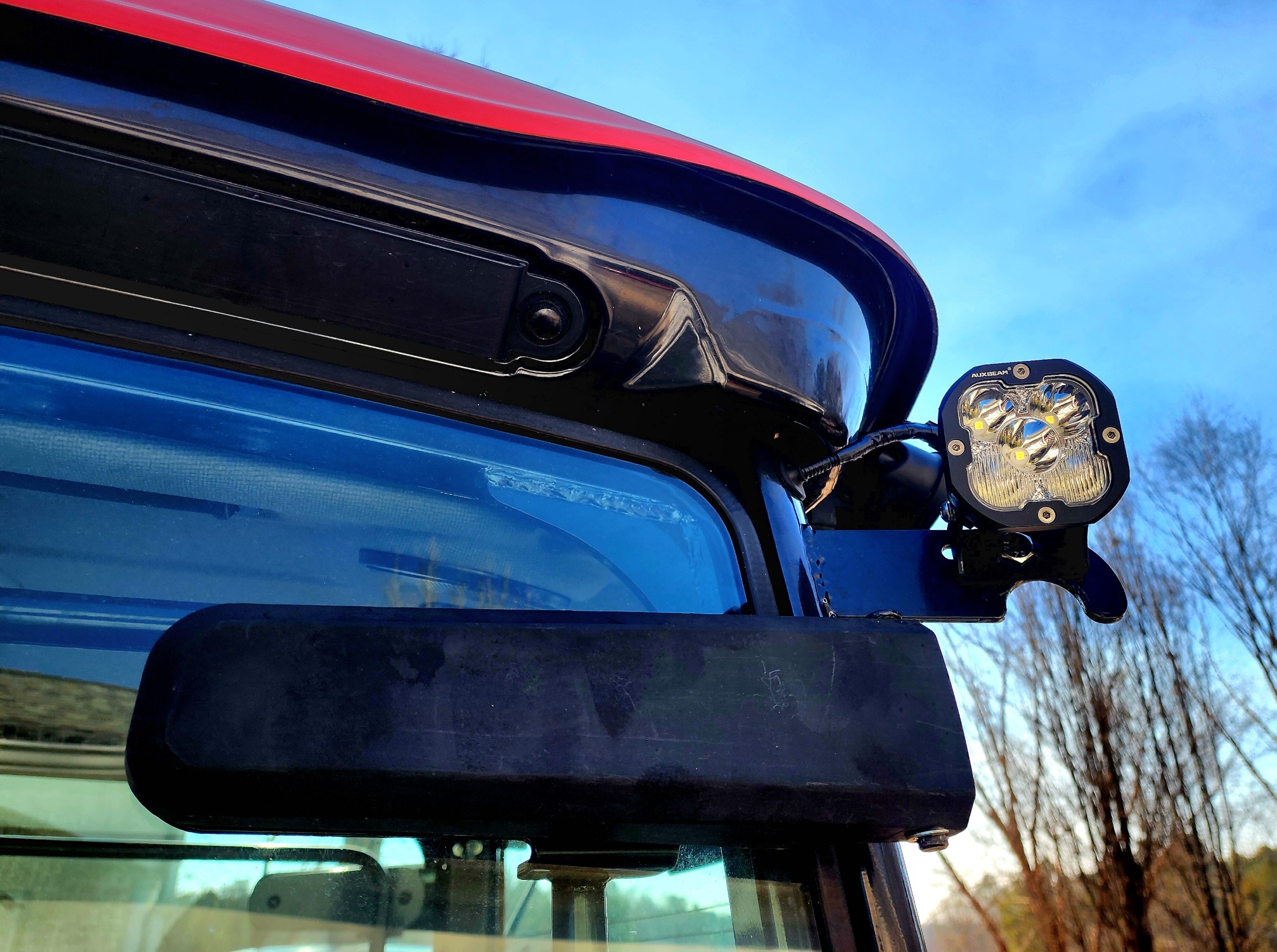

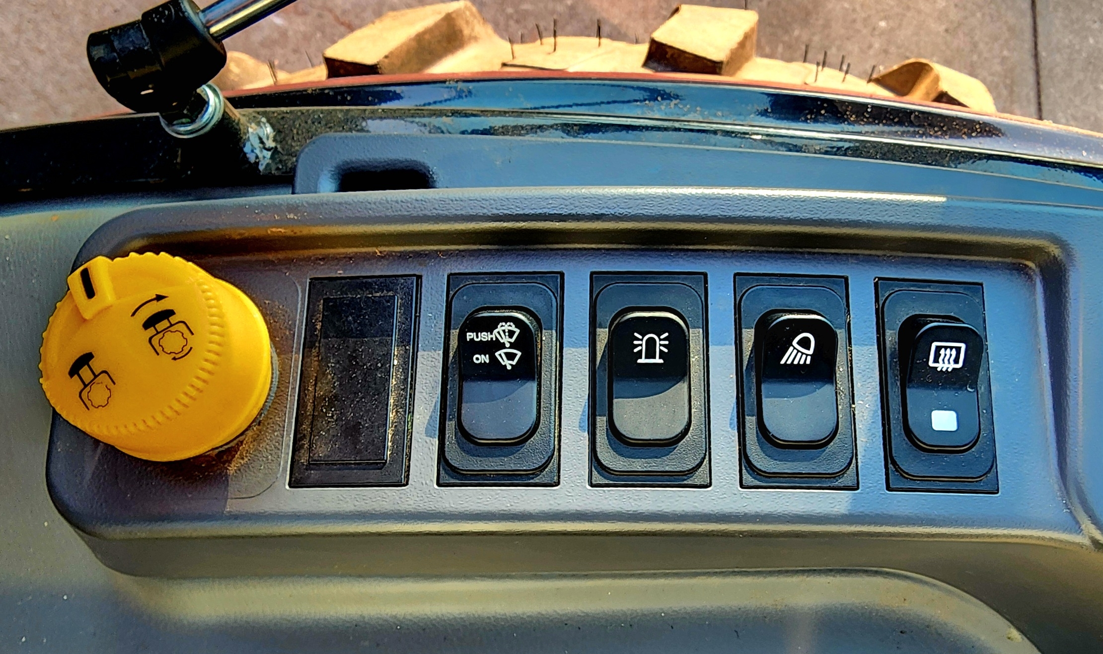

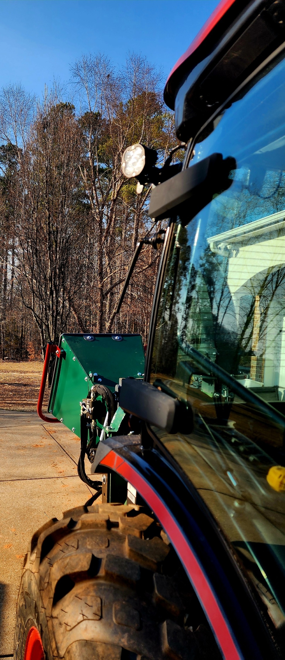

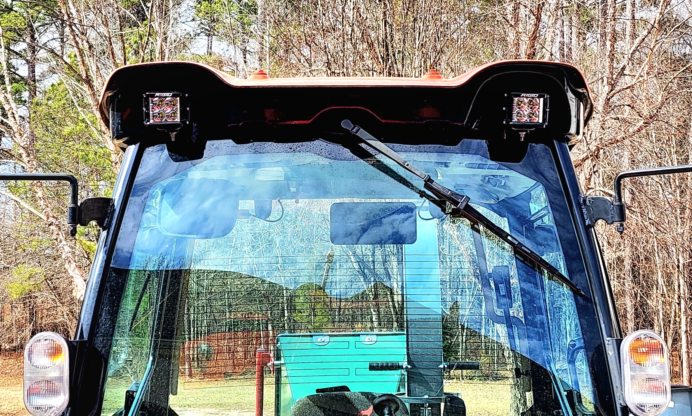

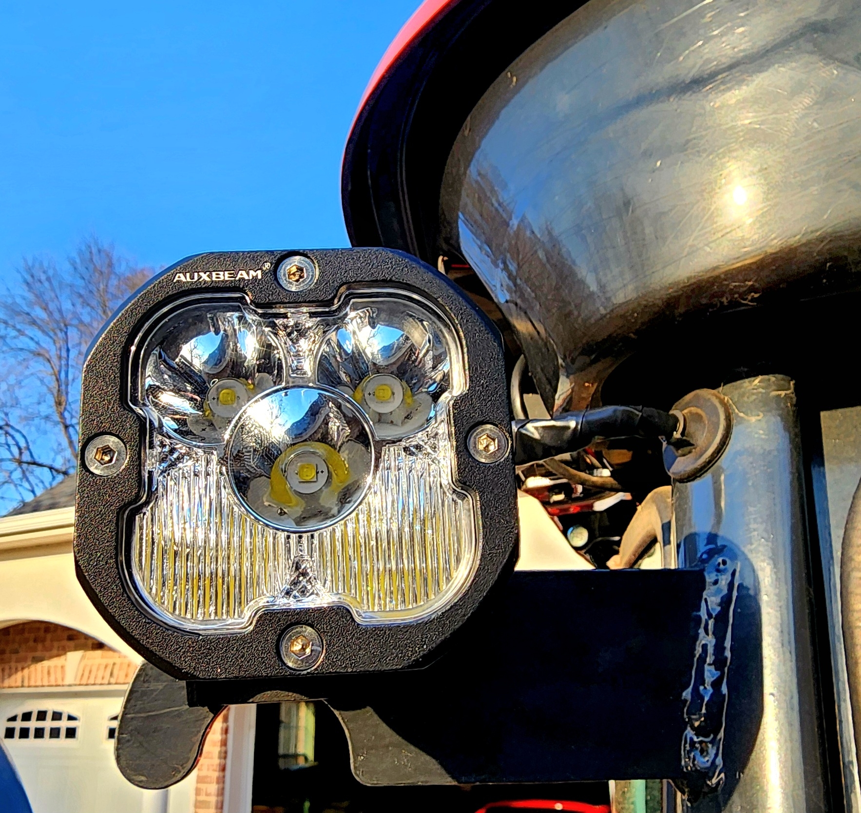

For the side facing Pods, I ordered just the Kioti beacon wiring kit, part number DKA149, which provided the 5-pin relay for the fuse box & the wiring to connect the switch to the existing plug on the harness under the switch panel. For the side pods, I used some AuxBeam 3" X-pro combo flood/spot lights.
Kioti beacon wiring kit:
Beacon switch from the kit added, plug-&-play connection to the main harness underneath with provided connection harness:
AuxBeam 3" pods mounted to the existing cab brackets & wired:

Rear view:
The side pods may need some further adjustment to prevent glare in the side mirrors, but will play with that when it gets dark later.
I'll probably upgrade the rear work lights as well, but that's a project for another day.

Was not me, I included the part number for the correct missing connector. The one that matches the one included in the top right hand baggy. From the looks of things, that would have saved 1/2 roll of tape. :LOL:
I do like the side shooters you mounted on the front. Nice job overall, can’t wait to see it finished.
Yes, you have. maybe you didn’t order them yet, but….
Haha, you just got me thinking about pulling the trigger is all, lol 😉
I was going to use the stock connectors, but it ended up being too long with the ferrite beads I added, so just did connectors, heat shrink and then wrapped with ET

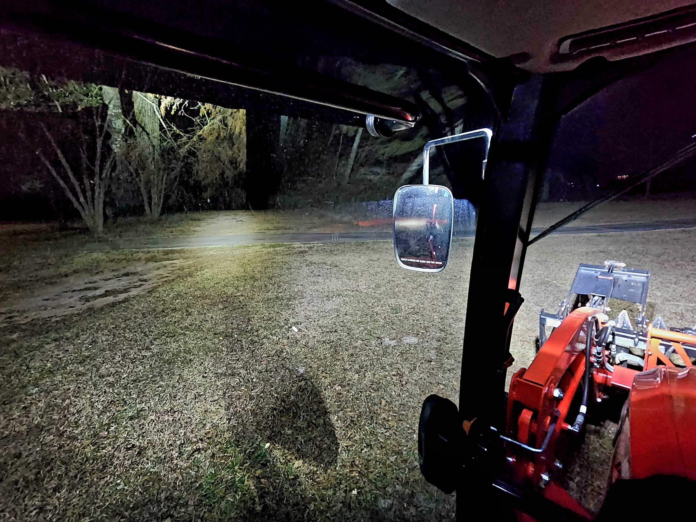

Side pods lights adjusted, but not a fan of these AuxBeam "combo" pattern lights; They're supposed to be flood and spot, but the spot is much more predominant than flood.

I really like the right vs left photometric comparison! It really shows that hot spot in the original light fixture.
