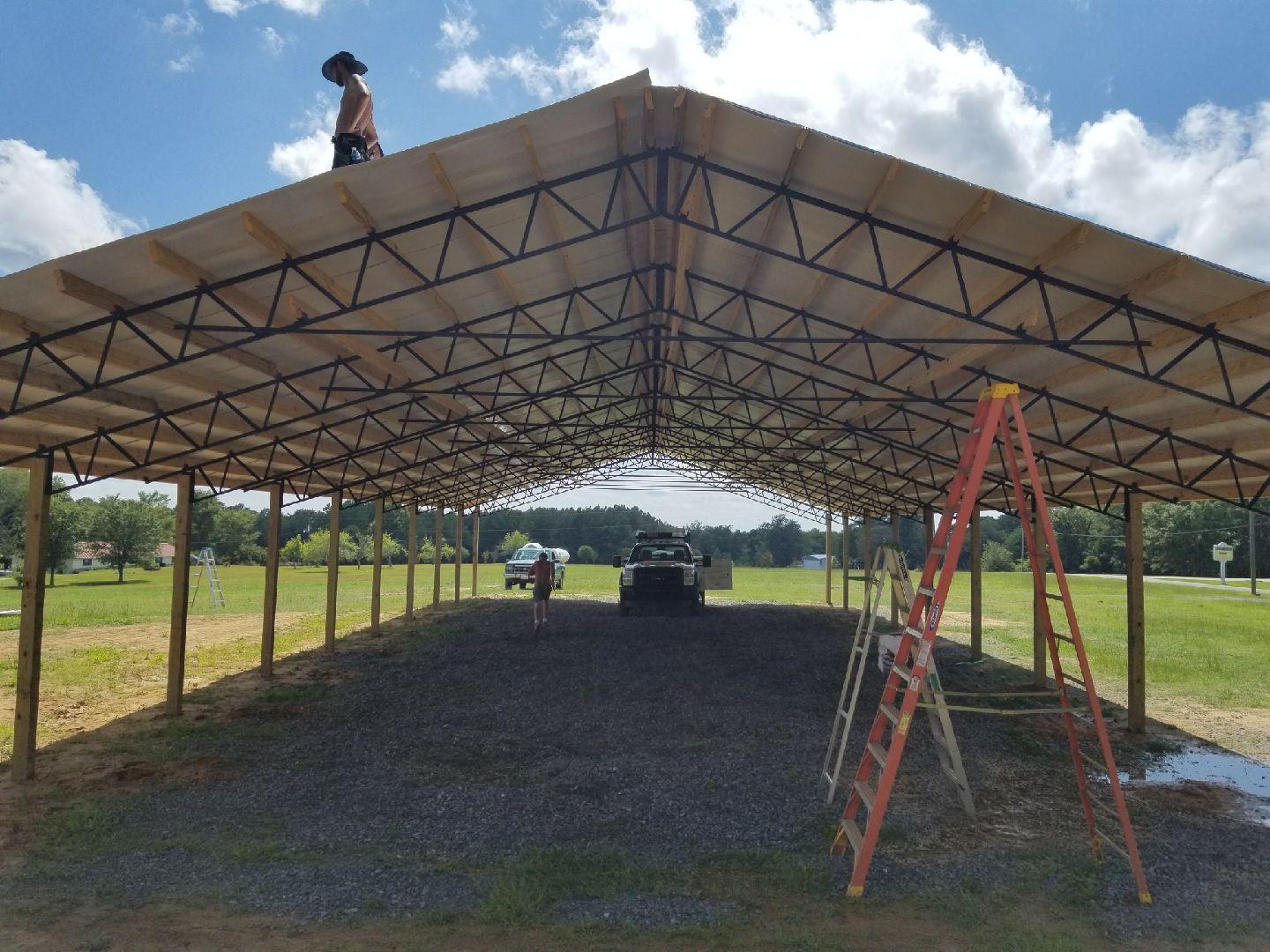

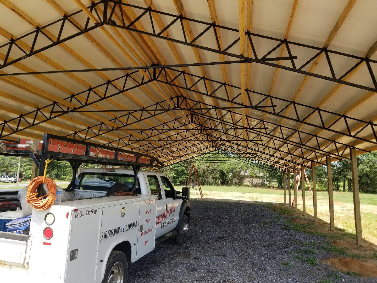

I like those trusses and the 2x4's for the roof are interesting. Someone knows what they are doing. I need to learn more about what you did.
The purlins are 2X6X10s.

You somehow have to get the frame braced before going any farther. That big of a building will move allot with no bracing even in a light wind. Builders will always brace the frame work as they put up the walls.and leave them up until they get the sheating or siding installed. As Loaderman 22 said...put the X braces on the inside of the frame that way they won't be in the way as you put the siding up. We all have a schedule we like to use in building, but sometimes what you plan to do tomorrow or the week-end can turn into a week or 2 later. Getting a building back to square due to racking is a pain in the arse !
Forgive the obvious newbie questions............is it okay to use 2X4s for the cross-bracing? If I calculate it correctly, I can cut 2X4X12s to 11'6" and 30 degree angles to fit. Then, do that at all 4 corners. Is that correct or do I need more? BTW, I don't remember if I posted any pics of the finished product.

2x4's are very strong used this way, I wouldn't even cut them, just hold the 12 footers diagonally and throw some 3" - 3-1/2" nails or similar construction screws in each end. Then bow the corresponding half of the "X" right over the other, doesn't have to be pretty, just on there good & tight. (Do NOT use drywall screws, they are not strong enough) Then you have 2x4x12's you can use later for whatever once your siding is all done.
This is the best image I could find quick on the ol' interwebs.

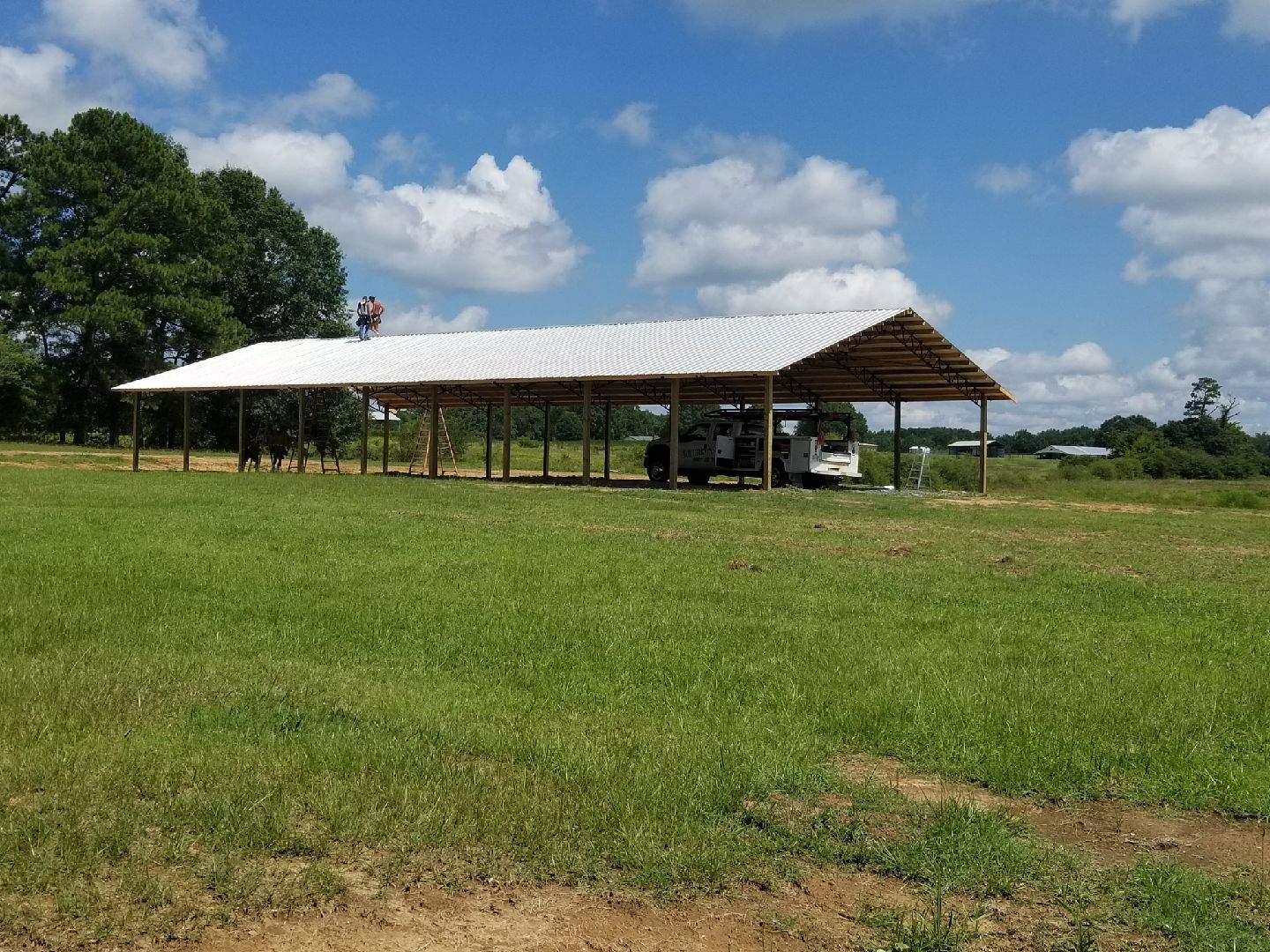

You don't give a location but those trusses look like the kind used in poultry house in East Texas. The building looks like it could be the beginning of a poultry house.

It's in Alabama and it definitely will not be a chicken house. The intention is to use this as an event center for wedding receptions.

BTW, not sure if I mentioned it but the State Fire Marshal called me this week and says they're now requiring architectural drawings for venues like this. They've never done it in the past but now they are. Caused me a couple of days of stress but I've located someone. There goes another unexpected $1,000.......

I’m sure it will be a beautiful wedding venue! The setting appears to be naturally beautiful. A lot of buildings share similar construction elements in basic design and construction.

Looking at the design of your building, the fact that the poles are set in the ground, and that the trusses are tied into the posts, and that the roof is already on, I see no reason to start adding bracing to this structure. All those components of the structure tie it together to hold it in place.
From what I've read in the comments, the confusion seems to be in how a stud wall is built, instead of how a pole barn is built. Think more along the lines of how a gazebo is engineered.
Diagonal bracing will reduce the amount of movement that you will have in the structure. Does it need this? Not at this time, because there isn't anything to worry about. No sheetrock, now doors or windows, nothing is going anywhere. Why install something that isn't needed? Once you build your walls and get your siding on the exterior, that will create more sheer strength then diagonal bracing. To me, the bracing issue is a distraction that doesn't need to be addressed.
Its called 'temporary' bracing until you get the siding or sheating installed. Then you take it off when siding is finished. To each is own....but I don't want the frame to rack back and forth while putting the siding on.

I understand the posts are in the ground, and they are quite stout & attached to the roof at the top, however if wind hits the roof at one corner and wants to twist the building a litle, then the little steel brackets holding the steel rafters to the posts can bend. A little temp bracing and that will at least limit the travel of the tops of the posts. Is it unnecessary, or overkill, maybe, I am not a structural engineer, but for the minimal cost of 8 or so 2x12's, I wouldn't want to take the chance. The higher up the top of the "x"s are mounted the better as the bottom of the posts obviously can't go anywhere, so it's the tops you are trying to stabilize. If you are going to use 2x6's for wall studs, you can use them for the blocking & just take them out as you finish a section & reuse them on the next. The remaining 24" off cut makes great blocking for the siding. You want to see how wind can effect things, watch a video of the Tacoma Narrows Bridge.

All the pole barns that I have seen put up in recent history have had more bracing than that, they have all had bracing going up from the uprights to the header on every post even though most of them had siding put up the same day as the poles went up.
At very least, I would put 1 or 2 2x4s on the inside of each end section. Either make an X at each end, or have them slant in opposite directions (ie: |\| | | |/|, |/| | | |\| or |X| | | |X| )
