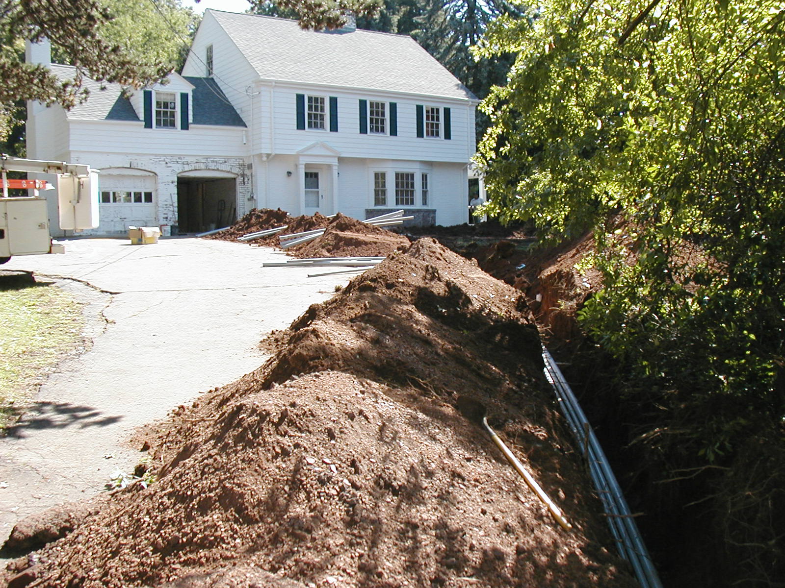

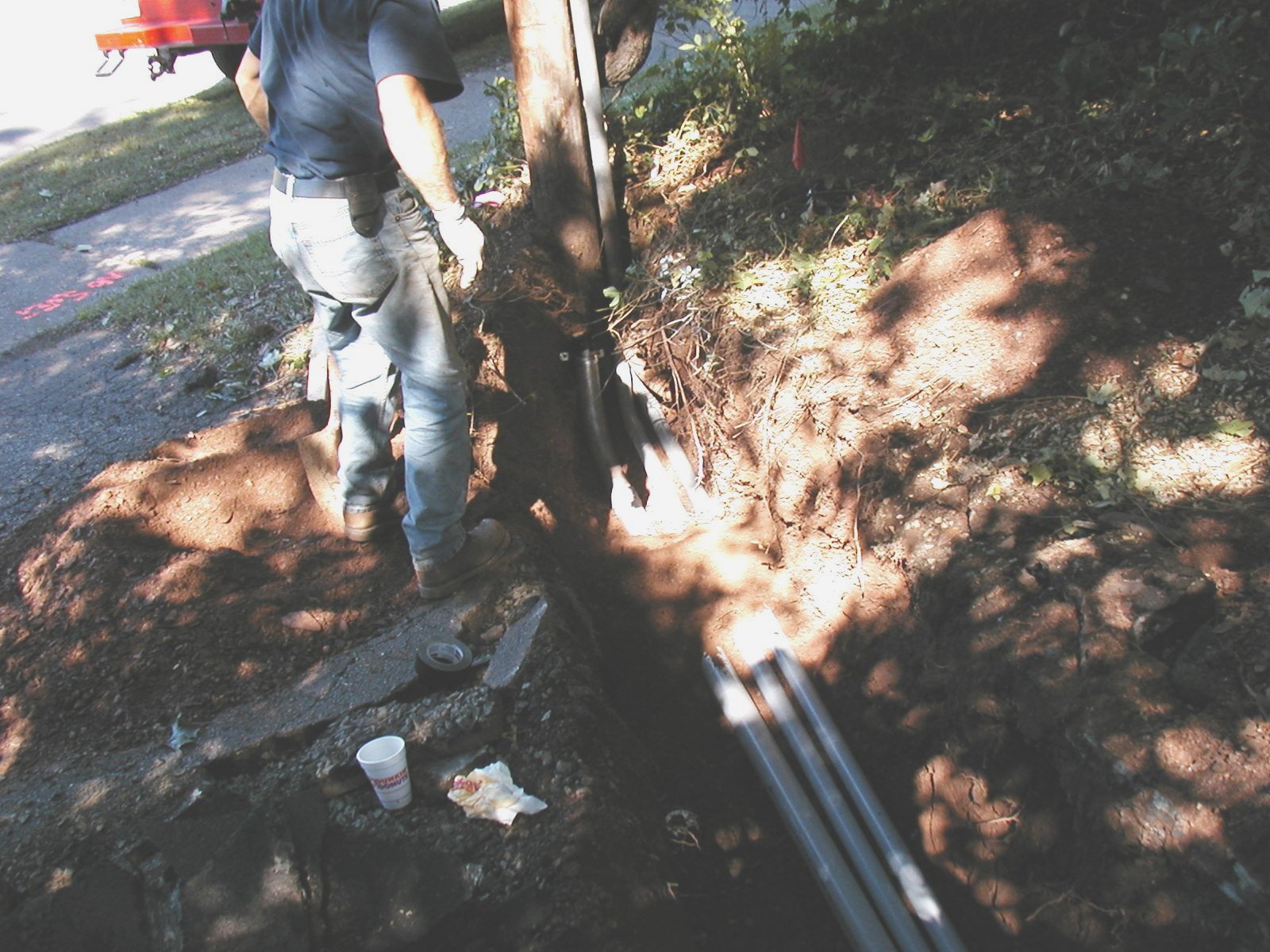

I've got both, My house which is 100+ ft from the street, has an underground 200 amp service in 3 inch pipe, I had it done when I upgraded 70 year old house.
My little shop in the back is 300+ ft from the street and has a direct burial separate 100 amp service which was done before I bought the property.
I'd prefer pipe but in your case with such a long run, I think that may have something to do with it, that would be a long pull.
Does the power company own the wire and replace/repair if needed?
In my case I payed the initial cost of wire and install to the house but they are responsible for it in the future, would be easy to change with it in pipe. I don't know who would be responsible for replacing the direct bury service to the shop.
As far as the fire hazard goes, I don't buy that reason, does seem possible, but conduit is used everywhere so it can't be such a concern.
JB.
