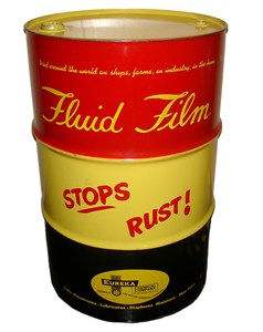

/edit - bought another 12 cans, the last dozen I think lasted me about 7 years.
I just can't yet justify the 55 gallon drum :(
sorry - on sale at Fluid Film Rust Protection
