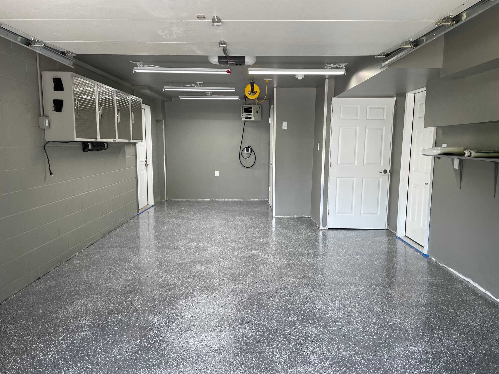

Anything that is homeowner applied ain't gunna hold up worth a :poop: . Commercially applied expoxy floors done by professionals are the only thing that's gunna hold up to car traffic and garage abuse. They range from $5 to $15 dollars a sq.ft. depending on the thickness and base material used. Google "Stone Hard" epoxy floors they have a good website with lots of pictures. We have their floors in some of our buildings and they hold up rather well.🍻
I have to disagree - I used a commercial grade epoxy but did it myself, and it looks the same as new years later. There is nothing a professional can do that a homeowner can not; it is just a matter of getting the right tools and putting forth the effort.
/ Garage floor #25
It also helps to know the "tricks of the trade". :cool:
/ Garage floor #26
What are you calling commercial grade epoxy? A proper commercial grade epoxy floor has a thickness of 3/16 to 1/4" thick material layer. The concrete is shot peened to remove the cream layer that is the top 1/16" of the slab to get down to the hard layer below. There is no way for a homeowner to even buy these products or to afford the tools to install them properly.
If you are talking about an epoxy resin that just sits on top of the slap that is just a coating, we are talking about two different animals completely. If you Google Stonehard Stone clad coating it has videos of the process to install it and if you watch, you will see why there is no way for a homeowner to install it. 🍻
/ Garage floor #27
It was straightforward to order my coating - it is a warehouse floor coating, and it landed at my door a few days after I placed the order. I simply went to the rental house, got a set of diamond bits, and rented a gas floor grinder. Cut the floor down with that, already had a respirator, and applied the coating over one very long day. It is a 3-coat urethane system (primer, color coat, clear coat) with an anti-skid additive and a flake. that had all kinds of "ratings" and is perfect after several years. It is overkill for a house garage, but I often drag some heavy steel items around and didn't want a floor that would get all scuffed/torn up.
A friend did his floor at the same time (figure we could both used the bits, etc.), and it is also perfect. It may not be the "Stonehard clad" you are specifically speaking of, but there are other commercial coatings that are also excellent products. Stonehard is simply a brand-name epoxy and urethane floor protection system. I also noticed some Stonehard listed on eBay currently if you really want to buy it and not have a "pro" install it.
If I recall correctly, I had about $1000 in doing my garage floor; the "pros" wanted $6,000. I agree they have some tips and tricks that are helpful, but for 5K I figured I could do my own research and figure it out. Honestly, it is some work, not really a fun job by any stretch, but also not exactly rocket science, just mainly a little research and labor.
Both Epoxy and Urethane coating can be great for a garage type of floor - neither is bad, and neither is perfect. Both are a slight compromise, but if you stick with the industrial/commercial coatings, you will do fine. The stuff at the big box stores is really what you need to avoid; it is made for a price point and a quick install. Also, without the proper prep, it doesn't matter what you put down; it won't last.
