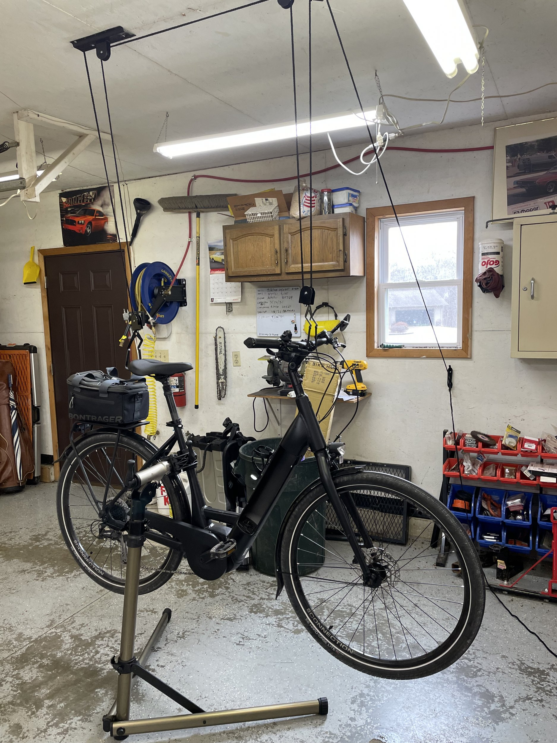

I used the Rustoleum product also, not great results. Prep is the key. My problem was I painted the floor with cheap floor paint, then I power washed that stuff off sort of, then put the Rustoleum down a few years later. If I were to do it again I’d go with the very high end stuff they use in aircraft hangers. My garage is 28’ x 30’ and the material to do it would be around $1000.
My problem was I wanted to move into my garage right away and use it and wasn’t patient. The picture is mine, about 20 years old Rustoleum floor paint, the paint that is missing is where tire tracks are from a car,
/ Garage floor #11
Yeah, mine was on new [but cured] concrete.

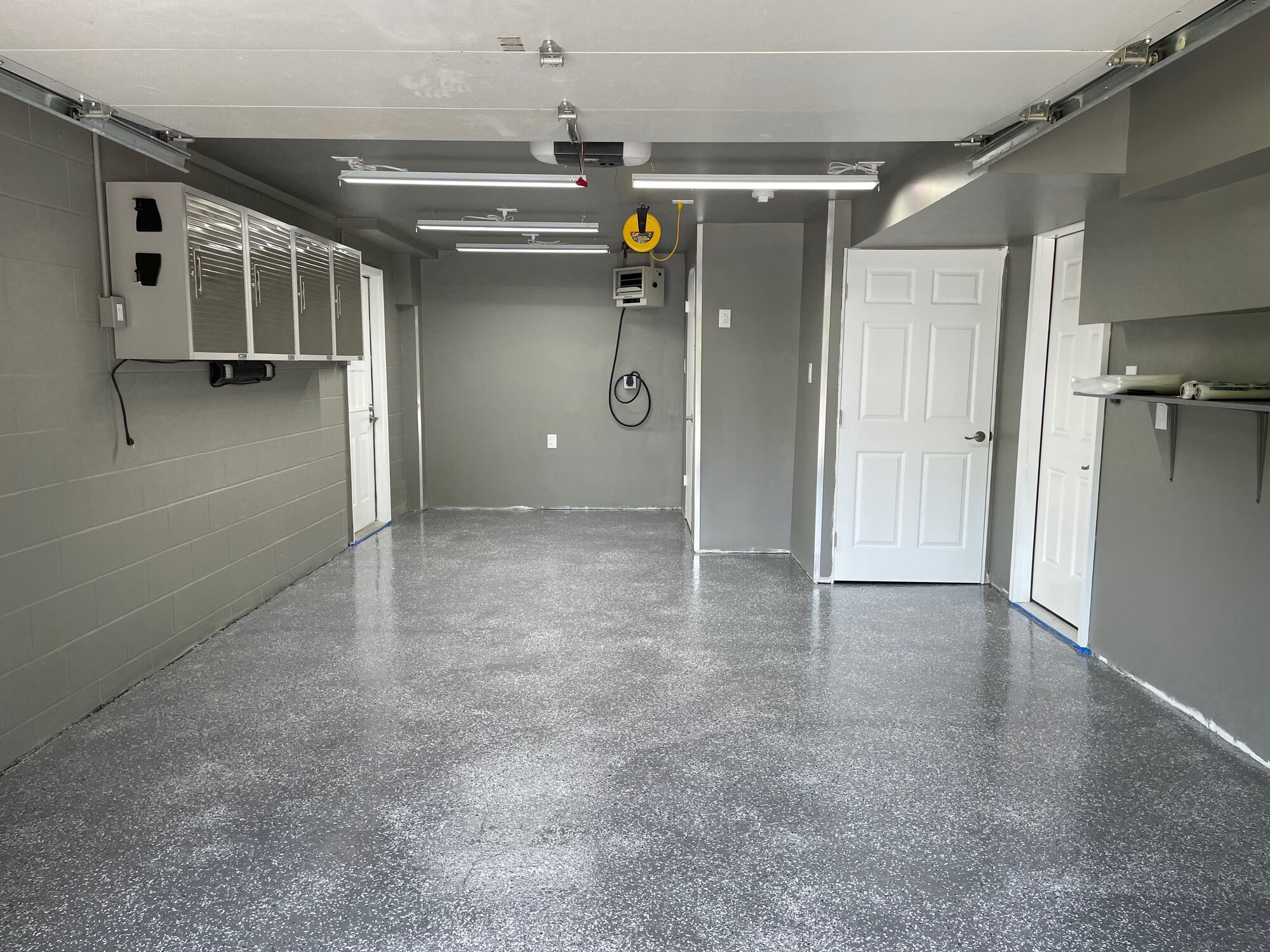

I used two part epoxy coating with chips. As said above, it's all about the prep. You didn't say anything about area of your floor, but mine was about 960 square feet and it was fairly easy to apply with the help of a couple of family members.

PLEASE skip all the crap from Lowes/Home Depot/Etc. Buy something like this - TruAlloy. If it is an existing floor start by power washing the floor, fill all cracks, grind it smooth (Walk behind Diamond grinder - the rental house has them, and here it was under $100 for the day), sweep the garage out, wash the floor, let dry for a few days, then only apply your coating (often multi coats). If it is a brand new floor of course you need it super clean and make sure the moisture is out before coating. The only thing that will hold up is a top-quality coating if you are parking on it or really using the floor. I did mine a few years ago and it is still perfect. A lot of work at first but it will last and won't need to be redone in a few years. Attached is a photo of the floor and it was cracked, had a drain line cut through it, and was really uneven or covered with old paint and stain. This photo was before the trim and such went in, but it gives you an idea of the floor coating look when completed. Prep and a quality coating are the key!
