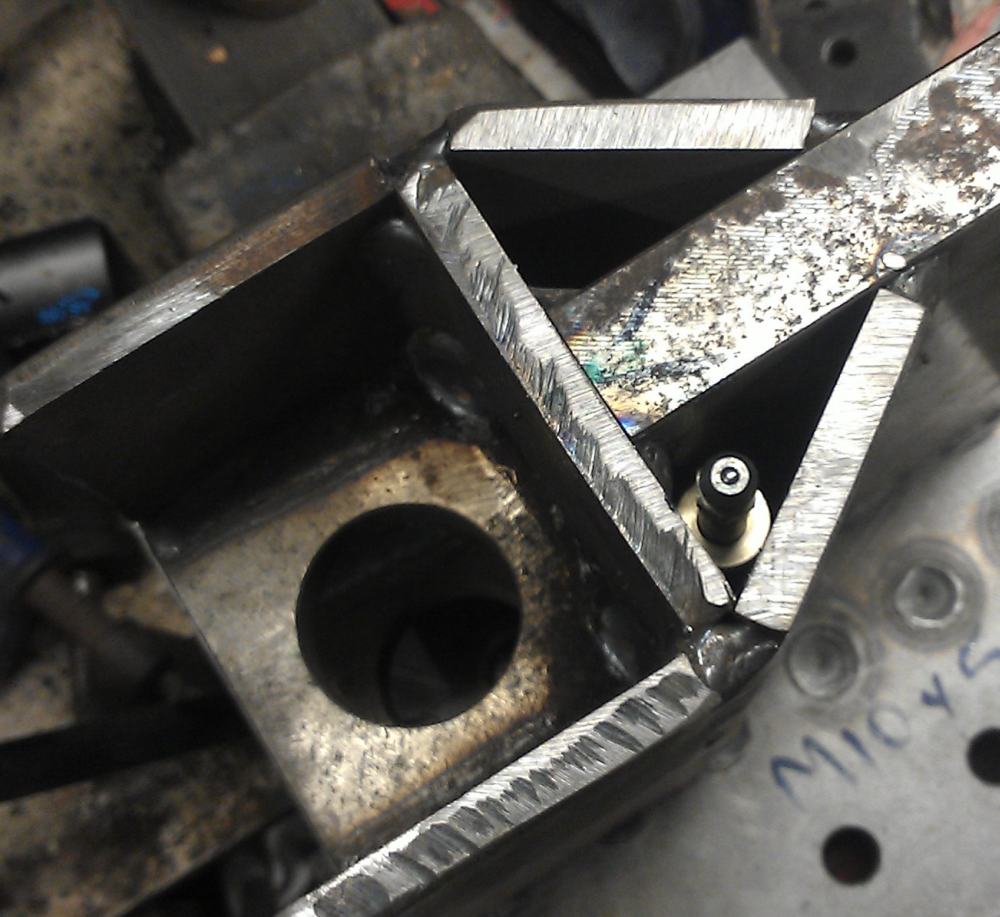

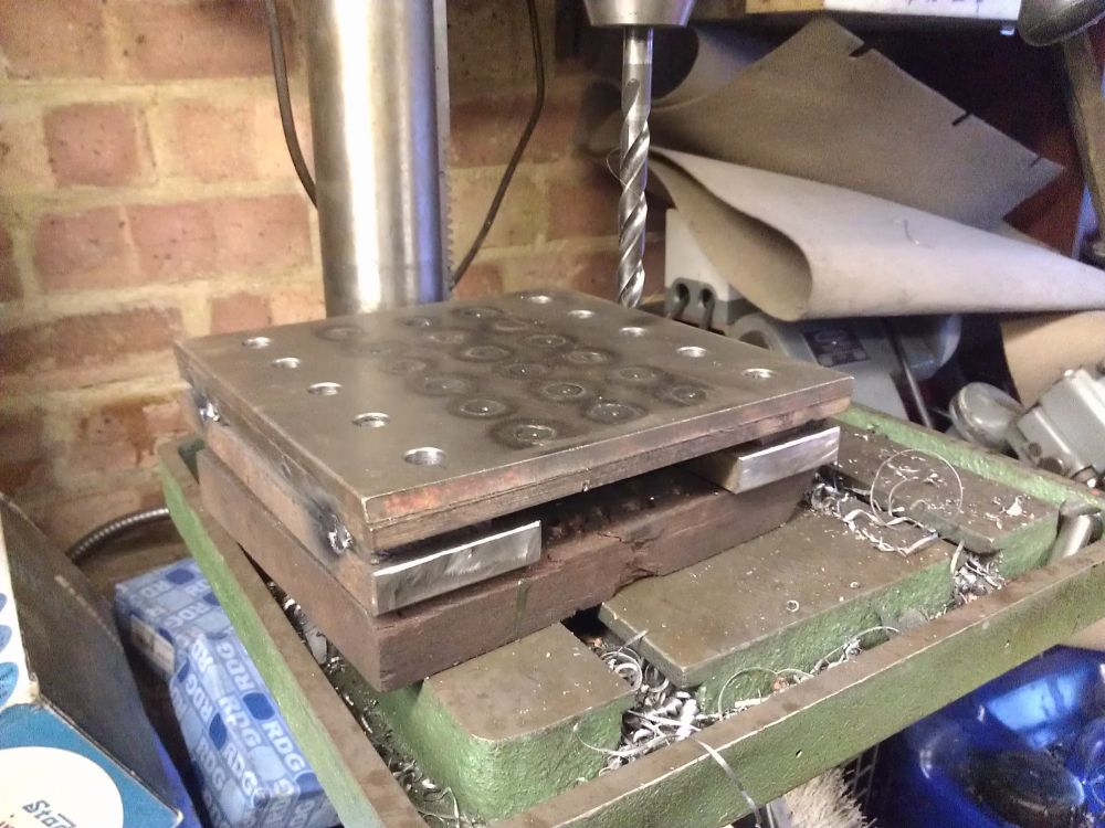

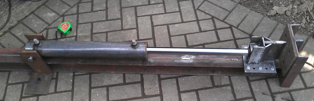

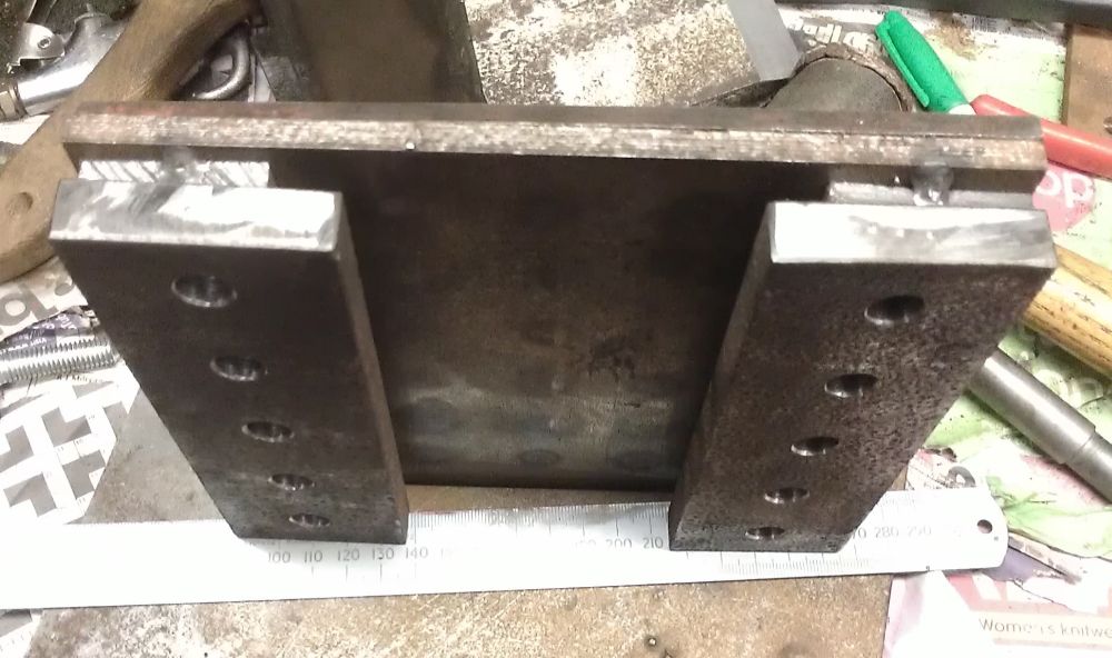

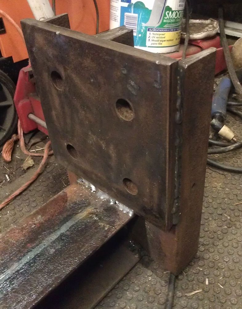

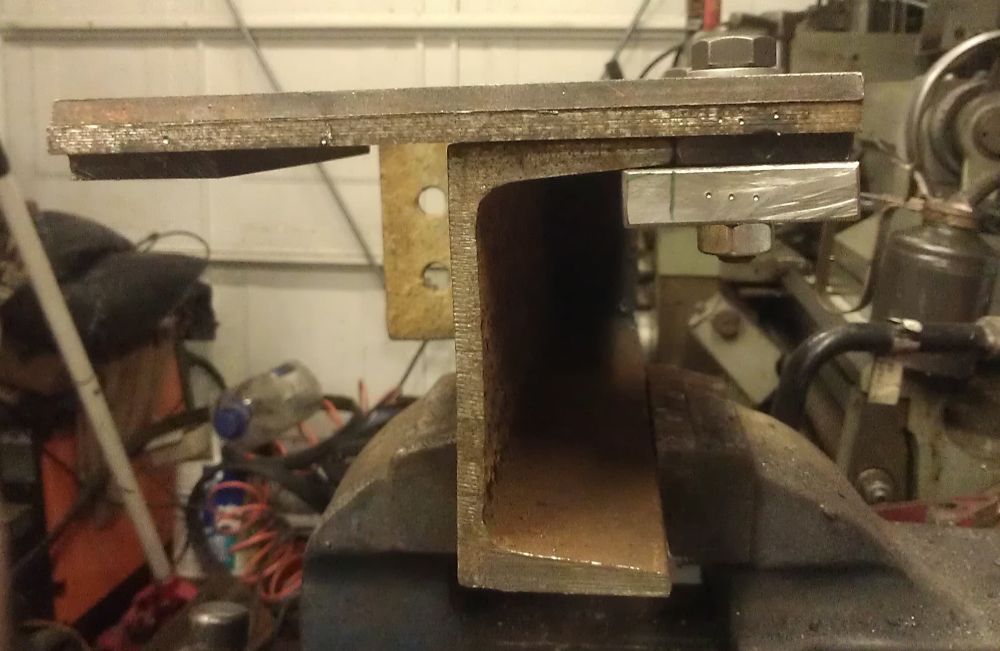

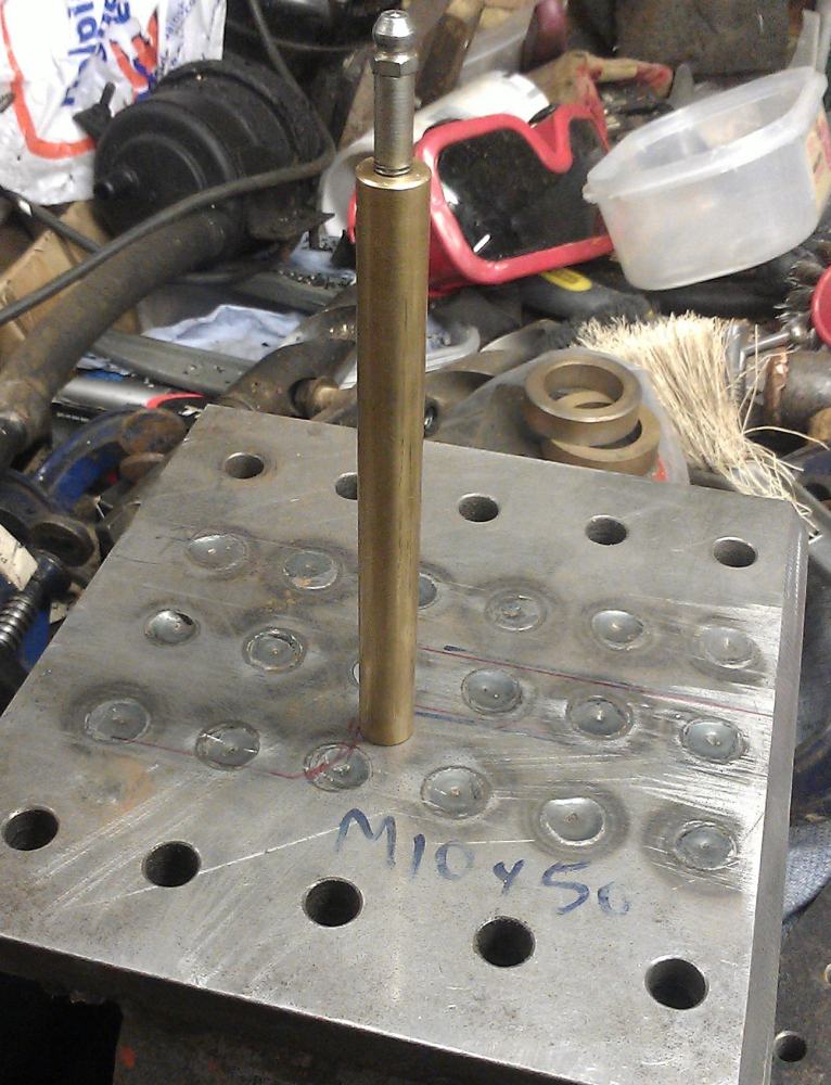

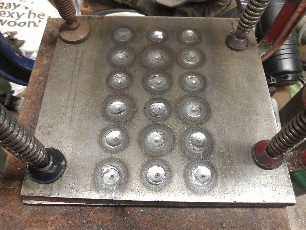

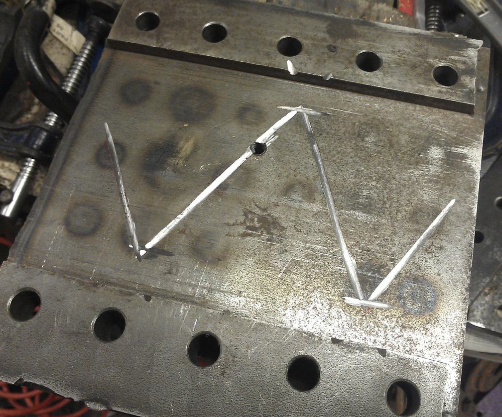

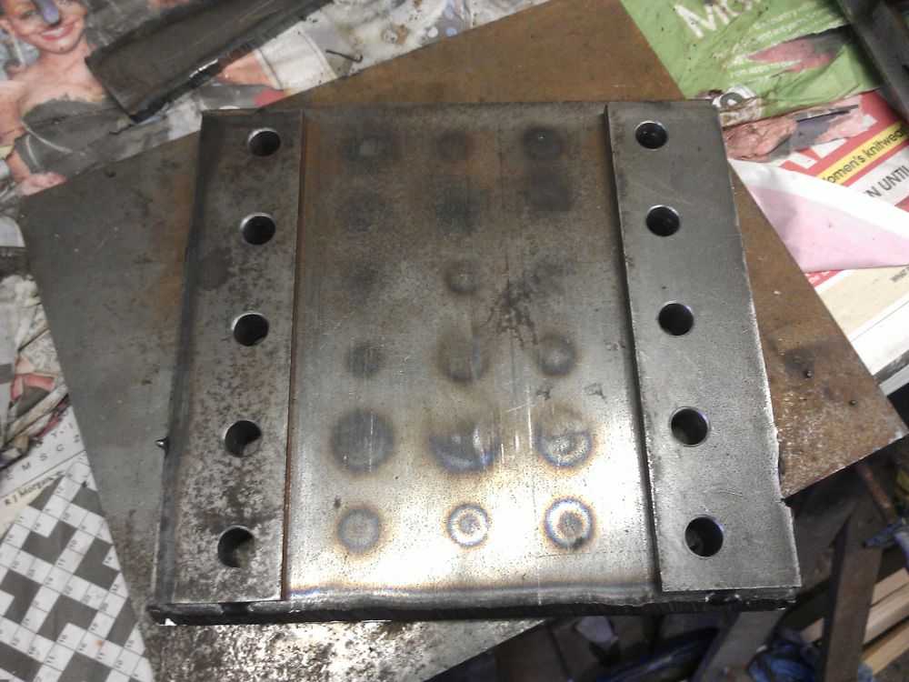

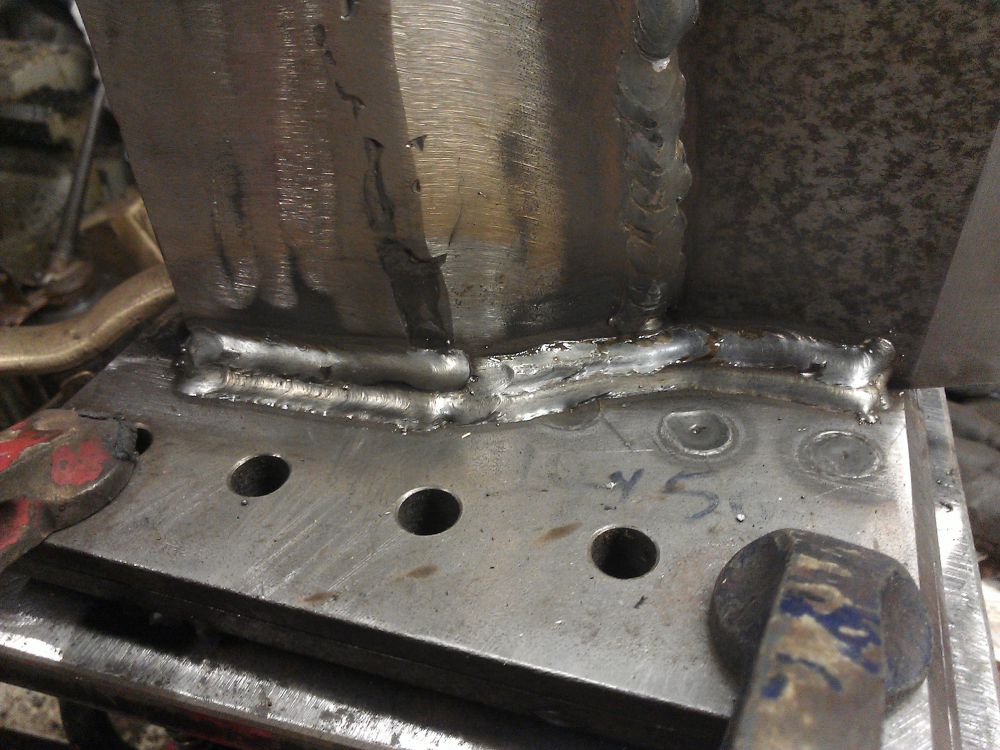

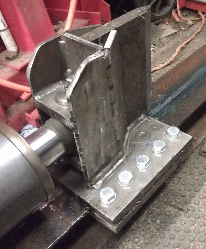

I've managed to get quite a bit done lately, just not had a chance to update this thread.
The wedge is now fully welded together and to the slider. The beams are now welded along their entire length too.
View attachment 309256 View attachment 309264

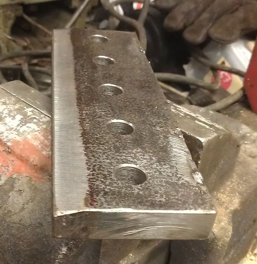

I made some precision chamfers on the slider clamps using the angle grinder :) The angle is a pretty good match to the inside of the beam.
The foot now has a nice thick lump of plate welded on to reinforce it. I still need to add some pointy bits to stop the log sliding off the foot.
The best news of all is that I have had the wedge running back and forth under air pressure. I shall put a short video on YouTube soon.
At 90 PSI I even managed to split some pine pallet slats. The movement is very jerky under air pressure, but no load cylinder extension takes about 2 seconds. If it's that quick under hydraulic power I'll be impressed, but I'm not holding out too much hope yet.
Good job!
The pusher is plenty stout but I would add some more rows of weld to the foot where it attaches to the beam. When splitting wood, it doesn't press evenly against the foot so when the wood is only touching the out most part of the foot it applies uneven force to that weld. If you can, Add some gussets underneath that don't interfere with the slider also. Been there.
Dennis

There are three runs of weld there, one in the root and a further two on top. In all I'd say there is roughly 3/8" of weld fillet. The plate is only 1/4" thick, so hopefully it won't be the weld that lets go :eek:
However there will always be room for improvement

And here a short video of the first run, albeit under air power.
YouTube link

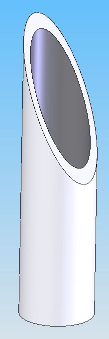

As you can see I had some help from CAD software to figure out the lengths and angles. I had to cut a 65 degree angle on each end of all four pieces of tube. I wasn't going to be able to achieve this angle on the power hacksaw, so I decided to cut the angle freehand with my 4.5 grinder and a slitting wheel.
While searching for tube mitring templates I came across this method, HOW TO-Pipe Template .
There are lots of calculators on the net for tube coping (where you want one tube to join another), but this was the only one I found that dealt with joining to a flat surface.
I drew myself a template on CAD and printed out full size onto paper, wrapped it around the tube to be cut and drew around it with marker pen. I held the tube in the vice and freehand cut to the line. Since I needed the same angle on both ends of the tube some careful measurement and alignment was necessary to match both ends.
First my template construction geometry, and the cutout template.
The tube with the template, then wrapped around, and marked with a Sharpie.
And the end result. Obviously this would have been a whole lot easier if I could have done it in the saw!
