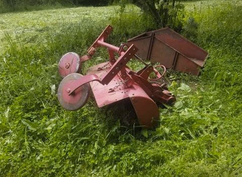

Here is a Mitsubishi model from the early 80s.

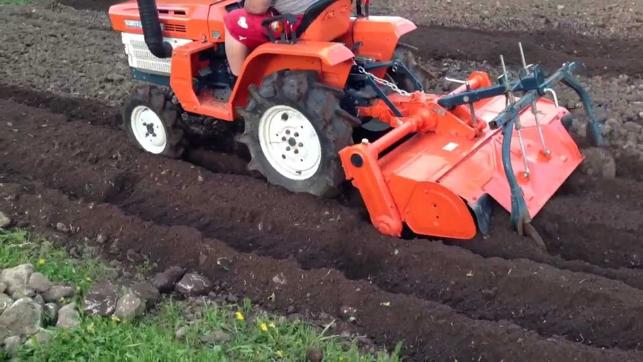

Here is a Kubota demonstrating how these work. This model can move the hiller discs inwards or spin to lock into position.

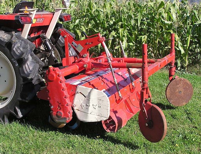

This is a fixed width, yet adjustable to rotate and lock into position on the Yanmar model.

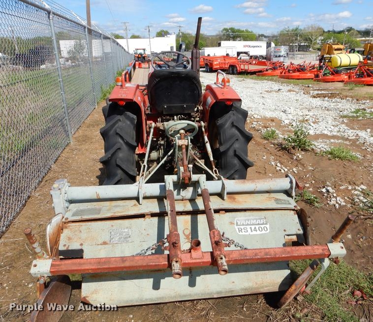

Yanmar RS1404 sitting on a gray plastic pallet.

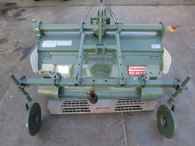

Yanmar RS1400 with sliding mount brackets to the beam for inward adjustment location.

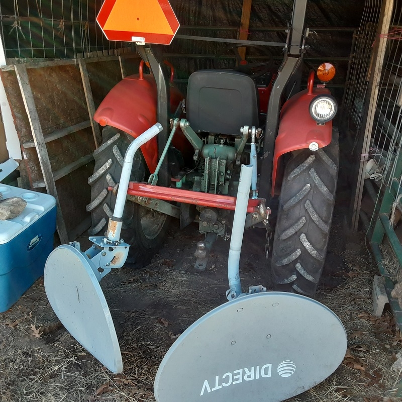

How did the DirecTV Hiller work out?
I have a good mix of sandy soil out here. I lay in wheelbarrow piles of barn manure out in the long plot garden beds from mid Fall into early Spring. Next run the disc harrow a few times between Spring rains.
When it's a nice suitable mix, I can hook up the DirecTV hiller and go at it at a slow pace. I had the hookup to work with my Harbor Freight QH. The dishes do flex under heavy loads when it's squeezing. The trick is having the right adjustment and angle. An easy way as these things have adjustments anyways.
The black bar is the rear bumper/frame off of a pop-up camper that was totaled in a rollover accident on the interstate. Its durable enough for the job.
