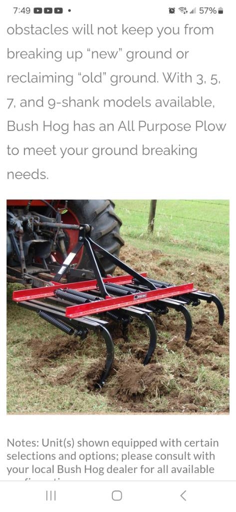

I've seen his inpliment before, but, what does the disc on the front do? It almost looks like when set straight, it almost is a gauge wheel?
   / A backwards disk chisel, (chisel disk?) to make food plots #32
It pierces the sod in advance of the chisels. Makes for smaller clumps. I always wondered if it would make more sense to have the chisels in front and angled disc gangs in back.

So, that APP is almost the same as what I got, although mine is an older Massey/Ford/deerborn/who knows. It does a good job, and actually is better heavy duty, as long as A, you going at a medium slow speed, and allow the springs to trip and reset; and B, you don't turn to sharp with then down. Replacement complete tine assemblies, with springs, rippers, and tips are like $111, so not cheap, but if you do need to replace 1, it's not the end of the world.
It should pull those rocks up towards the surface, for gathering, piling, ect.

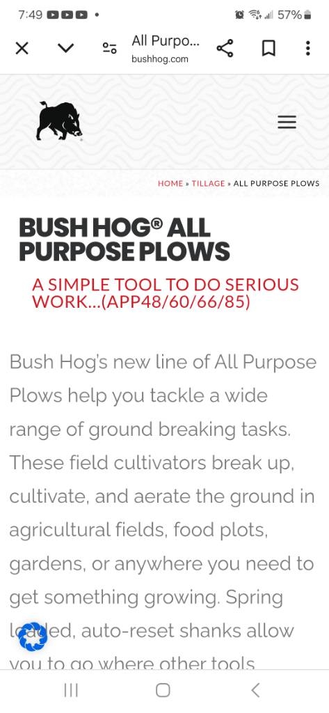

What is APP?
   / A backwards disk chisel, (chisel disk?) to make food plots #34
What is APP?
All Purpose Plow, Bushhog and maybe another Lienbach? call it APP

I haven't used mine in sod, just sand pasture that I think original owners goats ate the top layer of sand... but it did work well on pulling roots, and breaking the soil up. I could see the disc working in a heavy existing sod.
   / A backwards disk chisel, (chisel disk?) to make food plots #36
In my thread on mine, trying to ID it and parts availability, it was mentioned that some of the newer, lighter, ones use a narrower tine, and either don't have replaceable tips, or use a non standard through bolt. I'd have to go back, but I think mine are just under 3/4" tines, but some are only 1/2?
