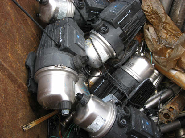

They spend a lot of money advertising those variable speed pumps like the SCALA. This is not because they are good for the consumer, but rather because the SCALA s the perfect "fluid" product, as it costs a lot and doesn't last long. On the false pretense of "saving energy" they trick you into the least reliable, shortest lived pump they make. Because of the complicated electronic controls in a VFD like the SCALA, they have an unbelievable failure rate. I hear from the supply houses that they are filling dumpsters with SCALA pumps that have failed. The SCALA has a worse failure rate than the MQ, which has been filling dumpsters for years. I will post a picture.
Let me say this again. Varying the speed of a compressor or any positive displacement pump can save energy. However, varying the speed of a pump with a centrifugal impeller always
causes more energy use per gallon pumped.

Wow! I've been using one of these Grundfos pumps for 20 years and have found it to a great, trouble-free pump. My boneyard is full of old cast iron jet pumps.
Grundfos makes really good jet pumps. But they have only been making the SCALA a few years, and the MQ hasn't been around that long either. Which pump do you have?
Sorry, I'll have to look that up. I moved the pump out to the well box and it is -31F at the moment and I don't want to open the well box to look.
I found it cheaper and easier on the pump to push water rather than pull water and the house is much quieter with that pump out of the house. Fairly certain it is the 1hp, 115volt MQ.
I have a Grundfos book from 2000 and it doesn't show the MQ. I guess they could have been around for 20 years, as time seems to fly by as I get older. But if you have an MQ that old it is the only one that has lasted that long. Most are short lived. Just search for MQ and you will find countless sad stories from people who have had a lot of problems.
