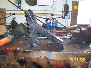

Feb 18, 2006 / TWIDDLING MY THUMB Thread Starter #41 OP escavader Veteran Member Joined Mar 1, 2005 Messages 2,320 Location western maine Tractor bx-23 , Here i welded up the thumb arm assembly Attachments 827866-thumb arm assembly (300 x 225).jpg 26.4 KB · Views: 366
Feb 18, 2006 / TWIDDLING MY THUMB Thread Starter #42 OP escavader Veteran Member Joined Mar 1, 2005 Messages 2,320 Location western maine Tractor bx-23 , another Attachments 827867-thumb arm assembly 2 (300 x 225).jpg 25.2 KB · Views: 317

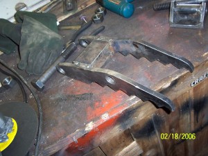

Feb 18, 2006 / TWIDDLING MY THUMB Thread Starter #43 OP escavader Veteran Member Joined Mar 1, 2005 Messages 2,320 Location western maine Tractor bx-23 , Heres the thumb arm pin holder.It will be the first thing welded on the tractor Attachments 827868-pin holder hinge (300 x 225).jpg 21.6 KB · Views: 340

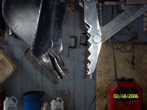

Feb 18, 2006 / TWIDDLING MY THUMB Thread Starter #44 OP escavader Veteran Member Joined Mar 1, 2005 Messages 2,320 Location western maine Tractor bx-23 , Dry run on the bench,ok shes ready Attachments 827869-dry run on bench (300 x 225).jpg 26.8 KB · Views: 349

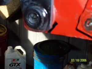

Feb 18, 2006 / TWIDDLING MY THUMB Thread Starter #45 OP escavader Veteran Member Joined Mar 1, 2005 Messages 2,320 Location western maine Tractor bx-23 , Got the tractor in the garage.Made a mark with the bucket curled up completely so i wouldnt get it too far forward Attachments 827870-drew a line (300 x 225).jpg 17 KB · Views: 353

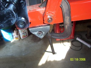

Feb 18, 2006 / TWIDDLING MY THUMB Thread Starter #46 OP escavader Veteran Member Joined Mar 1, 2005 Messages 2,320 Location western maine Tractor bx-23 , After un hooking my battery,iI clamped it on,and welded it.If you recall i was gonna clamp it on,then i got lazy /forums/images/graemlins/grin.gif Attachments 827871-pre welding (300 x 225).jpg 21.5 KB · Views: 336
