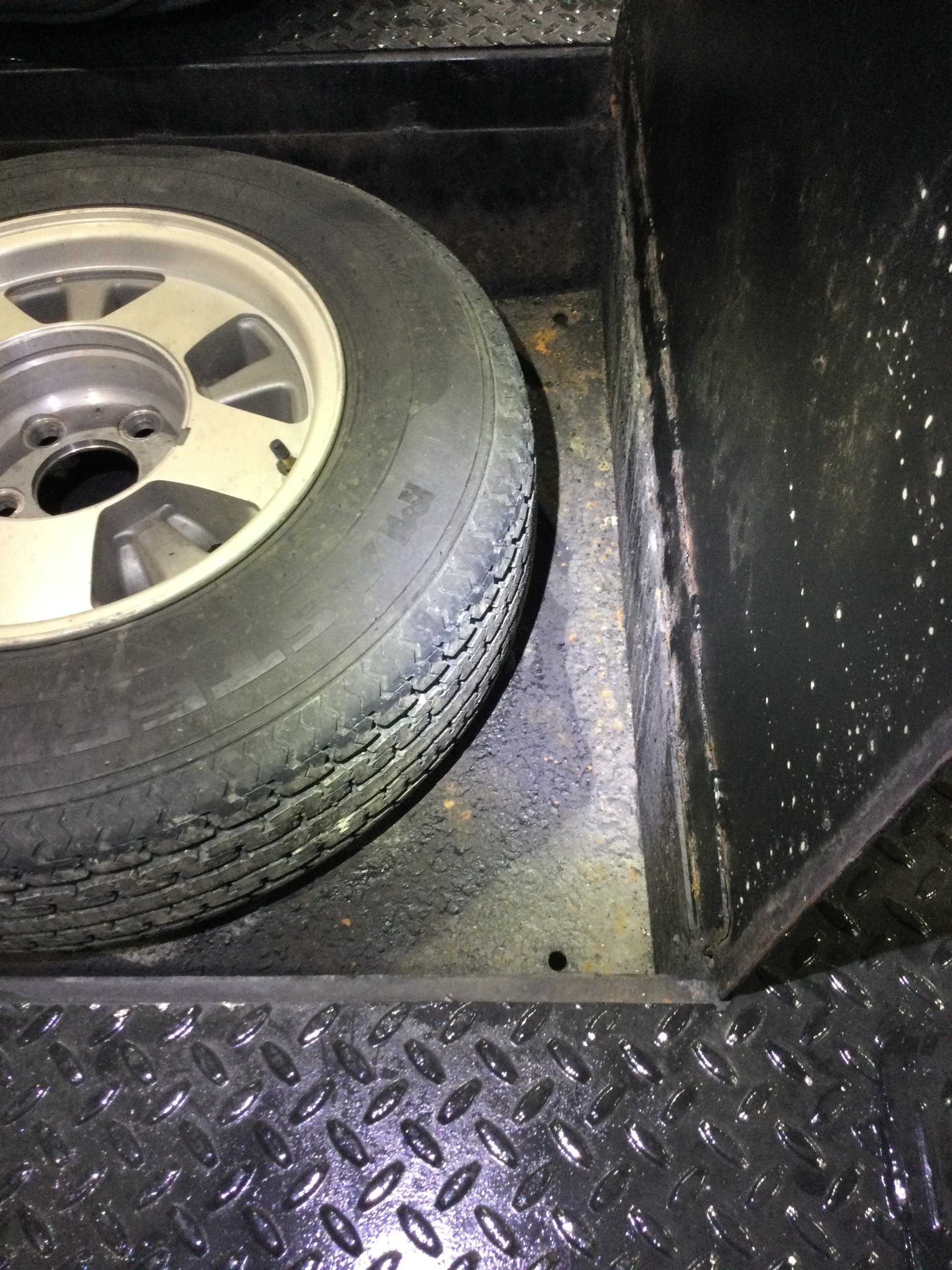

That works until it does’t. Only reason I mentioned it as I did the same thing for my car hauler spare tire, that sees much less debris than my tractors and if it didn’t spend a lot of its life under shelter, it probably would have rusted out by now.
No single item can fit through the cracks large enough to stop up the holes but before too long they are clogged.…
