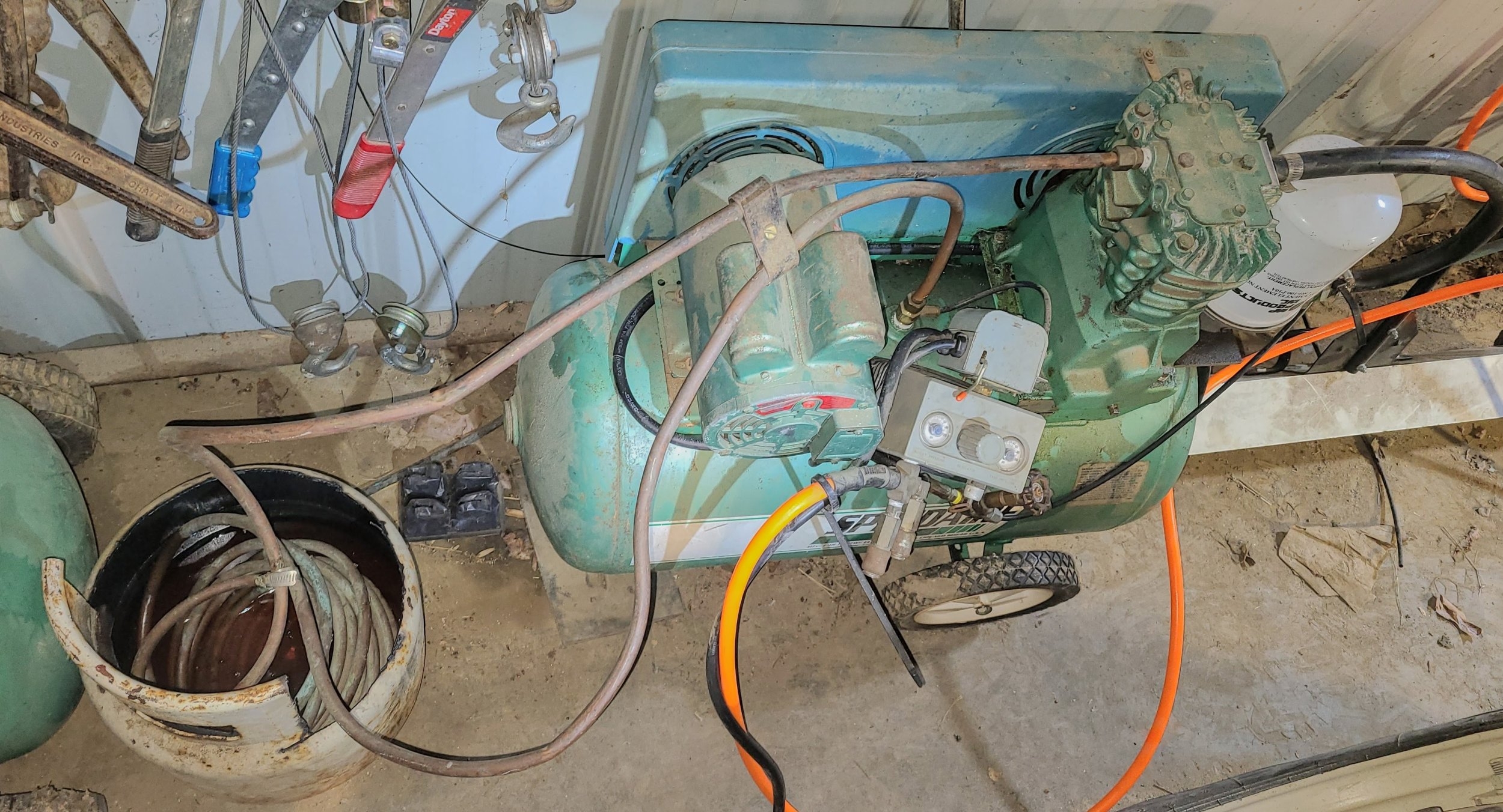

Twenty years ago, I built an air cooler for my 4HP compressor, the concept was to try to find a way to get moisture free air for the plasma torch.
So, I went to the local scrap yard, and bought a 50 foot coil of 1/2" copper tube (because that size matched the fittings on my compressor).
I re-coiled it to fit in a 5 gallon bucket,, and connected it to the compressor. The bucket was filled with water.
I kept water in the bucket, it worked OK, some days of long use, I had to add some cool water to the bucket, the excess ran out the garage door.
Recently I replaced the plastic bucket with a steel retired propane tank.
no rocket science,, hot air out of the compressor goes in the water cooled coil,, cool air returns to the tank.

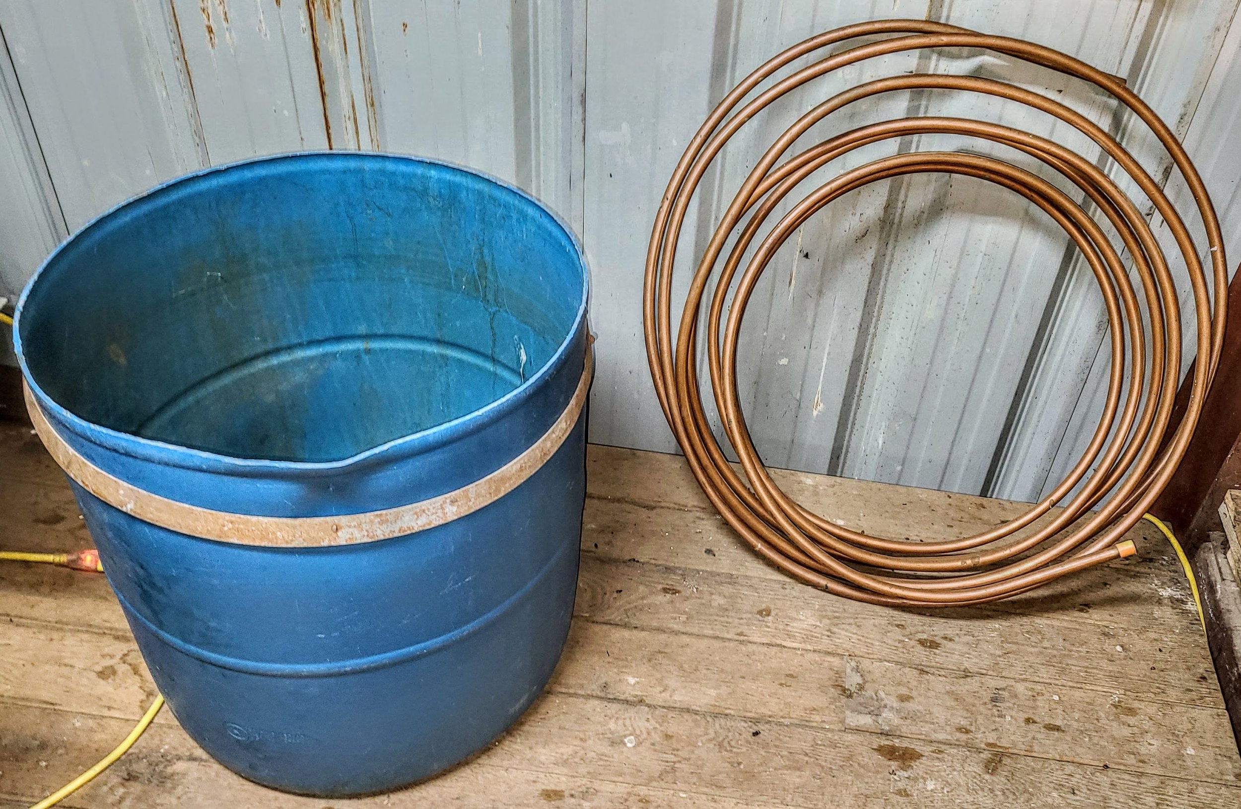

Here is the 3/4" tube as it came from the scrap yard.
The plastic barrel will be the water container,, it will hold between 15 and 20 gallons.

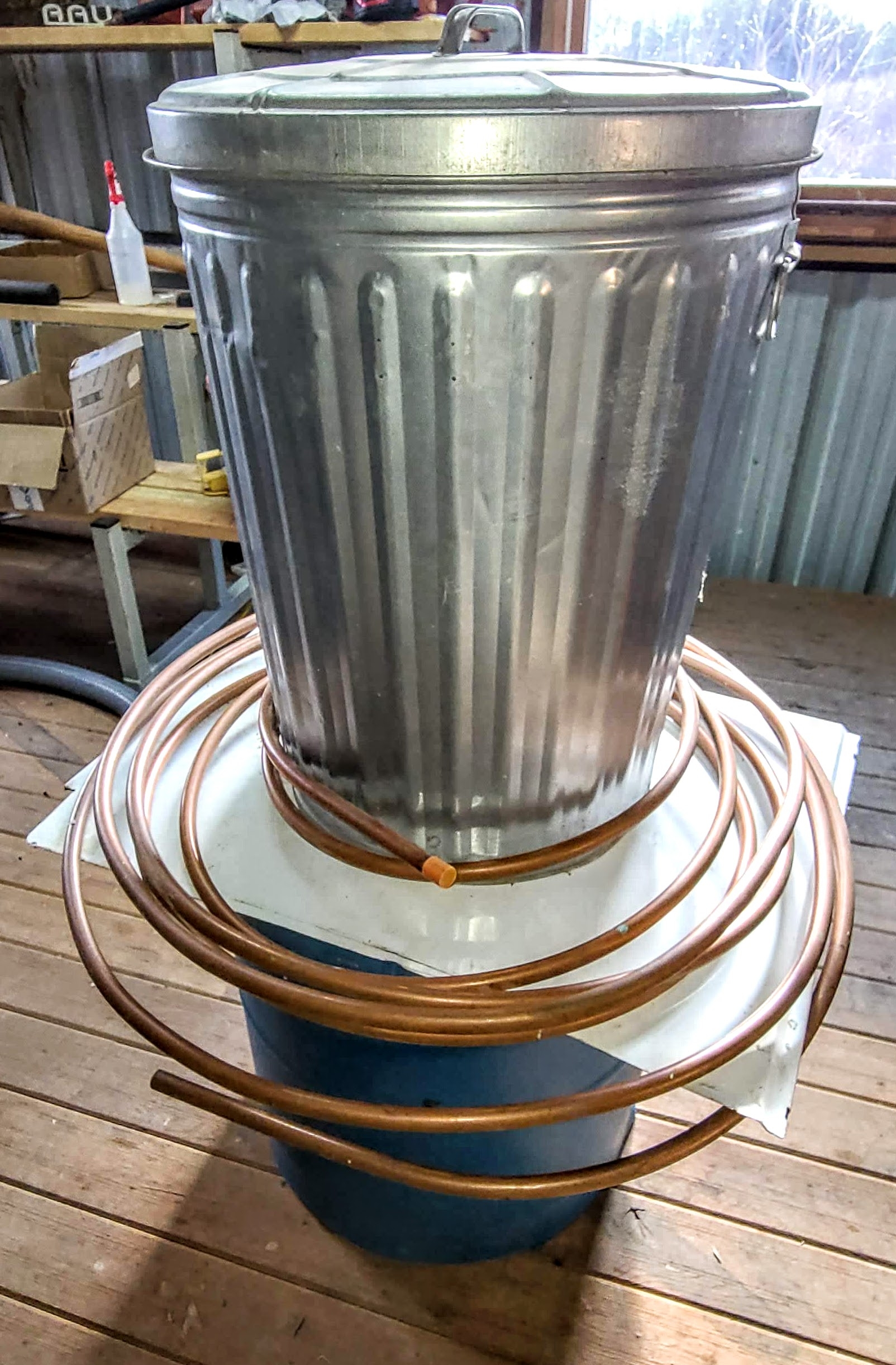

I used a trash can for a form to re-bend the copper tubing.
Then, the coil was strapped to some left over shelving steel.
I plan on trying 3/8" hydraulic hose to connect this coil to the compressor.
Where I am at now,, I am trying to decide if I need both coils, connected in series, or will this Next Gen 3/4" coil be enough??
Do you have any thoughts on compressor air cooling and what else should be included in this system??
