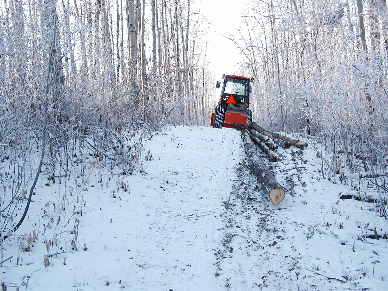

Turf tires aren't slicks, they have as much or more tread pattern to them as most off road pickup tires.
This is my third tractor with turfs, I like them for having pretty good traction on most surfaces and for not digging deep holes within the first couple of seconds of having less than adequate traction.
As far as turning my tractor into a mower, I would say that less than 10% of my tractor time involves the RFM. The rest of the time I am digging dirt or playing skidder or doing some other job that popular opinion might say turfs can't do.
Having said all that, tires that suit me perfectly might be the worst thing ever for others. Depends on soil type, snow type, terrain, how heavy or light the tractor and attachements is. You pretty well have to decide for yourself what will be best. The answer could be two sets of tires and wheels.
