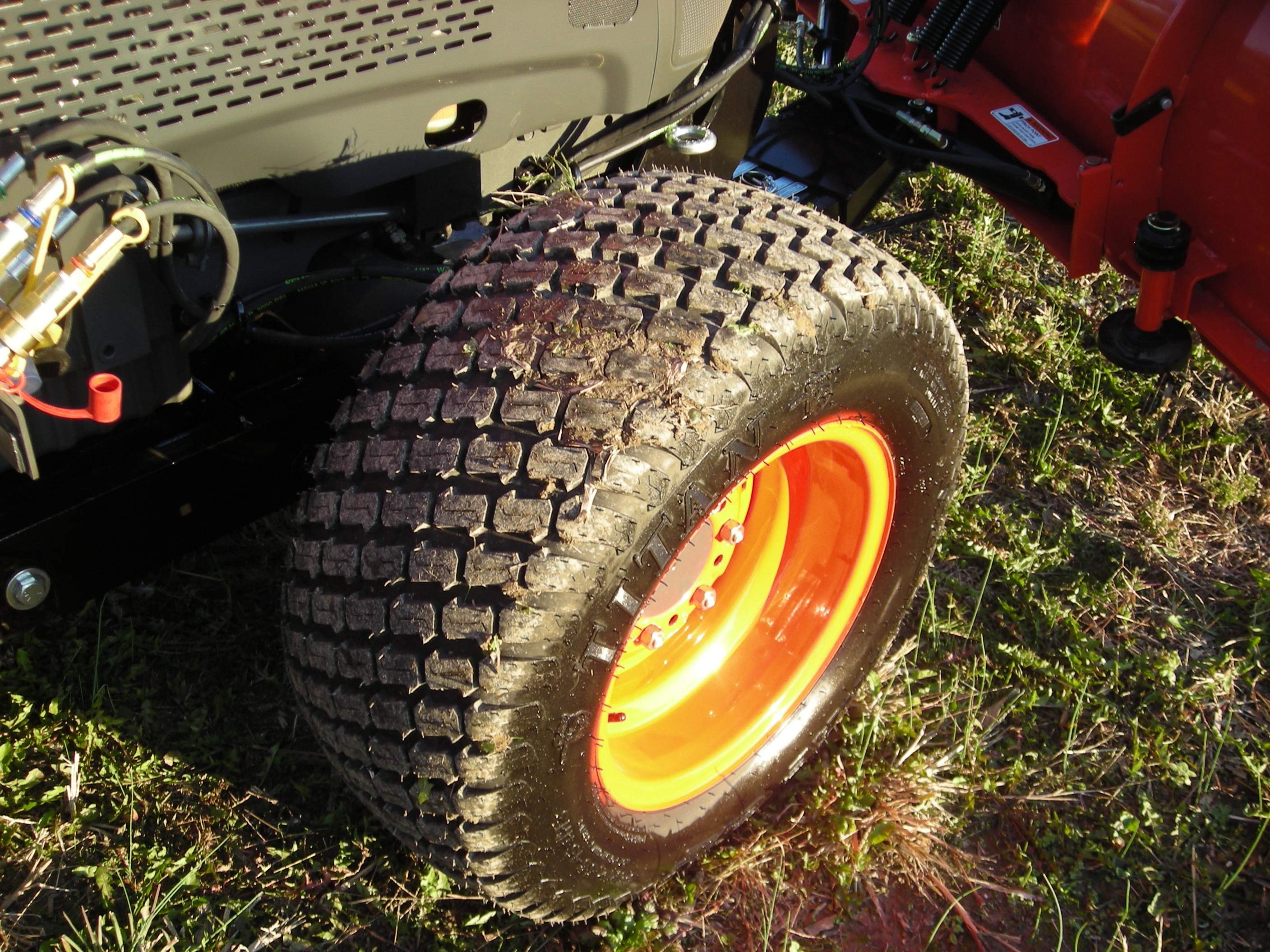

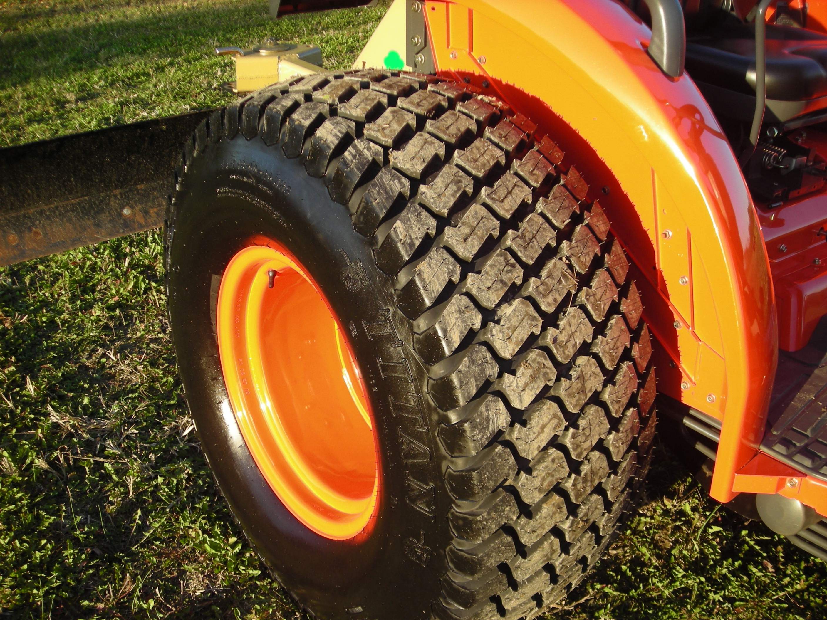

Here is pic of tractor with both blades and tires I was speaking of. Philip.
Your rear tires look to be the same as mine. Same tread pattern as the turfs on the B7610 that I had before but the lugs are about twice as deep. They hook up pretty well in most conditions.
I have seen photos of the galaxy turfs, looks like you could float across most anything with those but better not try pulling too much.

FYI, Kubota has 3 sets of turfs, standard, deluxe, and galaxy. The standard turfs are sub par. I have the deluxe, very aggressive and deep tread pattern. The galaxy are for golf course duty. If you see the grand L series brochure, they show the deluxe turfs in thier pictues. Philip.

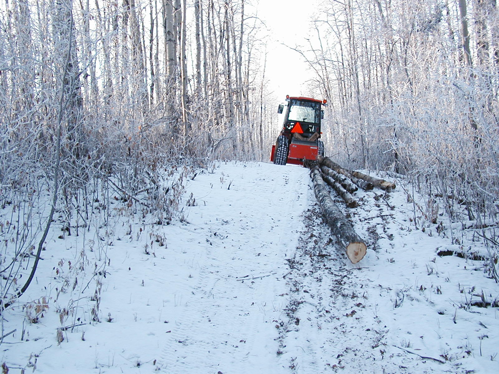

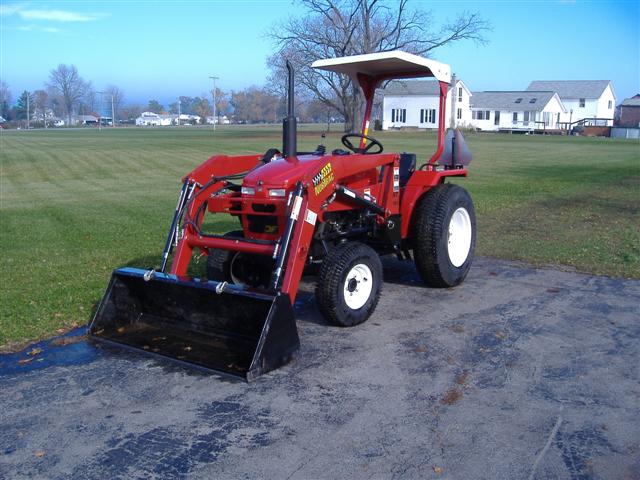

I have the R1 tires that my NorTrac 254 came with. I bought the Turf Tire set for it, at the same time. I can change them out in 30 minutes. Not a big issue. I find that the Turf Tires do a better all around job than the R1. I use my tractor to Mow the front 4 acres,plow the driveways, built a driveway, and logging firewood. Tilling the garden works better with the R1 than the Turfs. Open ground, R1 win hands down. I love the fact I got both sets. The only thing I can't coment on are R4tires. I've only used them on Skid Steers. That's a whole nother animal.
