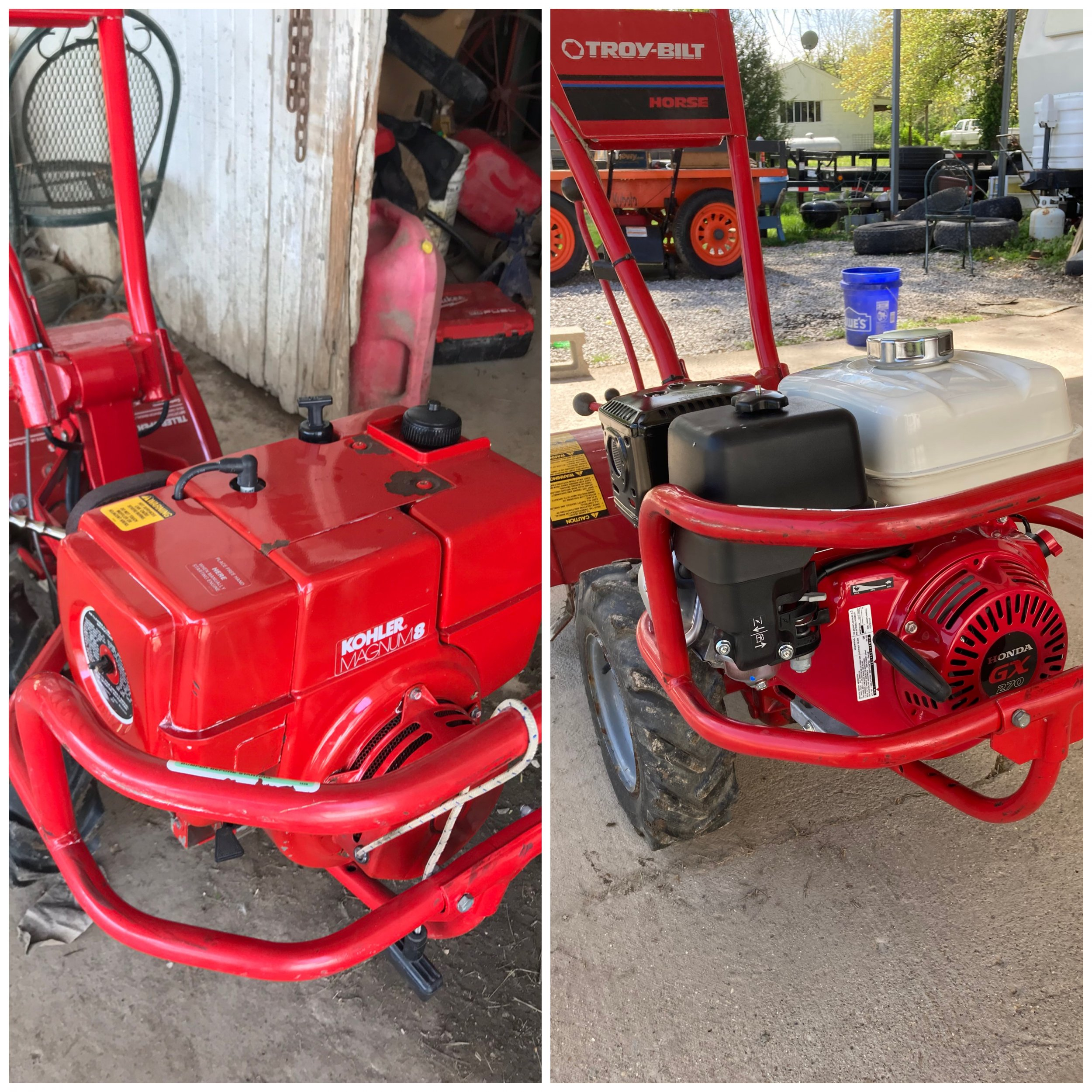

Good move. I've never had a complaint about my Kohlers, an 8HP on the tiller, a 12.5 on a TroyBilt/Simplicity mower/tractor, and a 25 Husky Suburban tractor. But we now know you can put a Honda on the Horse tiller - with added weight.
   / TroyBilt 8HP Horse Refurb #51
For sure. Just keep in mind not any Honda will work. Small Engine Warehouse makes a repower kit for the Horse. The crank is turned down to fit the top pulley. You might or might not need some shims to align both pulleys. Love those Honda engines
#52
For sure. Just keep in mind not any Honda will work. Small Engine Warehouse makes a repower kit for the Horse. The crank is turned down to fit the top pulley. You might or might not need some shims to align both pulleys. Love those Honda enginesView attachment 725141
Understood - but good to clarity for all. Nice comparison photos.
Looks like someone was yankin' on it...
Me, I'm a happy pooch with my electric starter working again.
