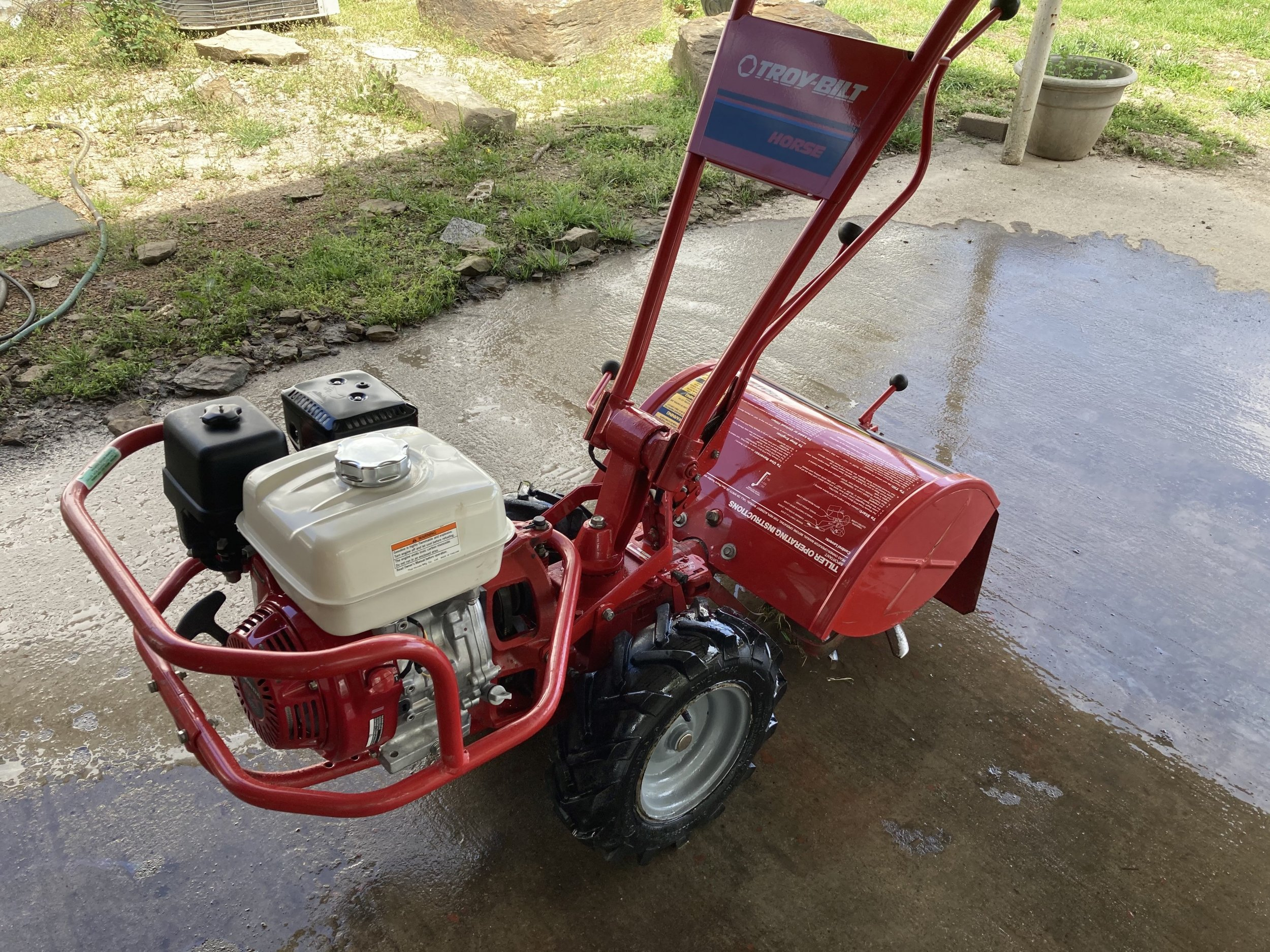

I bought a Horse tiller new in 1991. I’ve kept it clean and waxed and service ever since. Last year the 8 HP Kohler started kicking back when pulling the starter rope and before I found the coil to be the culprit it had ruined the recoil assembly. Well I was shocked to find these were obsolete and unavailable for a M8T Kohler. I bit the bullet and bought a Honda GX270 from small engine warehouse, they have a direct replacement engine available with the crank turned down. Replaced a axle seal and changed the gear oil. It’s ready for many more years. Love the Honda engine

Wow. Looks great - and I'm glad I'm not the only one who waxes a tiller.
Also: valuable info about the engine(s). Thanks. Yeah, Hondas are great.
/ TroyBilt 8HP Horse Refurb #9
Good looking.
How does that till and handle with the Honda engine? Does it feel lighter without the Koehler?

Yes, the aluminum block Honda needs a counterweight bolted to the bottom of the engine for proper balance. I added a 10 lb piece of steel. The 8 HP Briggs had a counter weight as well back in the day

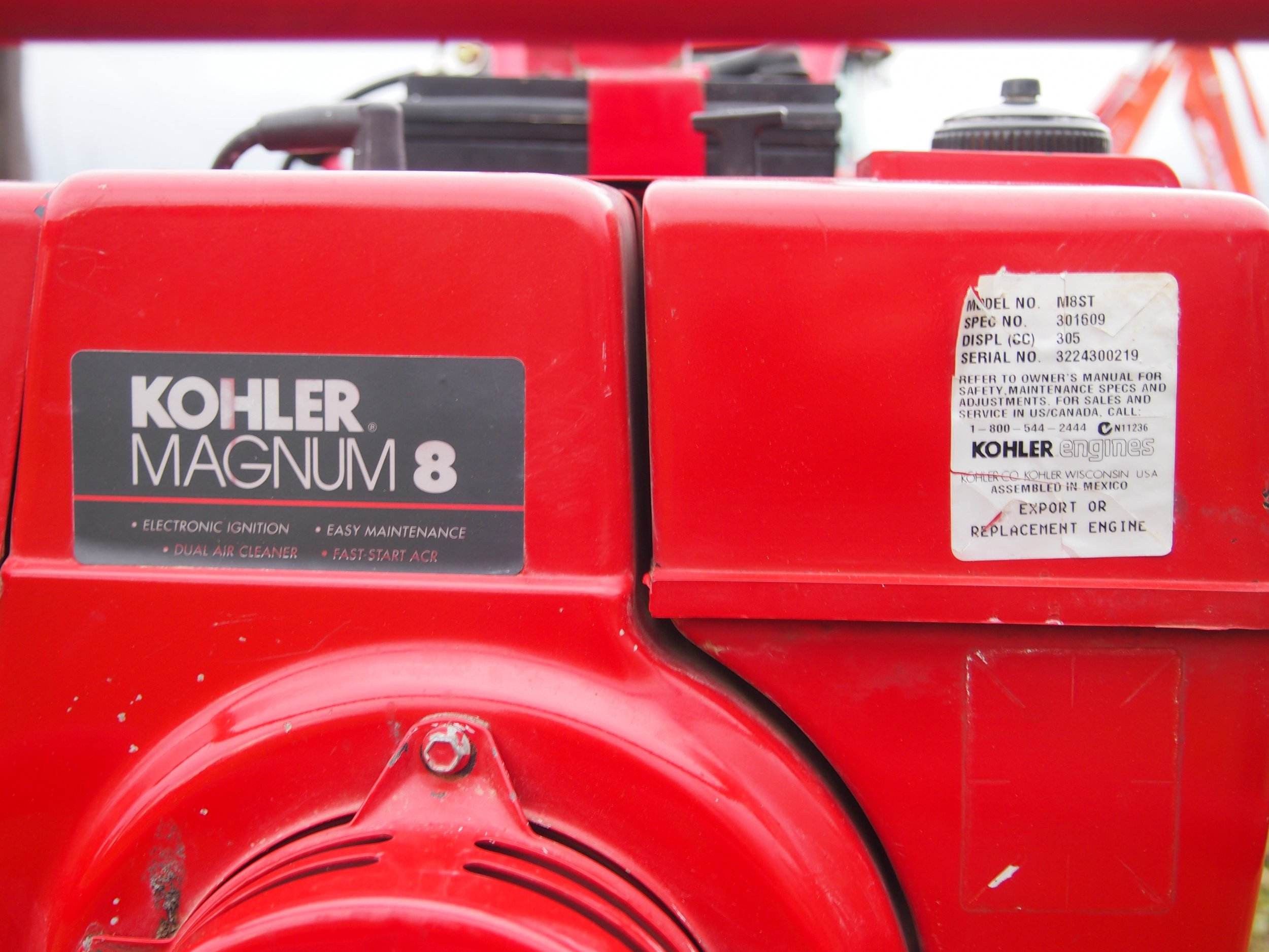

My neighbor had this unit and I bought it not running. Has a blade, and hiller attachment too. Hadn't ran in 8+ years so replaced fuel lines - cleaned carb all gunked up and starts now with a touch of the key. Tires still have ribbing in them - wasn't used much at all.
I like to find these older machines and bring them back to life, and this one went to my brother in law as he has a big garden he tends.
That is good info to know.
/ TroyBilt 8HP Horse Refurb #14
I tilled with it without the counter weight and it was ok until the dirt and mud builds up under the tine hood. Then it gets heavy to lift at the ends of the row. The Honda has as much power and maybe more than the old Kohler Magnum and much smoother
Yeah, that is definitely a good one.
