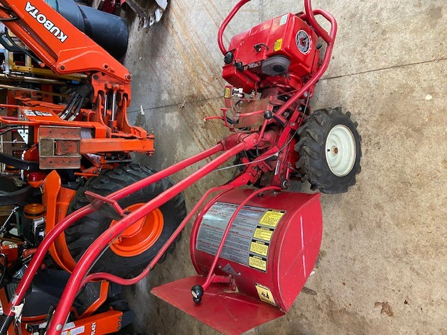

Throwing in another 2 cents here regarding the woodsplitter attachment, since I’ve used one for many years. If you have a Horse tiller with PTO and have this kind of work to do, I’d definitely recommend it if you could find one.
Given the previous ‘bedtime story’, I’d say transport is a bit of a two-sided coin. If you’re already at the job site, it’s cool because you can drive the splitter to various work locations – as long as you don’t have far to go and you’re not in a big hurry. I took advantage of this for years when I just had a pickup truck, and no tractor FEL or equivalent. But to move the whole unit, attached, would require a grid deck or flatbed trailer, and even then it might be dicey. I’ve never tried it, but I sure wouldn’t want to load it and unload it from a truck using ramps – especially since it’s 10 feet long from the wraparound bumper to the splitting knife.
All I’ve ever done is replace tires, hoses, the filter and fluid. (Owners manual specs have you use ATF, not hydraulic fluid.) The ball and spring detent that keeps the splitter piston in reverse, and then shuts off when it’s retracted all the way, stopped working long ago, and it was never important enough for me to take the valves apart or replace them. Still, after a long work session, I often wish it still worked since it keeps operator in a stooped position, holding the lever back. That’s my only complaint.
Reminds me of a dumb old joke – used by Stooges but probably from Vaudeville days. MAN: “Doctor, I have a weak back!” DOCTOR: “How long have you had this weak back?” MAN: “Oh, about a week back…"
Not sure if it was ever funny. I know that if you have one, it’s not.
