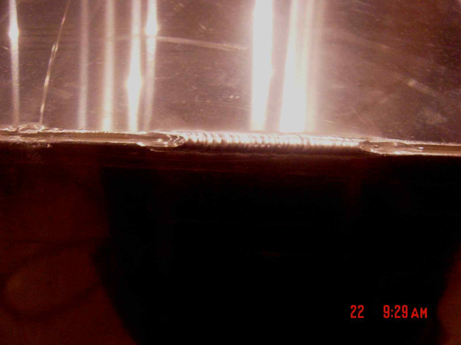

What are the tricks to getting good tie in down in inside corners with stick mainly 7018? I struggle with this it ends up being a big blob or having slag inclusions most of the time.

I like to use a die grinder with a 1/16-inch thick disk to feather my starts and stops of a weld. Makes for easy tie ins.

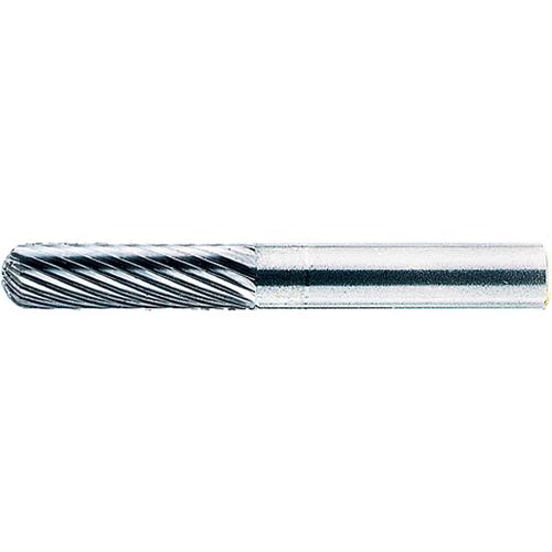

Sometimes you have to use a roto burr in a die grinder.
That's exactly what I ended up doing I was wondering if I was doing something wrong.

That's the only tool my die grinder has ever seen. That exact one.
/ Tricks to getting good tie in #10
Works excellent for getting slag out of deep grooves on the first pass too.
I use a 1/4" ball tip. Easier to control and almost always it can do all you need.
