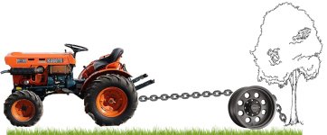

The rim is the outer part of the wheel which basically retains the tire on the wheel ... I'm picking at you a little bit but now days so many people talk "Rim equals Wheel" which is not true since the rim is a part of the wheel assembly!
Got you. So it would be like saying don't give me any rim instead of lip? Right? Guess that makes sense for I do remember "split" rims. kt

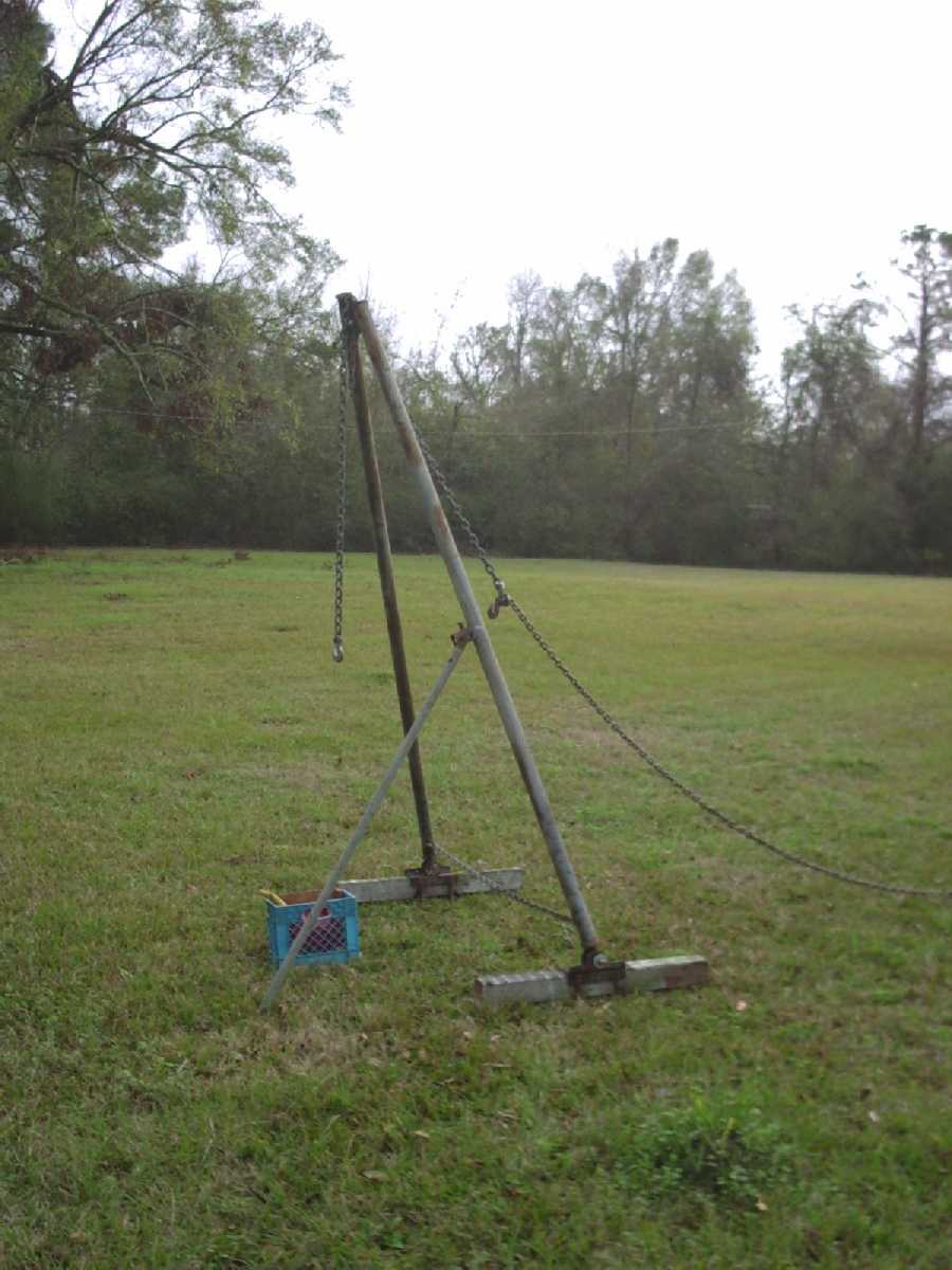

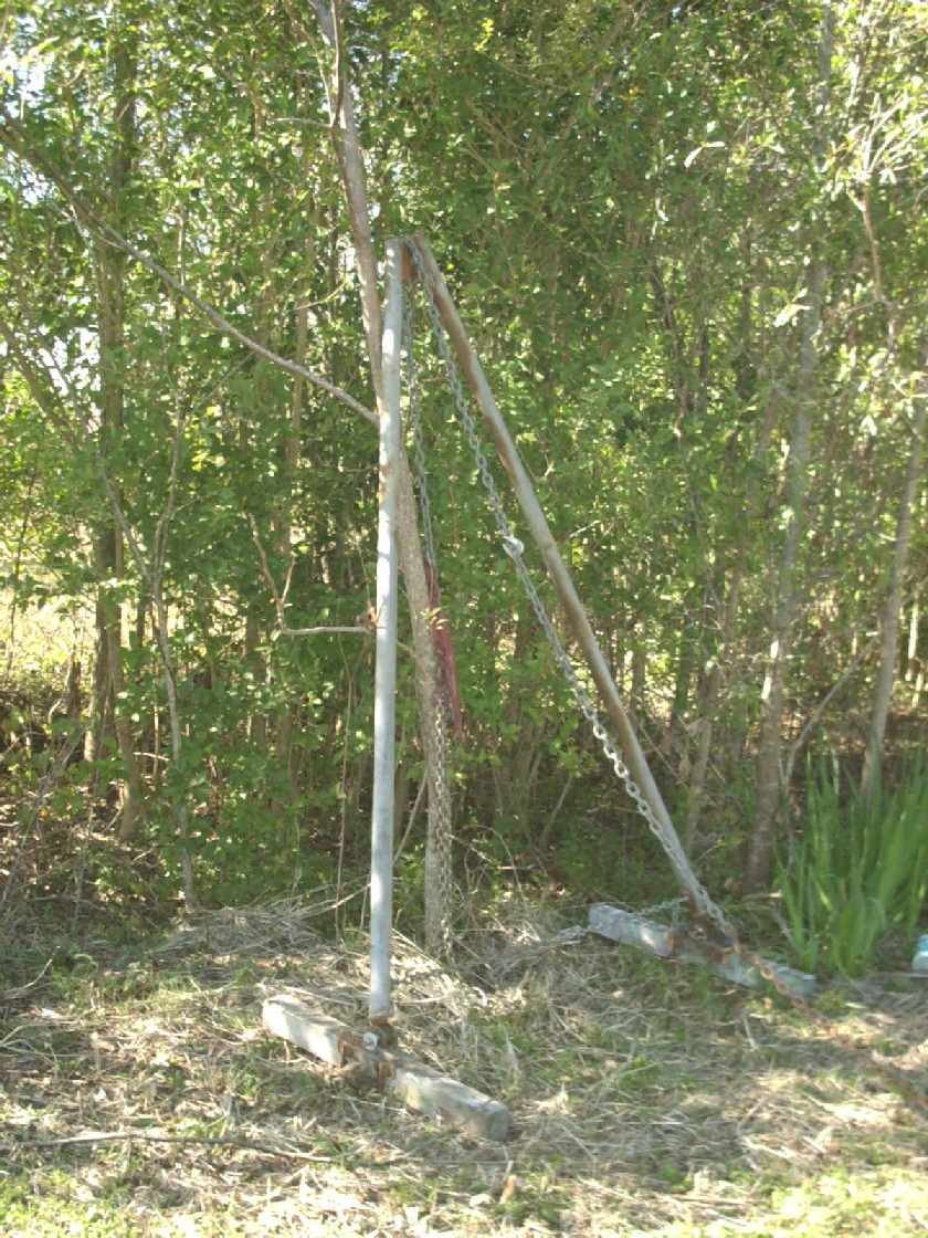

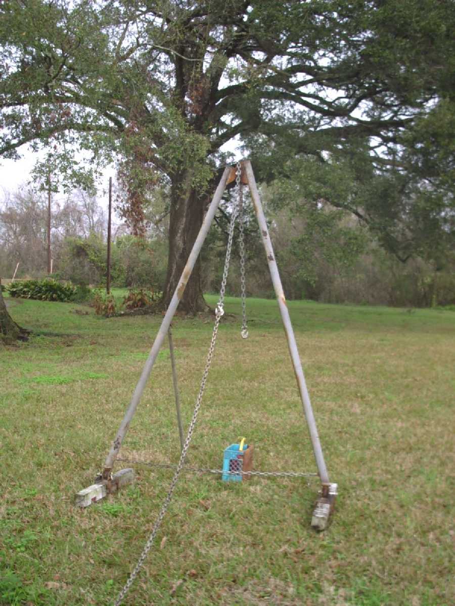

dag nabbit, just gotta ad this...
the pull line from tractor to top of "Sherweld Bipod" has a 1:1 pull ratio...
the lift line (chain / vertical lift) will bear the burden of the lift Advantage Ratio (1:4 burden as per drawing). If a chain is to fail, it will be the one from the top of the "Sherweld Bipod" to the base of the object being lifted. Backlash towards the tractor operator will / would be minimal. Stay clear of the lift area during lift operations.
EDIT : DO NOT USE ROPE FOR THIS APPLICATION, IT DOES STRETCH AND COULD / WILL HARM THE TRACTOR OPERATOR !!!
Good Luck
Be Safe
Rhett

...or you can use an old axle WITH rims and tires, wrap the chain around the axle 1 1/4 times, get it as close to the tree as possible before starting the pull.

This is very interesting and a great idea. I have a bunch of gum trees in my field/foodplot that are to big to push over with the FEL. I have trired this method before and most of the larger ones just broke off. My thought in building one of these gizmos, would be to use a steel beam for the pole and weld a base to extend a foot or so to both sides for stability. At the top of the post how about a slit or notch to set the chain. It would be easy to them adjust or readjust the chain as the tree lifts.

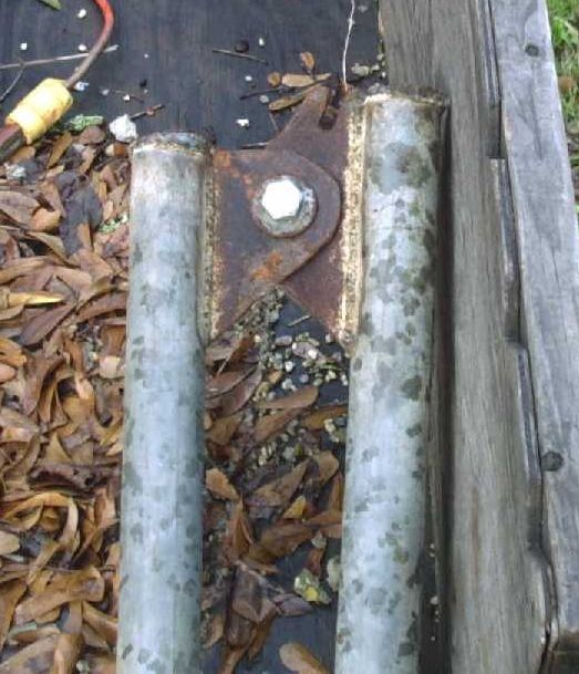

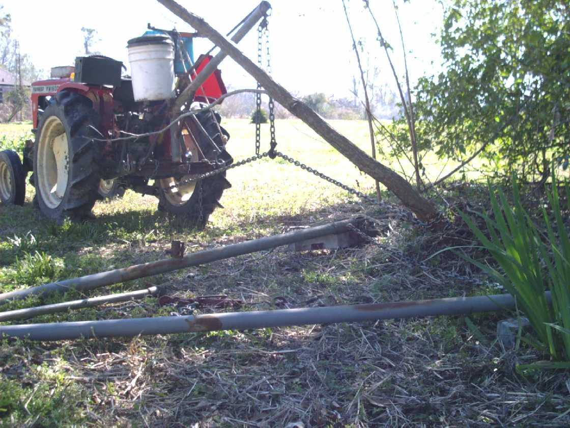

keeping this great idea alive !
will post action pix if it ever dries up.

the chain over rim is not rigid, so no mechanical advantage.
Rhett
Well sort-of and No. With the rim placed right up against the tree, there is a 2 to 1 advantage. This is derived from the fact that the radius of the rim (distance from fulcrum to tree) is 1/2 the diameter of the rim, which in fact serves as the larger lever arm. It really functions exactly the same as the bipod, until it moves away from the tree. The farther it moves, the less advantage there is. All bets would be off if the wheel was turning about it's hub axis, as if it was a huge fixed pulley, but it is not.
agreed, except that.
if pull chain is draped over the rim, the rim is acting as a large pulley, no advantage due too the chain not being fixed to define fulcrum.
if pull chain has a full wrap around rim (as others have suggested), then yes I see an advantage because a fulcrum is defined.

   / Tree Puller for hard to get at trees #57

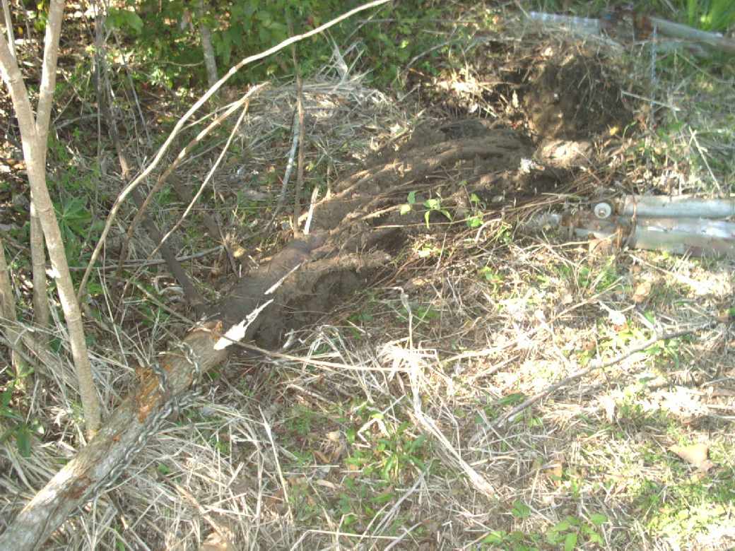

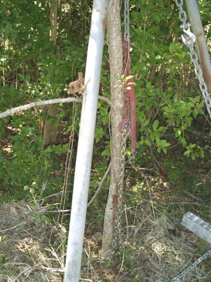

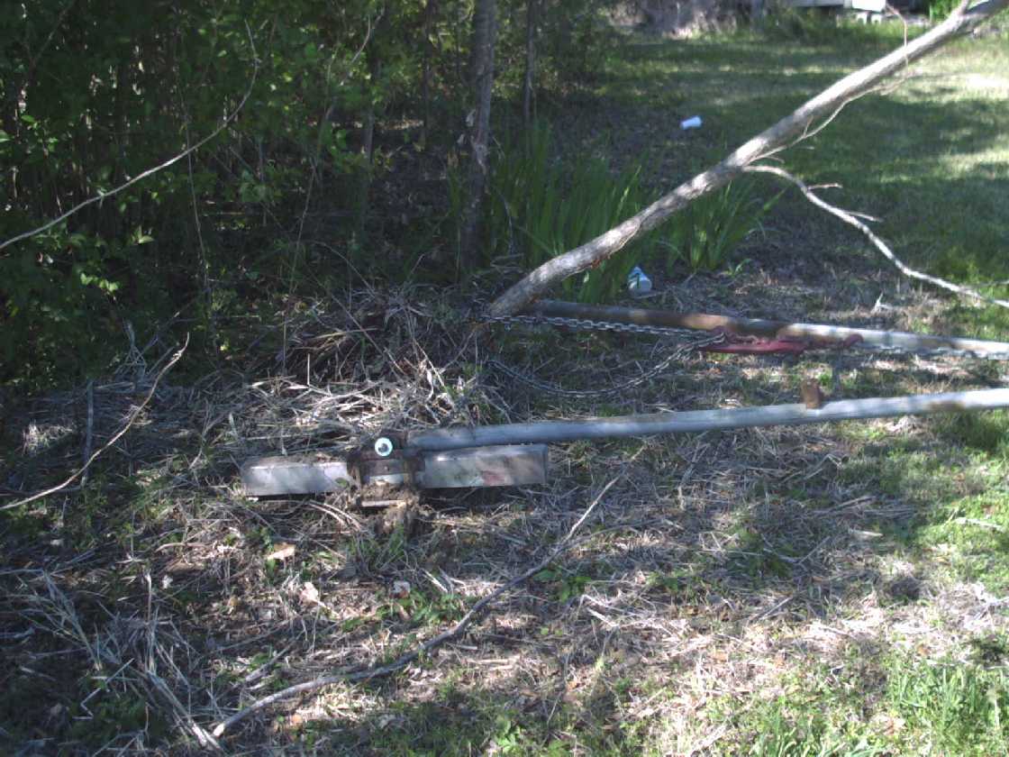

dang wedge40, i guess late is better than never.
my little cut strains but it worked, a full size tractor would be ideal.
check out the Tap Root in pix 5
