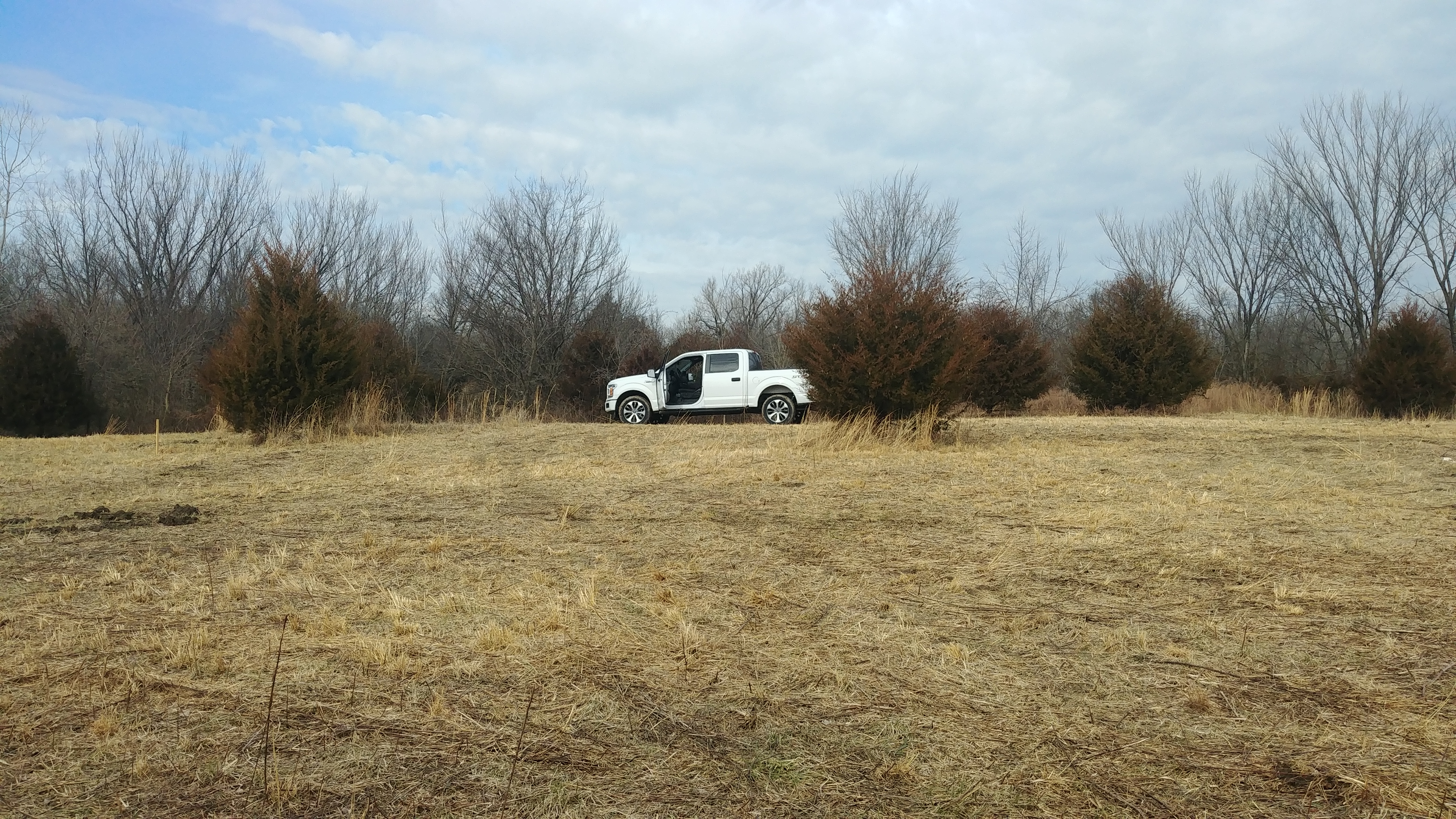

You mentioned railroad ballast rock for driveway base? If it's what I think it is I would not use it. It doesn't create a solid base. It continually moves. That's by design. It's intended to move every time the train rolls over it, always working it's way under the ties. I've saw it tried several times, always with poor results. Maybe if you laid it, then put crushed AG lime on it to stick it together?? By the time you do that you might as well buy 2" or 3" limestone gravel.

We don't border any wildlife area, the majority of the mined land in Kansas is owned by the state now though. I was just pointing out that it's fairly rare to have access to a strip pit and I haven't seen many houses along them. The land just isn't available.

Railroad ballast may be a poor choice of wording, I'm thinking that 4inch limestone as a base. Topped later with 3/4 minus. The soil has a fairly high clay content and the 4 inch should lock into it pretty good. I'm willing to listed to other ideas though. Including ditching the post frame idea. We know we want that floor plan and size of building and we want standing seam metal roof. The rest is up for discussion. We don't have the cash for a complete build right now, so we will be doing it in steps. Don't worry, I make plenty and it shouldn't be a cause for concern. I have other money I can get to if I need to.
