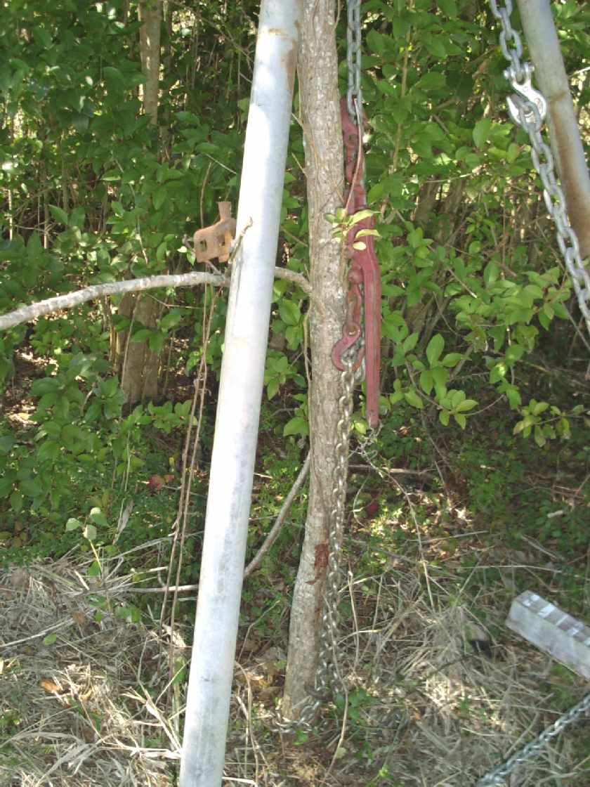

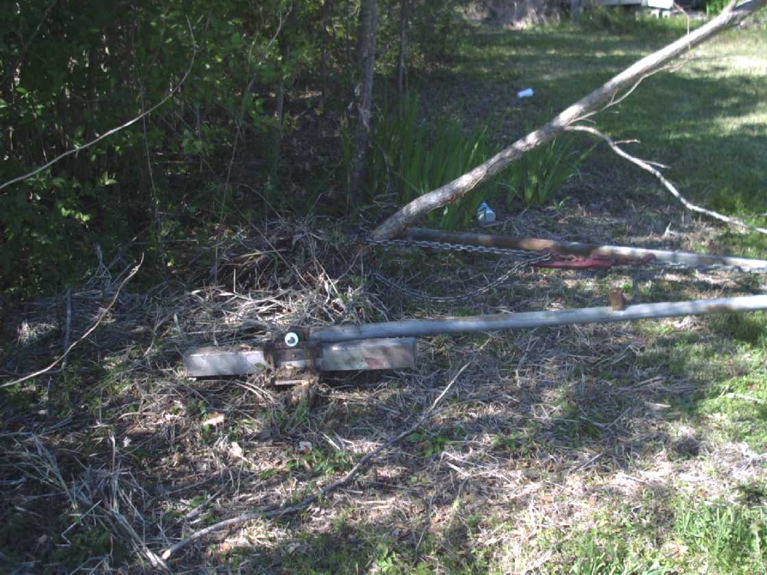

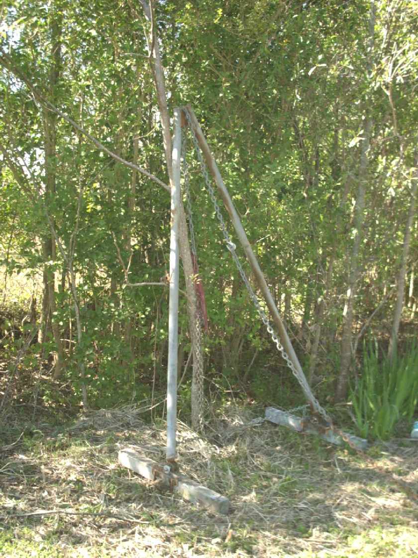

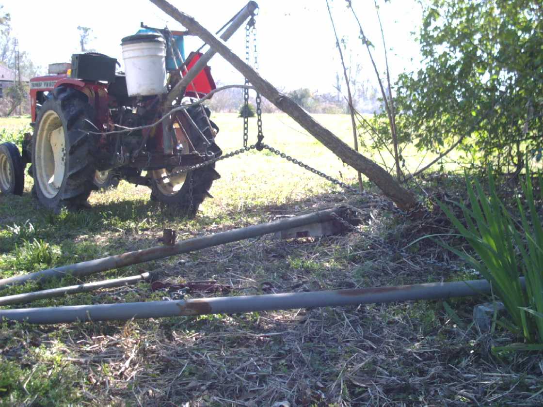

Here is what I came up with:
Remember, I just used what I had on hand so the pipe was rusty and I didn't take time to clean up the areas I was welding. I just used some 6011 to burn through. Not the prettiest welds I've done by far, but functional and will hold up; I'd put money on it. :laughing:
And here is what I finished up this evening.
Originally, I just cut a slit in the top of the pipe and inserted a piece of flat with the notch cut in the top. I then heated the pipe, beat it down against the plate and welded it in place. I looked at that and thought the strain might fold the plate over so I added a piece of 3/4 inch rod to each side.
The base is 5 feet wide and the upright is 6.5 feet. Hopefully, I can try it out this weekend. Unfortunately, other things keep coming up.

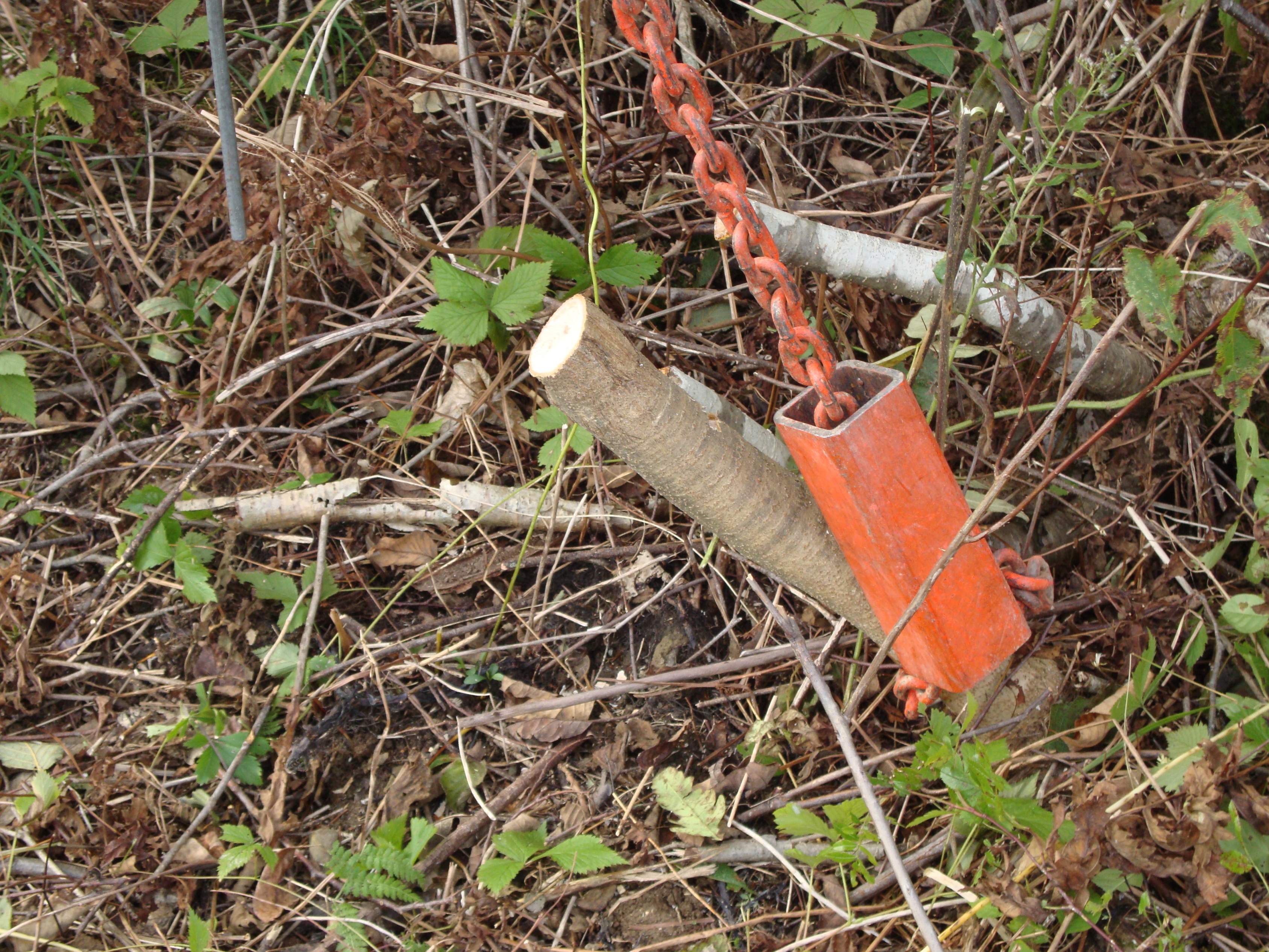

I like the choker idea. It took me a while to see it too. OpenOffice.org - The Free and Open Productivity Suite includes a draw program. Chain is hard to draw. Does this fit your description?
quote] Brad, That's it exactly! Also nice drawing, better than I was able to do. Mike
Shouldn't the pipe be reversed on the pull chain? I thought the point of this sliding pipe was to get the rim of the pipe sucked into the tree as the chain was pulled tight. In this drawing the pipe would be folded as the chain was pulled, and the smooth side (instead of the open rim) would be against the tree. That seems like it would provide less grip than using a chain wrapped around the tree without the pipe at all.

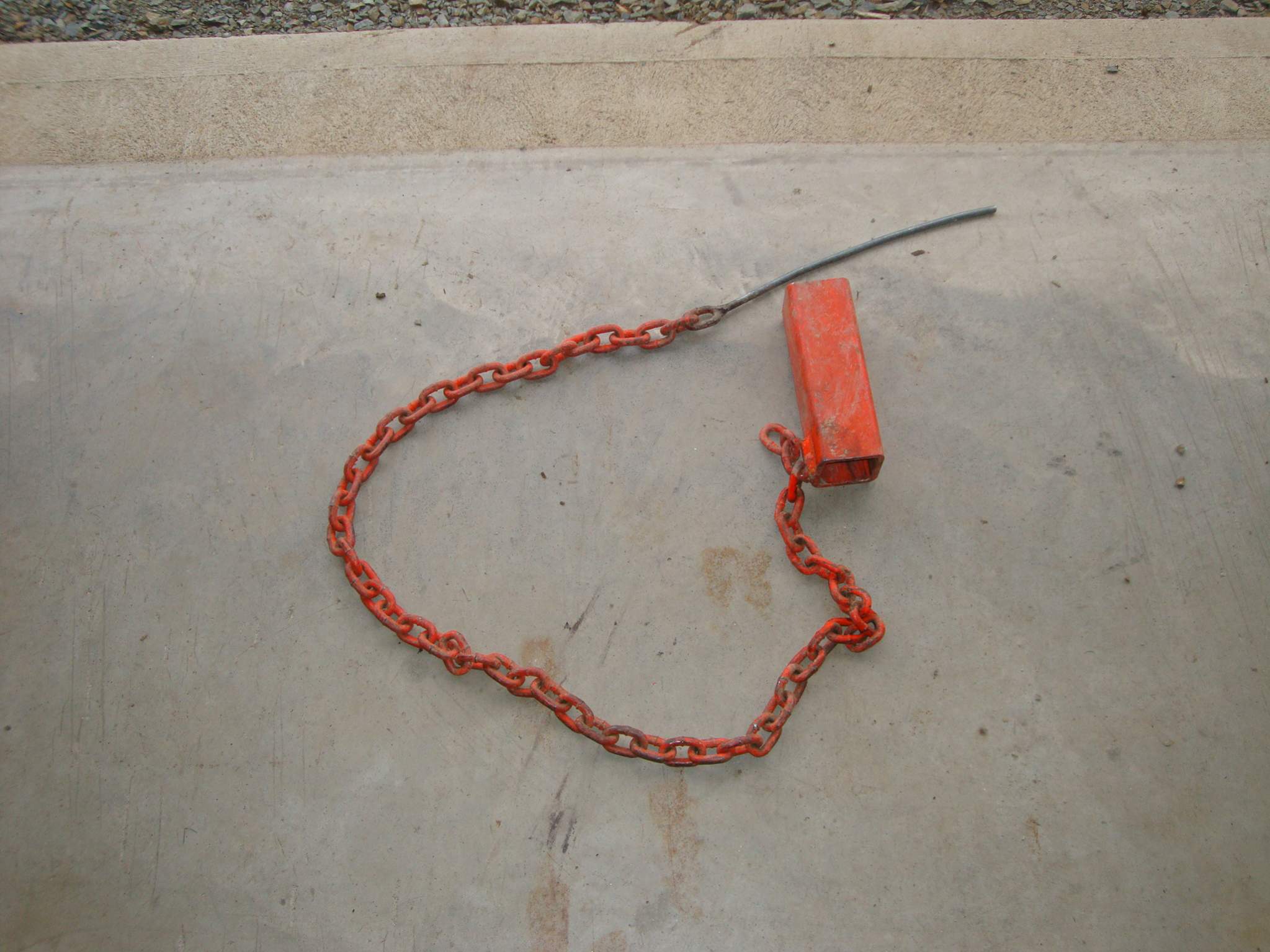

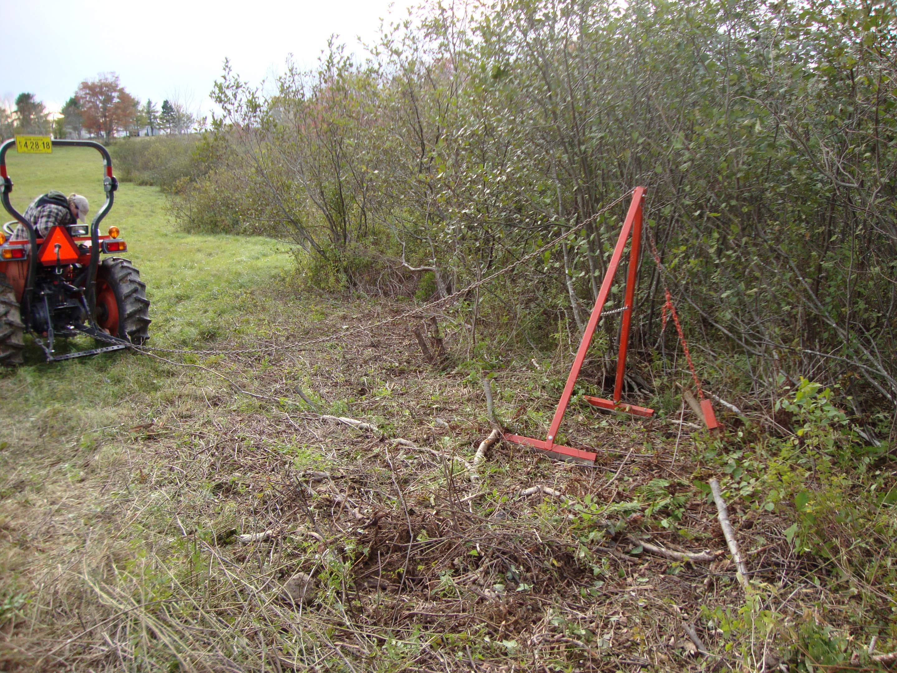

I built an A-frame for hauling small trees out, it works quite well. Gets tiring moving it around though.
The choker attachment works well, rarely slips off.
