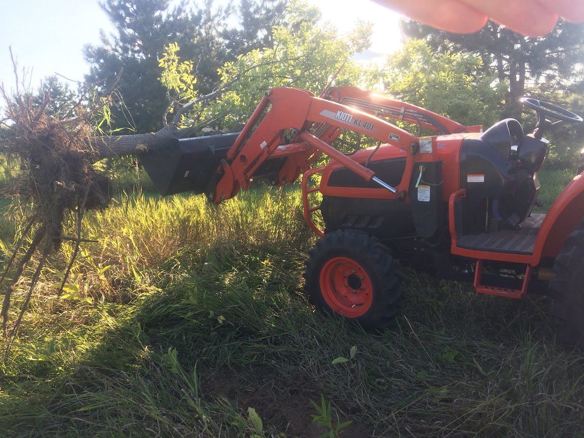

I've got a number of scrub oak that I need to clear out of an area, and I'd prefer to yank them out rather than just cut them short as they sprout suckers madly and I prefer to avoid poisons.
I've managed to pull out smaller specimens with my tractor using a chain - up to a few inches in diameter - but when they get bigger than this it's not doable, as these scrub oak have crazy strong roots. these aren't anything like a pine tree, which while it's got a tap root there's not a lot else and they come out readily just being pushed over (besides, cutting those is permanent)
I've seen people use an old wheel so that there's an initial upwards pull, and I have questions before trying to find a reasonable wheel for this -
1 - I'm guessing the bigger the wheel, the better? I tried using a piece of steel I-beam I had, but it was too unstable and fell over to the side before I could get enough tension on it (working solo) to have it do any good
2 - has anyone had luck with this wheel method pulling scrub oak or something with similarly obnoxious roots?
There's way too many of them to dig out with the backhoe.

Pulled a couple smaller trees with the contraption the other day.
There's not a chance of breaking even my 5/16" chain here, my traction was so bad (R4 tires on hard-pack dirt lol).
I have no idea who welded the triangle originally (may have been me ages ago) but one of the welds broken off, cold weld with no penetration. Will fix that.
Also going to weld a chain hook on top as the gold chain is a pain to loop around enough to get it short enough to hook back to itself.
Finally, future tries I'll cut the tree first so that I can position the tripod such that I'm not wasting as much pull getting the initial tension (besides reducing the lift weight, though that's minor compared to the strength of the roots).
